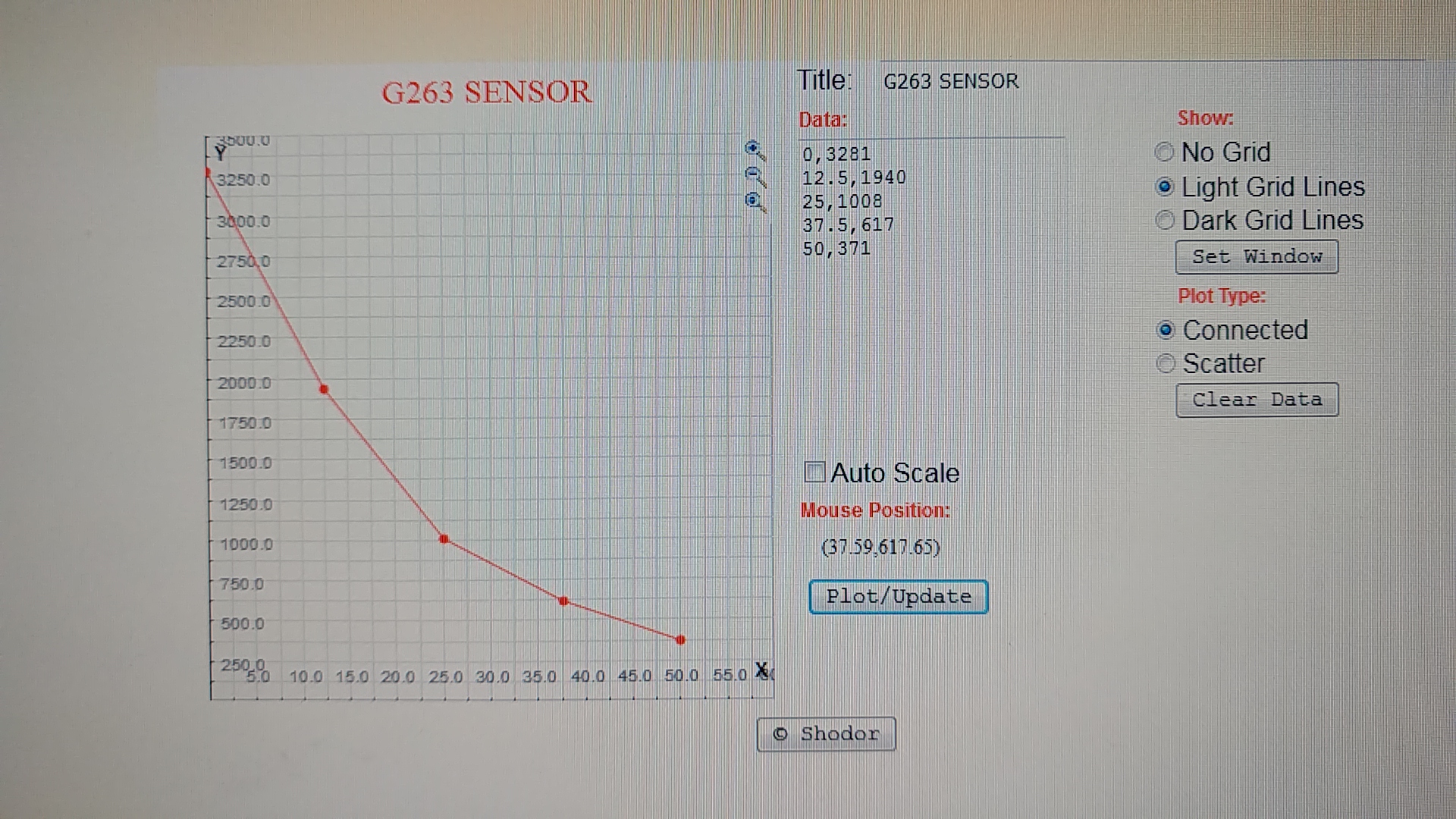

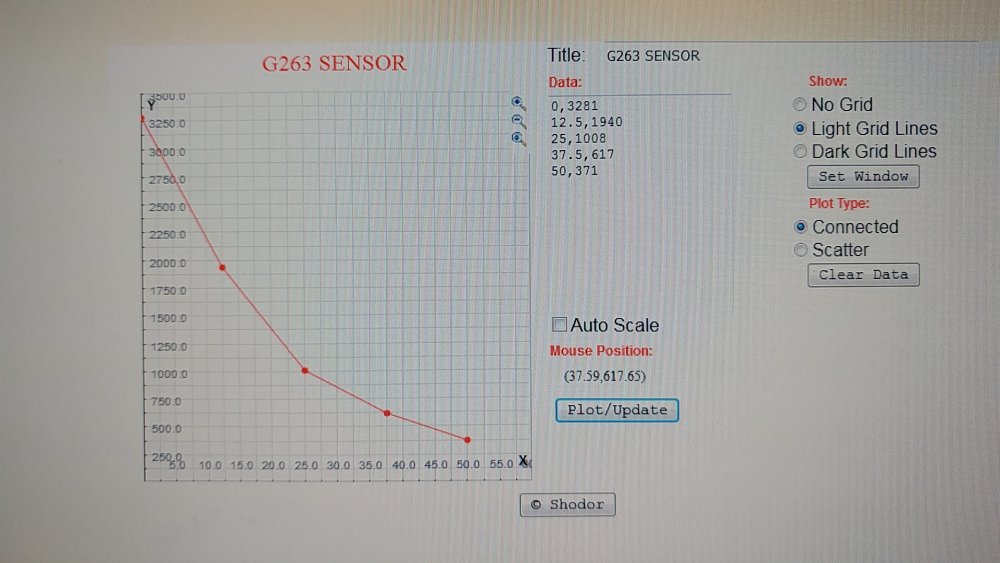

  • My new G263 arrived today, at last! I compared resistances at various temperatures and found my old sensor drifted at all ranges but especially so at low temps. Hence the Climatronic didn't know the e
  • The G263 is a real pain to get to apparently, tucked up deep in the dash. I'll have a look at removal next weekend.
My new G263 arrived today, at last! I compared resistances at various temperatures and found my old sensor drifted at all ranges but especially so at low temps. Hence the Climatronic didn't know the evaporator was freezing. Sod's law dictates that the evap sensor is a different type to the others. Attached is a quick chart so anyone can measure the G263 and decide whether it's going pear shaped. Proof of the pudding will be a longish journey this weekend.

^ Great work there. May just have to compare those with a G263 from a Mk1 Fabia/9N Polo to see if they conform or not.  The physical form is very different but that is just a packaging/access issue.

I think there's been a variety thermistor types used for this sensor. That graph I extrapolated from a post on an Audi forum, but it does closely match my new sensor.
