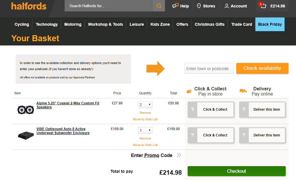

typically stock speakers are crappy paper ones. You could upgrade to any branded speaker JBL/alpine etc and it would be an improvement. i wouldnt bother with canton for the price. You could take it into any ICE centre and get fronts, tweeters and rears and a pancake sub fitted for a fraction of the cost of getting a dealer to upgrade you to a canton. access to the front/rear speakers isnt difficult and its just a matter of 4 screws and two crimped connectors.

just out of interest... you wont need a separate amp with this as its plug and play, and just access to the rear of the unit to connect the sub, the rest is just unscrew and replace. This is bargain basment option by the way. If you want to get really good sounds you would need to go the route of a separate amps, two ways, etc.
Wait, you're saying you don't need an Amp for your subs? How does this work? I put a huge sub in my old golf and that required a seperate amp.

 most of the underseat subs have built in AMPs otherwise if your putting one in the boot buy a sub with a built in amp and do the extra wiring.

 not for an 8 inch 300W sub, No. your head units built in amp should handle it but check the specs incase.  AFAIK most of the underseat subs have built in AMPs otherwise if your putting one in the boot buy a sub with a built in amp and do the extra wiring.

personal opinion: Avoid Vibe. Avoid Halfords, talk to a specialist.

totally agree with the avoid halfords statement. Find your local ICE professional installer/shop and work to a budget with them. Halfords are amateurs and wont stand by their work
agree avoid Halfords!
don't agree with avoid vibe - always used their subs and amps and never had an issue
Hertz speakers are decent. With the skoda units they struggle with aftermarket speakers without separate amps
