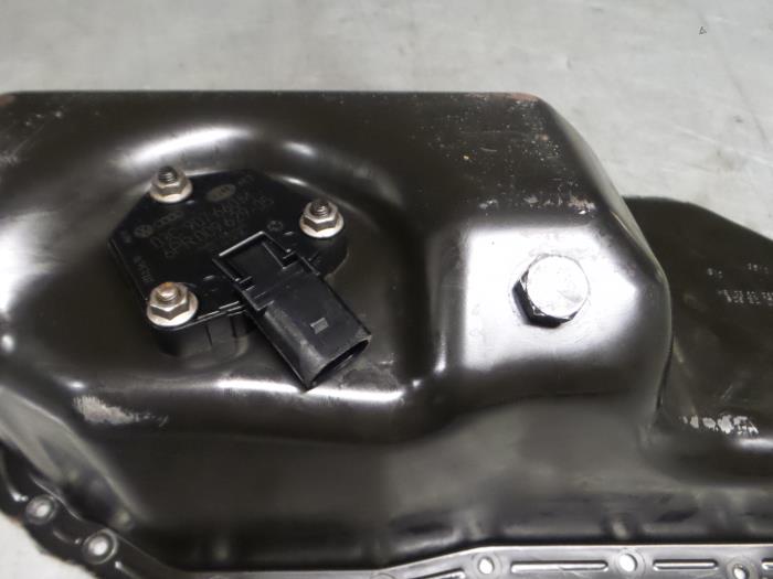

Clearly visible on both our 1.2 tsi engines. Ive seen them other tsi engines as I am a diy servicer. Heres some pics.
Yes that is the sensor for oil temperature and level. I have seen no reference to the type of sensor you mention in any Skoda technical documentation. Granted, they have a similar shape, but that doesn't mean it is the Bosch "under development" sensor you linked to. Browsing VCDS, I have seen no parameters relating to the esoteric things. The only relevant parameter seems to be something called "thermal load" which relates to the oil temperature vs driving conditions.
Edited by nicknorman
