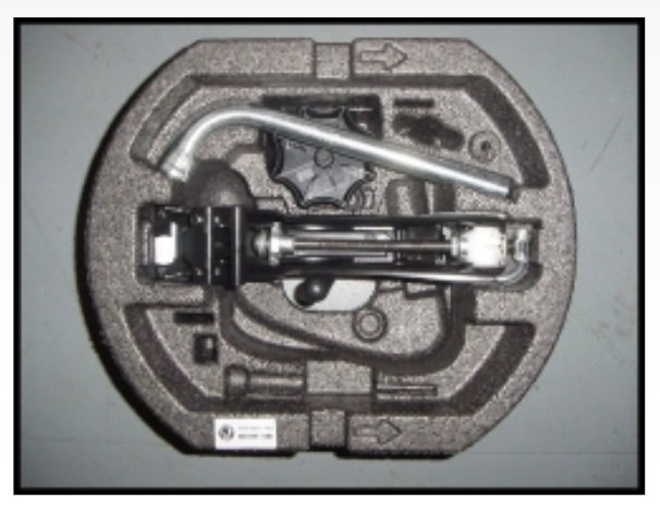

Can anyone tell me which kit is correct for Octavia Elengance MK3??
5a269de7062f4_ScreenShot2017-12-05at13_16_59.png.3b3bdc07fec6a49dbc717d31ed50ef10.png5a269deee8832_ScreenShot2017-12-05at13_09_02.png.7a03004a5d78165976d6d1f9d5e974bb.png
The top pic looks like the kit in my wife's Fabia and the bottom kit looks like what I have in my vrs

a proper octavia kit to fit a steelie should look like this...
i just chopped it to fit
The top kit is from www.skodaparts.com and the jack looks right to me, the lower one is from Ebay and the whole kit looks cheap but the jack doesn't look right. Price wise the Ebay one is free postage but same price as Skodaparts. I am not keen on driving around with no spare and would rather carry the weight, problem with second hand cars is we have no choice on whats with then so gotta sort it later. JohnnyType2, where did you get the wheel, it looks brand new???

colin, thats the official skoda branded OEM wheel kit bought from Skoda. it is around £50 MMRP but most dealers are doing it now for £38ish
those two images are of the same OEM wheel kit, not an ebay knock off :blink: ...its the same jack just upside down

If you do go with the alloy you will need to butcher the foam of the skoda SWKit to get it to fit, the good thing is that is comes with the fixing to screw it to the wheel well base.
