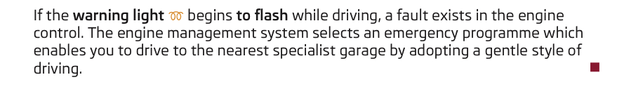

just came round a roundabout which then goes up a hill and noticed no response from the throttle then seen the glow plug light flashing. Car didn’t seem to go much faster than 30 ( limp mode ?? Never had car before with one). Made it home about 1.5 miles. Knocked car off, left it a short while and then restarted but no flashing light so went for a short drive and it was fine.
Anything to worrie about ???

As mentioned you should get the fault code read, the flashing EML light almost always logs a fault code.
Once you have the code you can check it out here...
http://wiki.ross-tech.com/wiki/index.php/Category:Fault_Codes
Almost all limp-home mode actuations are sensor, turbo or EGR related.

Ohh i ‘ve had the same glow plug flashing just today. Same emergency mode with less power , no strange noise from the engine.
After restart it is okey for a while then coming again.
I also saw a lot of entries about brake pedal switch error, could it be also for superb? (I forgot to check the brake lights)
Based on the manual, it shouldnt...
Edited by Juhagpl
The brake light switch is a common fault with the glow plug light flashing... however ONLY if it has not gone into limp mode.
