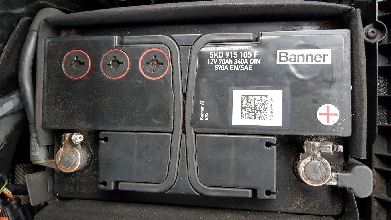

This is the battery my car came with when I bought it a year ago. No idea if it has been replaced or not. It is properly coded.
Very similar to my 2011 Elegance 170 estate, yours appears larger capacity
Battery banner 5KO 915 105 F
70ah 340a din 570a en/sae
Mine takes longer to fire up as it has keyless I hold the button longer for it to fire up. Maybe a sign of it not being strong enough. Plus I have heated front screen and seats, plus auto lights. Plenty to suck the power out.
The part number on that battery is a VAG OEM one and Banner was/is an OEM supplier.
I suspect that it has been changed as it has a 72AH rating - as far as I know, there were a lot of 2011 Superb diesels (2.0 as well as 1.6) that were supplied with only 61AH. Superb owners were more than a bit peeved when batteries gave up after 2 years and they found that Passats/VW's of the same era and same motor had gotten 72AH ones.
The cranking amps on your current one is higher - 640 - than the 61ah battery (that was 540 I think). Us diesel owners like our cranking amps, we need them to turn the motor over properly at ignition time.
I think it's reasonable to assume that you are on your second battery and it was fitted by a dealer.

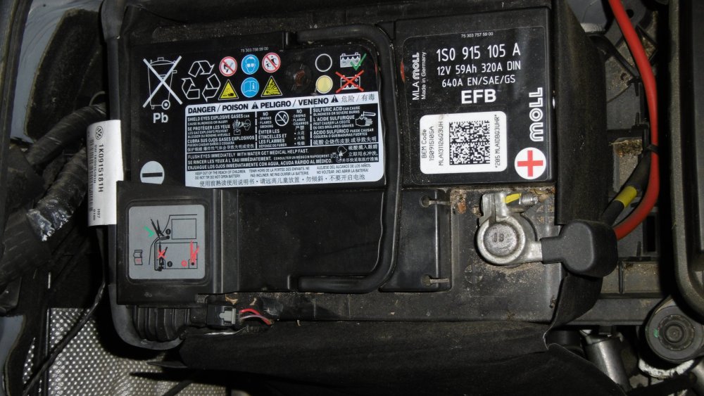

I think when Stop/Start became an item on cars like the Greenline, they didn't use AGM and used ECM (enhanced batteries that could handle more frequent charging cycles). Do you think your battery  might be one of those? I'm not sure how you tell.....
Looking at mine don't think it's AGM - poto attached:-             [EDIT] Just realised EFB = Enhanced Flooded Battery
Edited by bigjohn
7 hours ago, TheRobinK said:
Penny pinching is certainly possible on the batteries - Skoda has form for that. It could be that a previous owner was not willing to pay the extra for the AGM battery.
There is no indication of it being anything other than the most common flooded lead-acid battery. Stop-start maybe stops the engine once a month when it's warm and starts it back up after about 10 seconds nearly every time it has occurred. I have not looked for signs of tampering with the stop-start system, but I'd rather not have it work anyway, at least not on this battery. As of now, the car has not struggled to start, not even in cold winter mornings.
These days battery manufacturers commonly have an AGM battery series, an EFB battery series and several flavors of lead-acid batteries. AGM and EFB batteries are specified as stop-start batteries, the rest are not.
