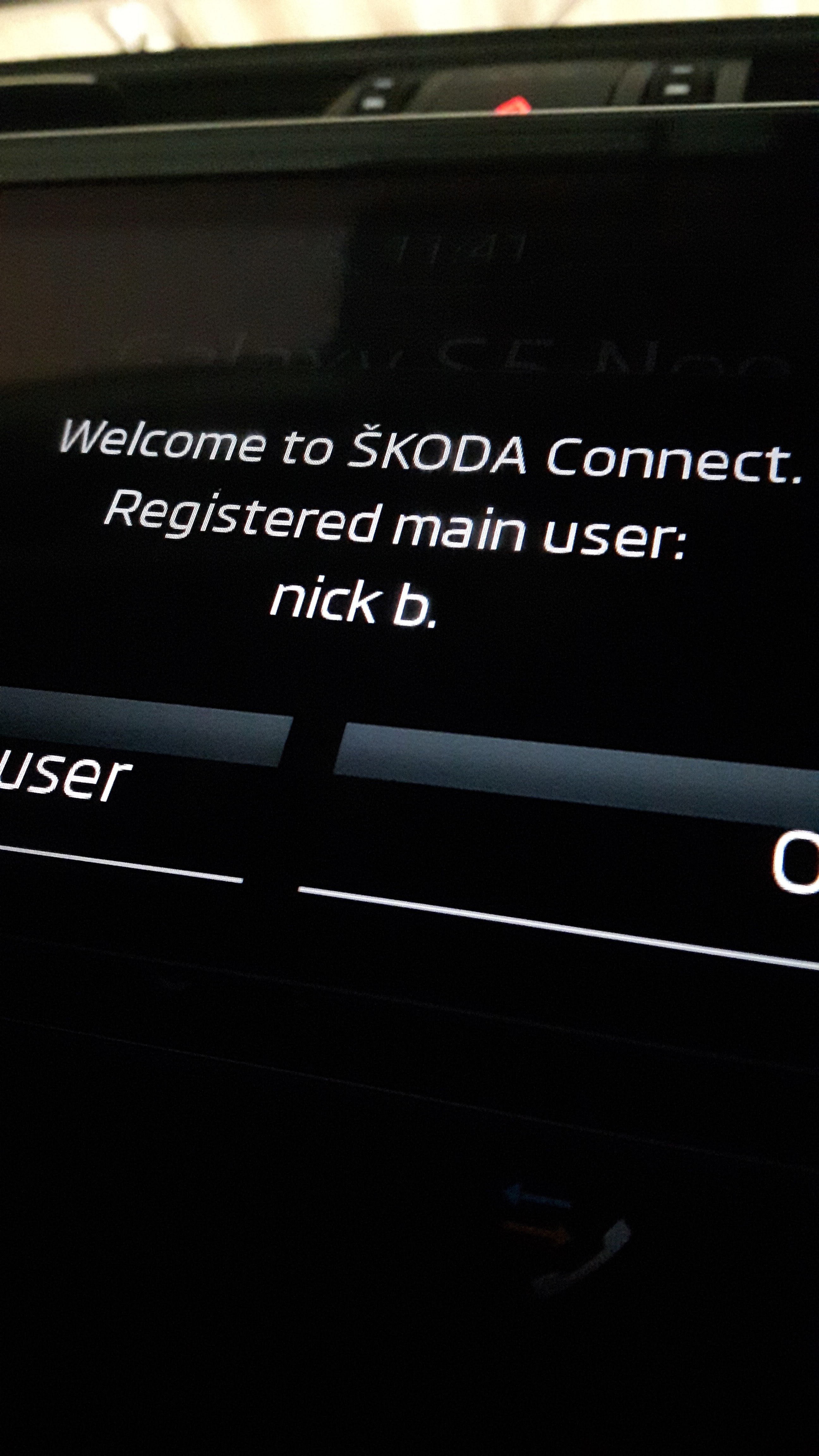

Can ye take a picture of the message and post it? Hide any user data that might be sensitive.

This is what I'm seeing...
