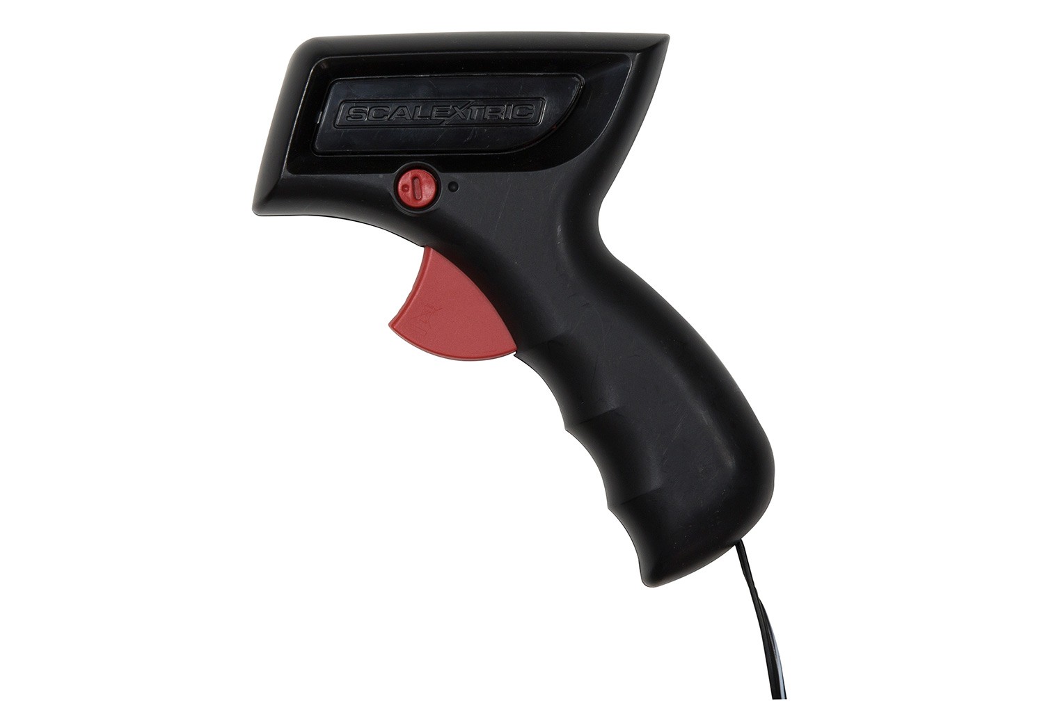

Or you could wire one of these in place

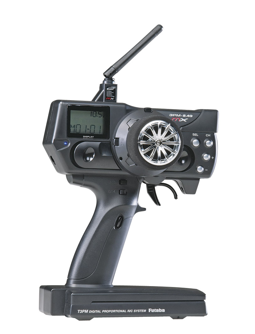

Great idea! I am now considering one of these for when my wife is driving.... like yours but wireless and with steering and brake
