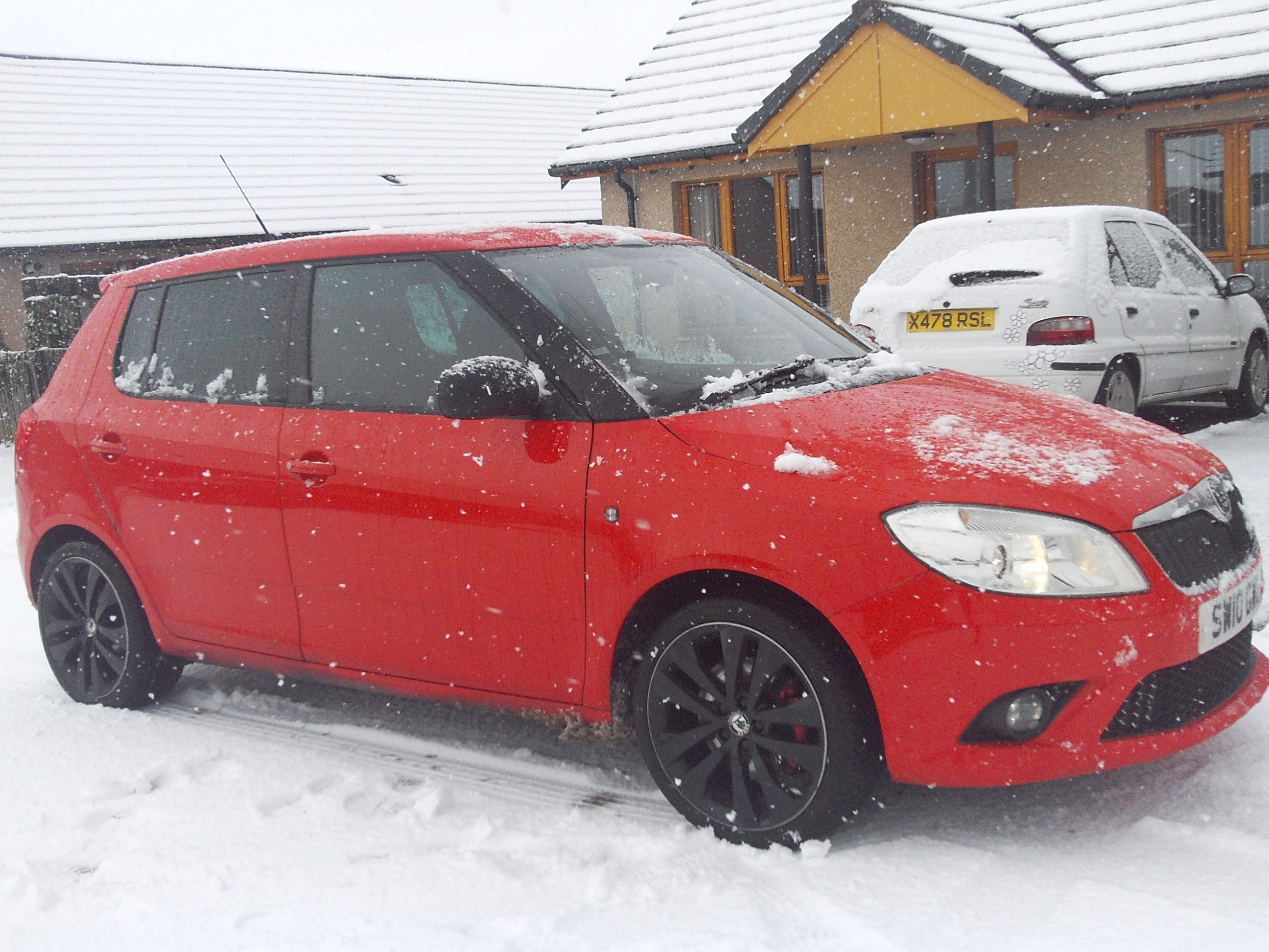

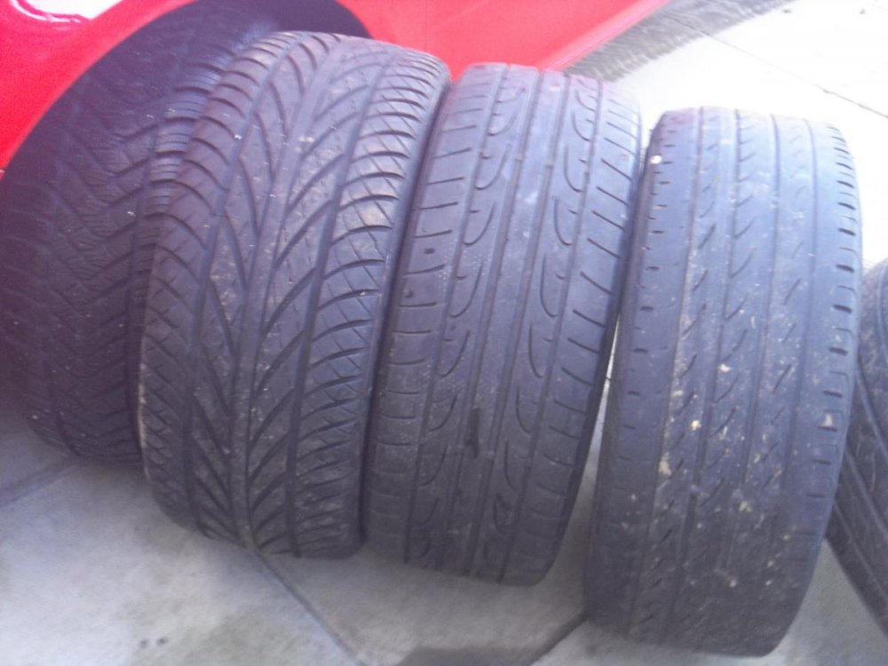

Strange as i used Goodride SV308's 215/40 R 17 for a very cold snowy winter a few back @ 32 psi on a 205 ps 1.4 TSI / DSG Twincharger Fabia.
Only replacing them when the sidewall had a bulge hitting a drain cover that was up on a flooded road.
I fitted them around late July at MOT time and they were great through the Autumn in the Dry, Wet & Cold.
I used for a few thousand miles to Ski Centres and home, and in quite serious road conditions, un-salted / treated roads.
They were not ditch finders and behaved very well on icy or wet or slushy / snowy roads.
Tyre on the car in middle picture is a Maxxis AP2 All Weather, next to it Goodride SV.
(Then a Pirelli Zero Nero, really rubbish in the wet / cold / snow / ice, and with a puncture a Dunlop Sport Maxx ,
the standard fitment tyres which when there are Pulling Left issues Skoda / VW approve replacing with the Pirelli Zero Nero,
just to disguise the issue with the not Directional tyre with a strong sidewall.)
post-86161-0-01078300-1444393088.jpg.d98a61807a643ba6b06f8a224a4a6333.jpg.44cc49727db349875ca5fe63e546f95d (1).jpg
post-86161-0-01613600-1451087468.jpg.772f2c2c933ff268e4cae2936c3488c5.jpg.be4f3985ad77473d765382971ee76ef1.jpg
