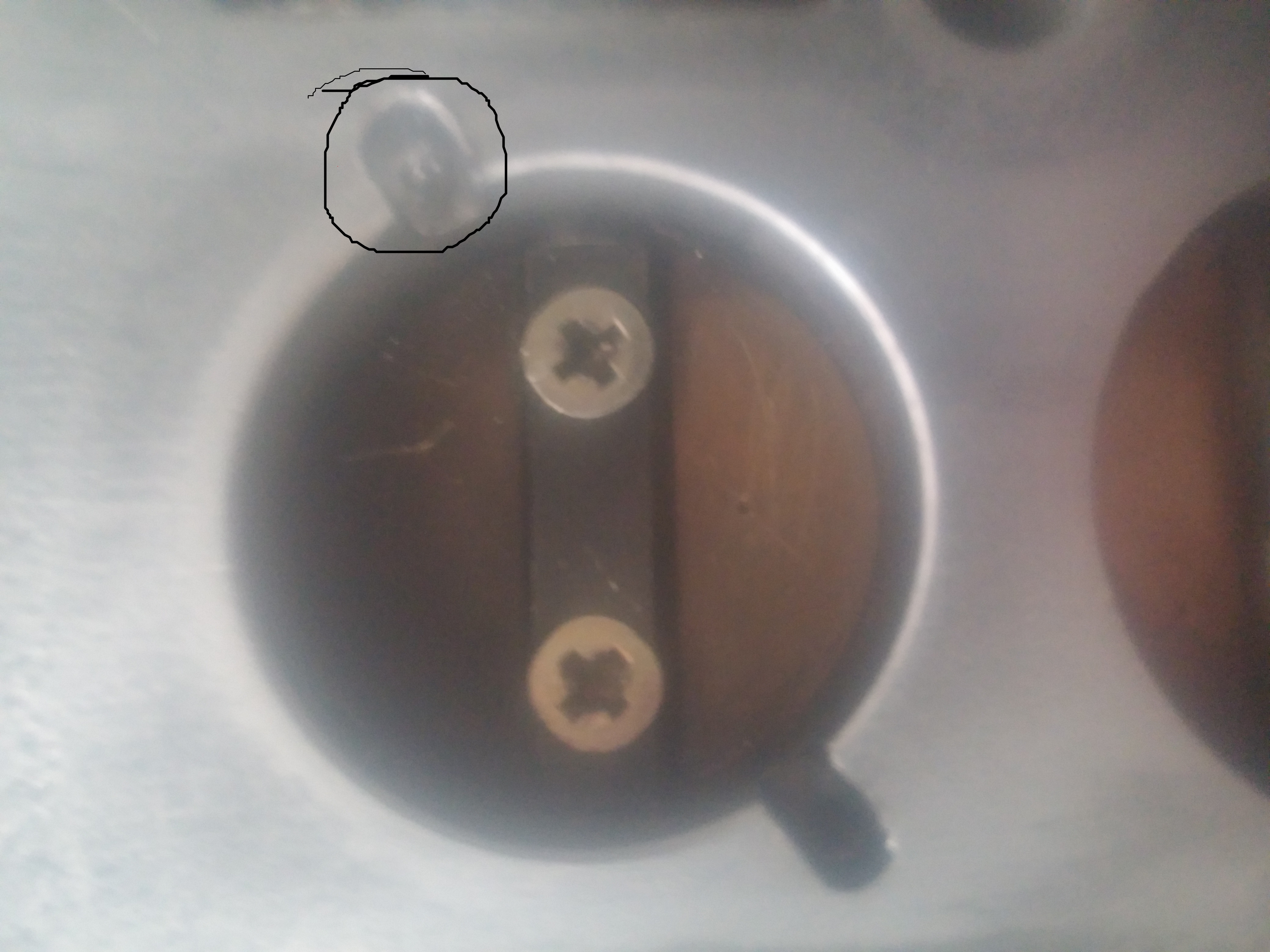

i have a little question is this hole is closed by manufacturer or it should be open like another one

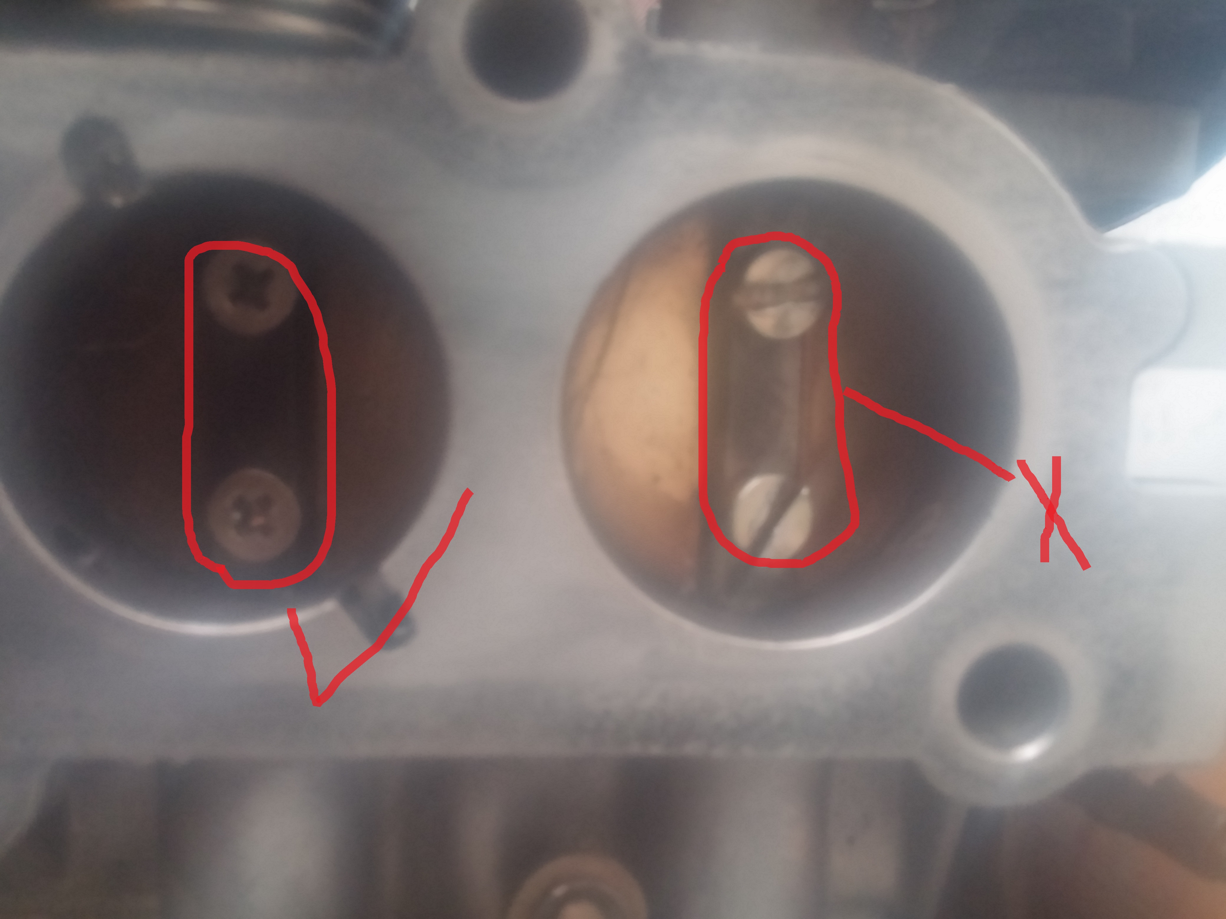

i found a strange thing in second stage gate the jets  of the second stage is not same as the first ((original)) are those jets affect on second stage mechanism
It doesn't matter. The gasket under the carburetor will cover the area.
What jets?? Those are screws, not jets...:o
yes i mean screws
My friend, it doesn't matter if the head of the screw is for Philips or flat screwdriver. Fuel doesn't exit through them (omg).
Moreover, the second stage of the carburetor has nothing to do with the cold start. The second stage opens only after the first stage is 40-50% open. It adds more fuel to the engine at high loads.
You have to concentrate on cold start (choke) mechanism. Read more about it to fully understand how it works. You can't diagnose stuff without proper knowledge.

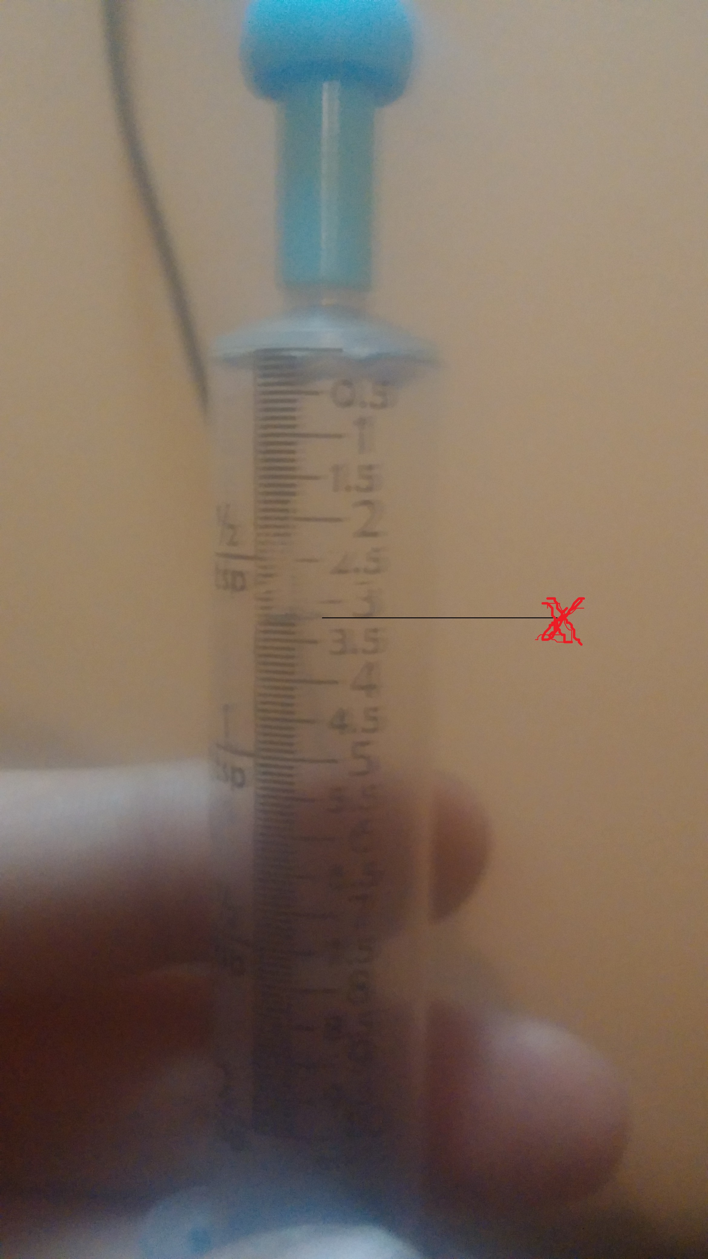

is ths mark is correct as i open the throttle complete to the end 10 times
if any thing is wrong please modify

It is OK.
Try a better camera. The quality is deplorable.
