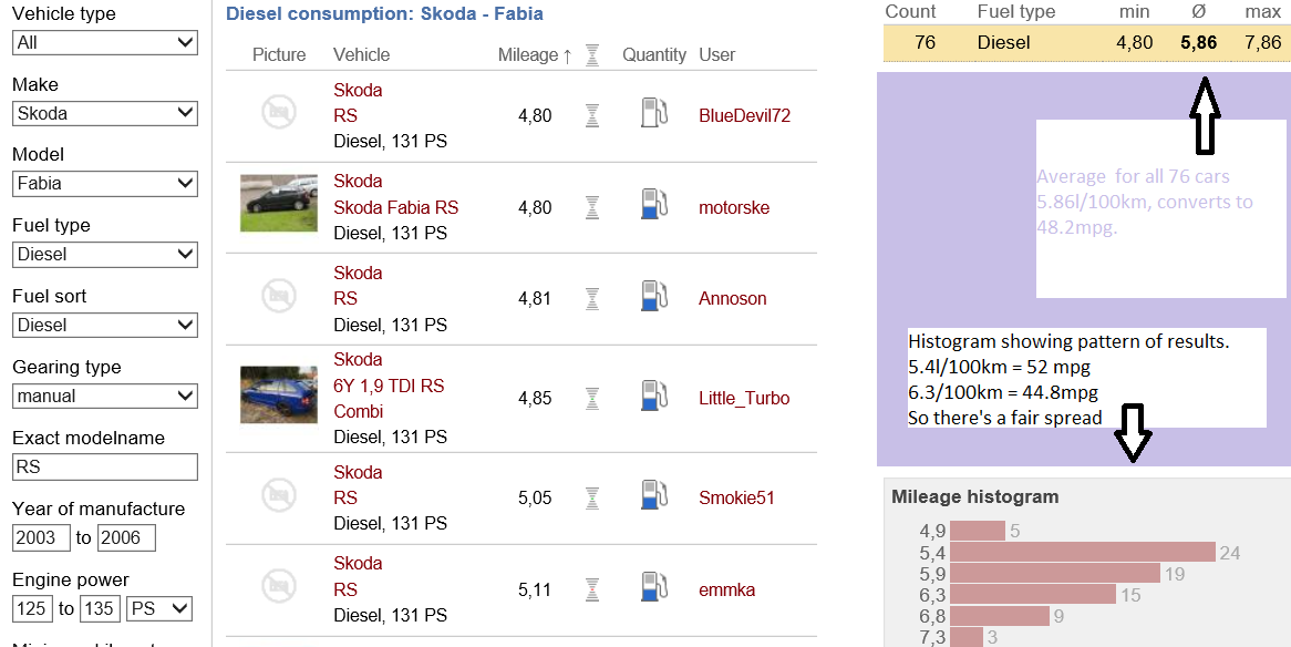

Here's an annotated screenshot from Spritmonitor.de; covers 76 vRS's.
thanks for that wino, my long term average is about 43.8 over the last 8000 miles. That seems quite a way off the 'average' 48mpg which is showing on there.
