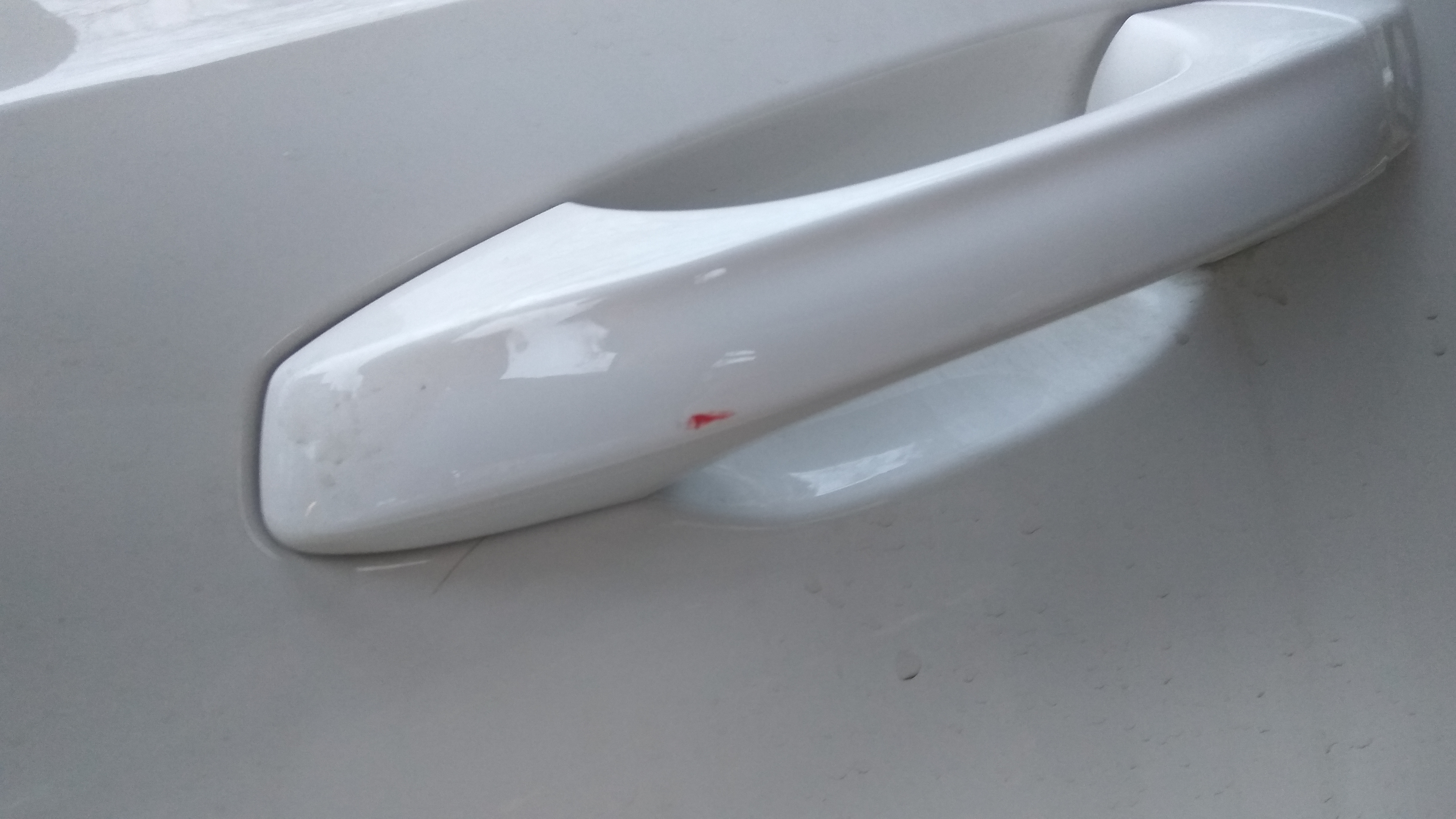

Today a red car parked next to mine left a marking on my door handle.
No need to mention his car was full of dents and scratches (you know the type)
Obviously I am not going to wait for driver to come out from a large building where he probably lives and tell him to fix this, so I will skip this part.
I tried to wipe this but it looks like its embedded in my paint.
Do I need to use those touch up paint kits?
I have never used those before. I have Candy White.
That looks like a transfer rather than something that's removed your paint. Try an abrasive polish on a microfibre pad - something like Farecla G3.

I tried some of iron-x which I had lying at home but it didnt do a thing (maybe its not the right product)
I will try some claying tomorrow.
but I can feel under my fingernail that this is little stratched like his color replaced at least part of mine.
Think iron-x is a contaminate remover, mainly to remove brake dust from alloys and paintwork and other airborne contaminates stuck on your paint. You need a slight abrasive to remove your newly acquired mirror flashes.
Iron X won't do anything to paint, it's designed to react with iron. Try clay and if no luck then an abrasive polish; t-cut, Farecla G3 or something labelled along the lines of "scratch remover".
If it turns out it has damaged the paint on yours, its going to look better/less noticeable without red paint. A small amount of touch up paint should improve things further if you have paint missing underneath the red.

That will easily polish out with Autoglym SRP, have you got missing paint or is it reflection, the other white looking chips?
no, its reflection
I have managed to clay it.
