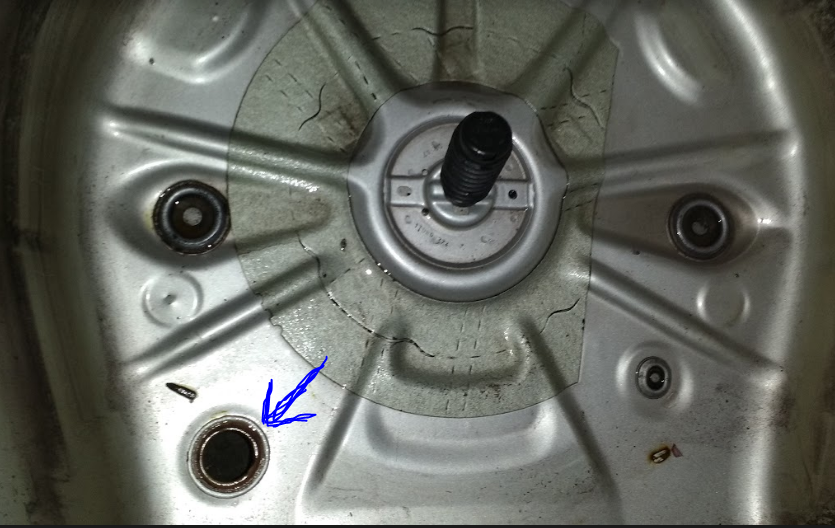

Secondly, while clearing out the pool of water under the spare, I noticed a hole (see attached image).
Is this supposed to be like this?  The other two similar sized thing to the left and right of the spare wheel holder thread seem similar size and seem to be rubber or something similar.  What are these?

Looks like previous removed the bung to drain the screen wash swilling about there. :wondering:

You can get a bung from your local TPS cheaper than Skoda. Or compare their prices. My wife's got the rear washer not working syndrome too.
I wouldn't be surprised if there is a generic blanking grommet that will fit at a motor factor. Measure diameter and get something slightly larger.

Any idea what the actual name of that bung is?  Struggling to find anything on Google.

if you ask for a blanking grommet you should be understood at a motor factor.
In case it helps anyone else, I think I found the part:
1K0899185
Bah! Gaffer tape if you insist. But its actually good to have a drain hole....at least until you fix your leak...

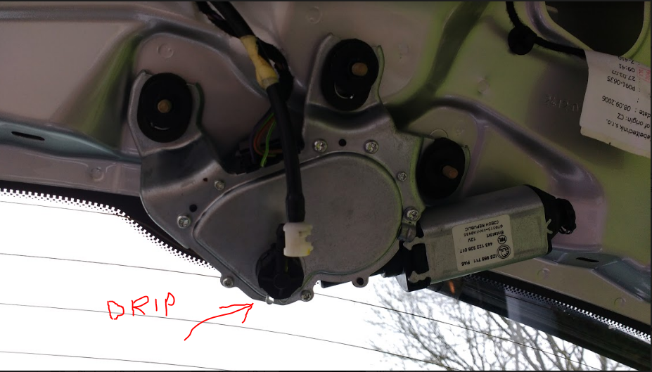

So I have managed to remove the trim and access the jet.  To my surprise the hose was still attached although there were clear signs that water was escaping from the jet somewhere.  I disconnected the hose and got my wife to try to try the rear jet while I sat in the boot with a bucket (note the jet does not spray if the boot is open!).  She found soaking me hilarious :( but it proved that the pump and everything was working OK so there must be some kind of blockage in the jet itself.
I connected the hose back up and then removed the cover off the bottom of the wiper arm which covers the jet.  The little nodule thing which contains the two nozzels just pulled off and I could see that it was pretty gunked up (I couldn't even stick a pin down the holes).  I sprayed again (without the nodule) and got a nice straight line of water.
However, the mechanism of the jet is still dripping a fair bit.  The dripping does not seem to be coming from the hose, it is coming from the back of the black circular bit where the hose connects.  You should be able to see the drips in the attached pic (with the hose disconnected).
I am guessing that the blocked up nodule has busted a seal or something inside the jet/motor.  Can anyone advise if this is something that can be fixed or will I need to replace a part?  If I need to replace, can I just replace that specific part or do I need to replace the whole washer jet thing.

Using poor / non genuine screen wash blocks the rear jet which if not replaced causes a rust build up in the motor. You can remove the jet & working the washer try & force the blockage out. However a new motor is the option I have found to be best. Then always use genuine screen wash.

Thanks buddy, I think I will just get a new motor for peice of mind.  Can you point me towards the correct part?  I'm struggling to work out exactly which part I need.

Errm, that photo is the wiper motor, through which the wiper jet is connected. I would imagine a new wiper motor won't be cheap.
I vaguely remember there was a thread somewhere showing how such a leak can or cant be fixed. Might be wrong though.
This is one

Thanks, it looks like if I shop around I should be able to get a new motor for around £40 I I'm lucky
