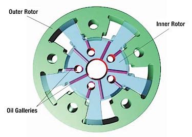

So basically its due to the old vag oil drain down problem, the reason many camchain engines had an early death. But apparently no problem on these engines.
I call BS. The noise is not due to oil flow noises, but lack of oil in the cam phase shifters on start up which bash from stop to stop until oil finally fills them. No problems?? I don't think so...
Hmm. No problem for the duration of the first PCP, perhaps, but after that...make sure you get a warranty on a used Skoda!

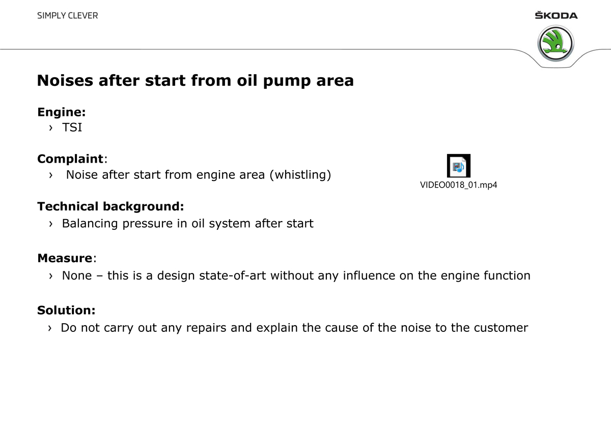

I have Superb III with engine 2.0 TSI for more than 2 years and every time after cold start I have this strange noise up to 2 seconds as well. I have asked my dealer about this problem several times and the answers all the time were the same - the manufacture evaluates this as "car phenomenom":)
Sound from oil pump area Explanation.mp4

Here's a response another person received from Skoda for their 2.0 TSI Superb that has the same issue:
www.briskoda.net/forums/topic/443577-proud-new-own...3
He seems to have been told it is a "harmless" oil pump noise, does this explanation and said noise being "harmless" work for you?
