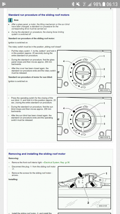

As this will be a bit vague it may not help much, but when I had a similar problem with mine, the dealer recalibrated the closing sensor while I watched. What is happening is that the sensor thinks there's an obstacle and behaves accordingly (by reopening a bit). In fact it's just detecting the end wall of the recess.
I think what he did was carefully close the roof manually (by tilting the bezel) three times in succession: after that it learns the proper closed position.
I may have got this wrong. But it might be worth a try.
Thanks for that. I have just fixed the sunroof!  Not by your method, but you put the word recalibrate in to view. After searching recalibrate skoda panoramic sunroof I found this.Screenshot_20180118-061350.thumb.png.815b7b093dadad9126ec8ae2160ca7db.png

Excellent instructions. I’ve just experienced this on a 2016 Octavia, the roof would only ‘nearly close’ and then tilt up again. Without the roof fully closed it would not reset or recalibrate…. Weirdly,  part closing the sun blind caused the roof to fully close, the recalibration process then worked, all sorted again 🙂
