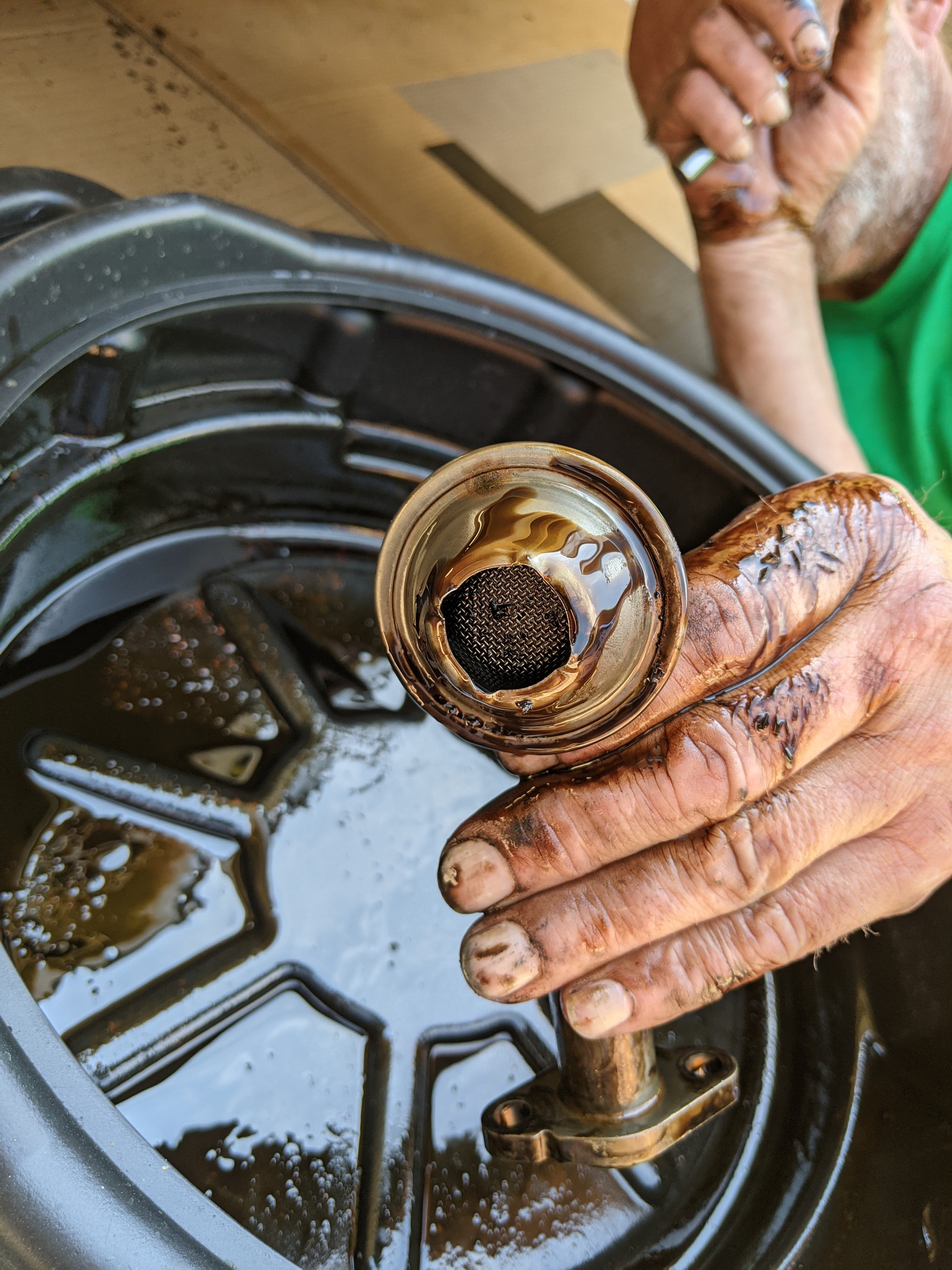

Also changed the oil pick up pipe, oil, sparks and oil filter.
It runs smooth for a bit, then the idle seems to alter and go searching, then the power dips right down and it stalls.
Great work, looks nice and clean for 19 years!!
What ended up being the issue with the cam belt?
I usually just clean the pick up pipe with brake cleaner and refit. No need to replace unless its damaged.
