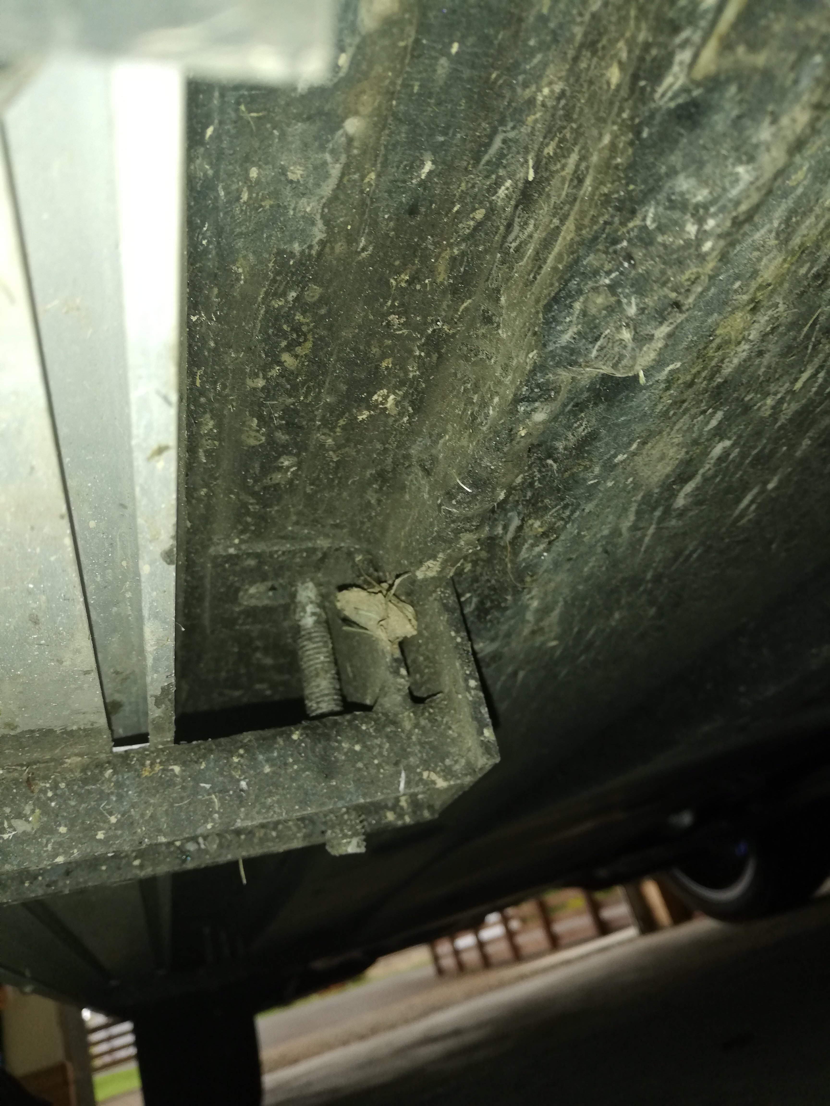

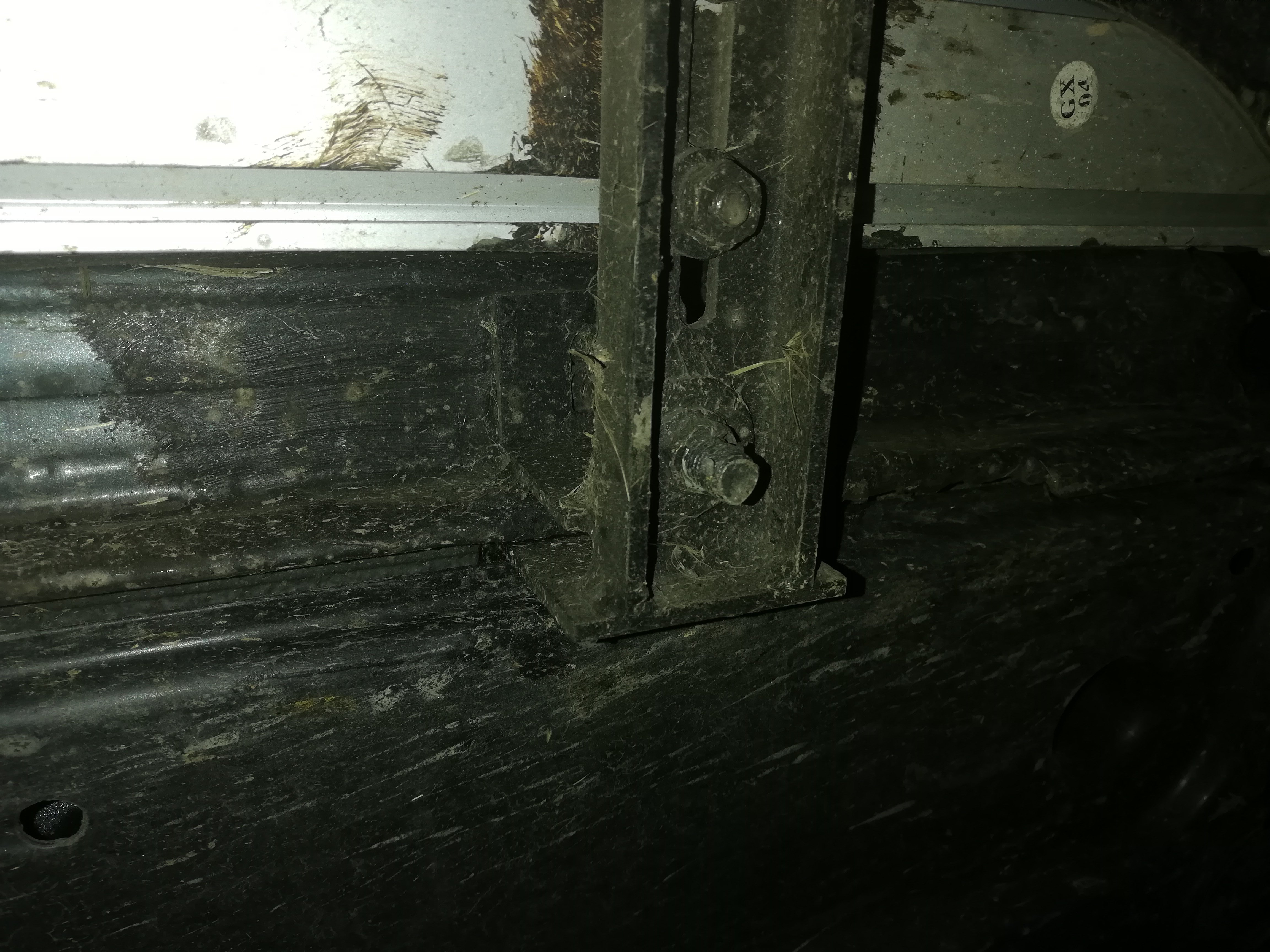

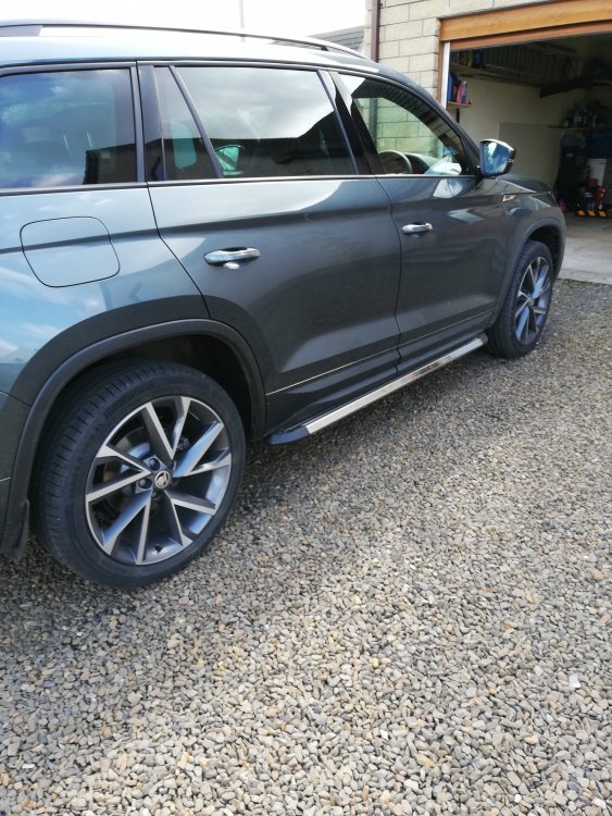

I recently fitted the "stingray" side steps from this firm (direct 4x4) as they looked decent and were well priced at £220 Inc delivery (compared to £700 supply only for genuine skoda ones from my local dealer + they couldn't say when they might get them in stock) . I too was concerned after viewing the downloadable instructions and the total butchery shown in the above video. However after studying things closely I felt I could manage to install them myself without cutting the undertray at all. Which is exactly how I did it (in actual fact the supplied instructions in the kit must have been updated since the above video etc as they don't mention any cutting of the undertray at all now). All that's required is to undo 3 screws and 1 clip along the outer edge and at the front of the undertray allowing it to hang down slightly, enough to allow the fitment of the brackets via the same fixing points the genuine skoda running boards use and then screw everything back in place. I chose to trim the rear plastic removable covers mentioned to fit around the rear mounting brackets however they can be left of completely as per the instructions. Don't worry about the integrity of the plastic undertray (some people else where have mentioned water and salt ingress) the undertray is not sealed anywhere and is only there to smooth the air flow under the vehicle (not to be confused with the off road underbody protection available as an optional extra and much more robust than the standard undertray) also there are numerous drain holes to allow any water that's found its way in back out again and there is a 5mm gap all around the outer edge. The only other deviation I made was to shorten the front inner fixing bolts by 10mm to allow the undertray fully back in place. Plus a healthy coating of black underbody sealant on all the bracketry. Hope this helps. I must get some pics from underneath to put on here also.

Finally got around to taking a couple pics from underneath showing no cutting of the under tray to fit these direct 4x4 running boards to my Kodiaq. Excuse the grott on the under side of the car, roads my way are fairly mucky at harvest time
