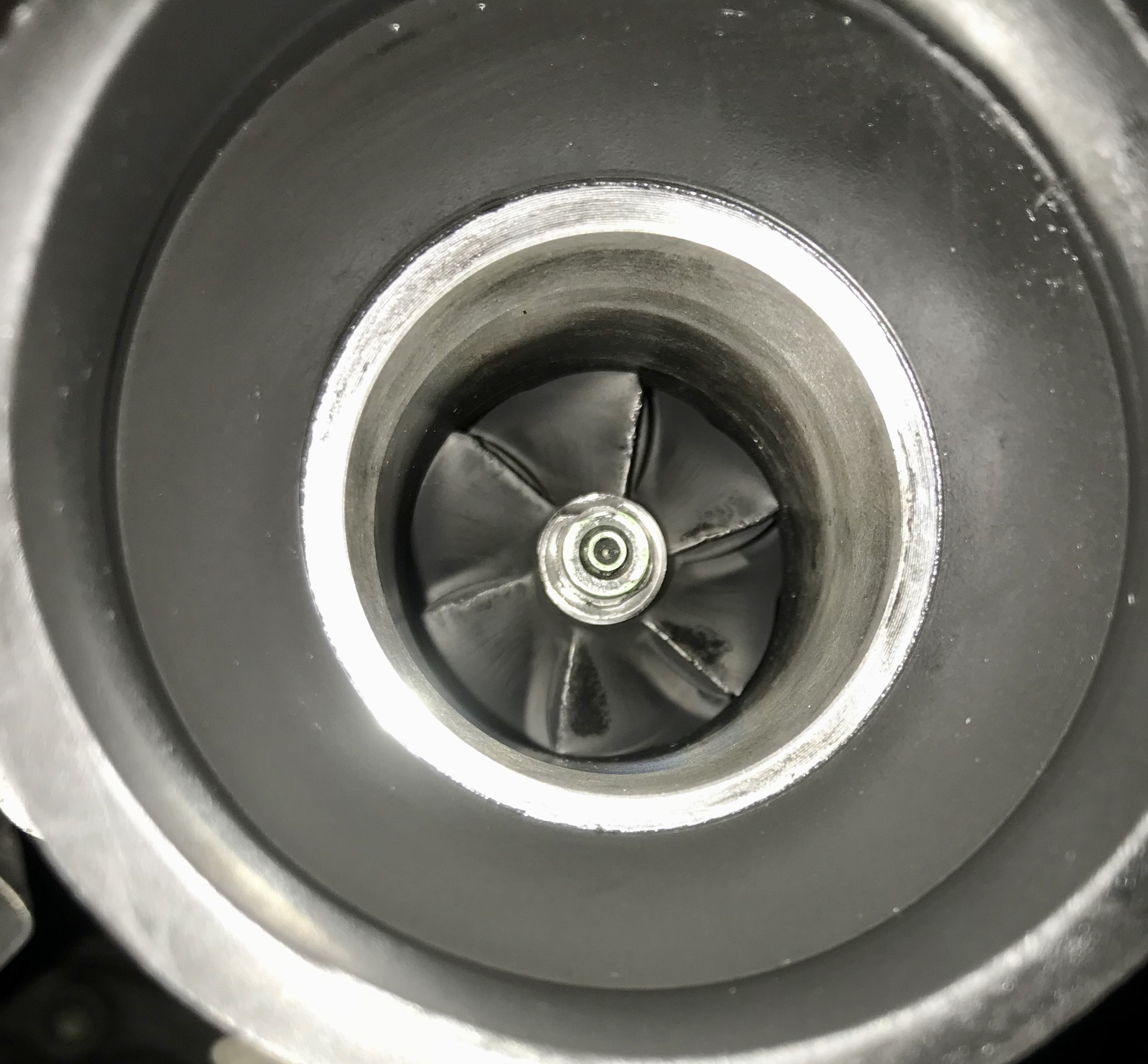

  • Personally I can’t see anything wrong here

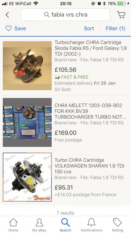

I didn’t know they done a Garrett PD130 option thought it was only the KKK that’s why I thought he meant the Pd150. So it’s not worth buying a more expensive Melet (Garrett built) core and replacing that then? Around 115 they are for the chra cartridge

Personally I can’t see anything wrong here :biggrin:
Looks fine to me.

Regarding the unit i linked on ebay, it seems they supply just the cartridges as well for around £120. Is it not worth the extra £85 to have a complete turbo built with new studs and everything already set up with a 2yr warranty?
That was my thoughts anyway but suppose if your on a budget then doing it the cartridge route would be cheapest.
There'll be a fair bit of that missing metal in the intercooler, so you'll want to remove that and flush it clean. Nothing wrong with fitting a CHRA, no matter what route you choose you'll have to set the actuator rod anyway.

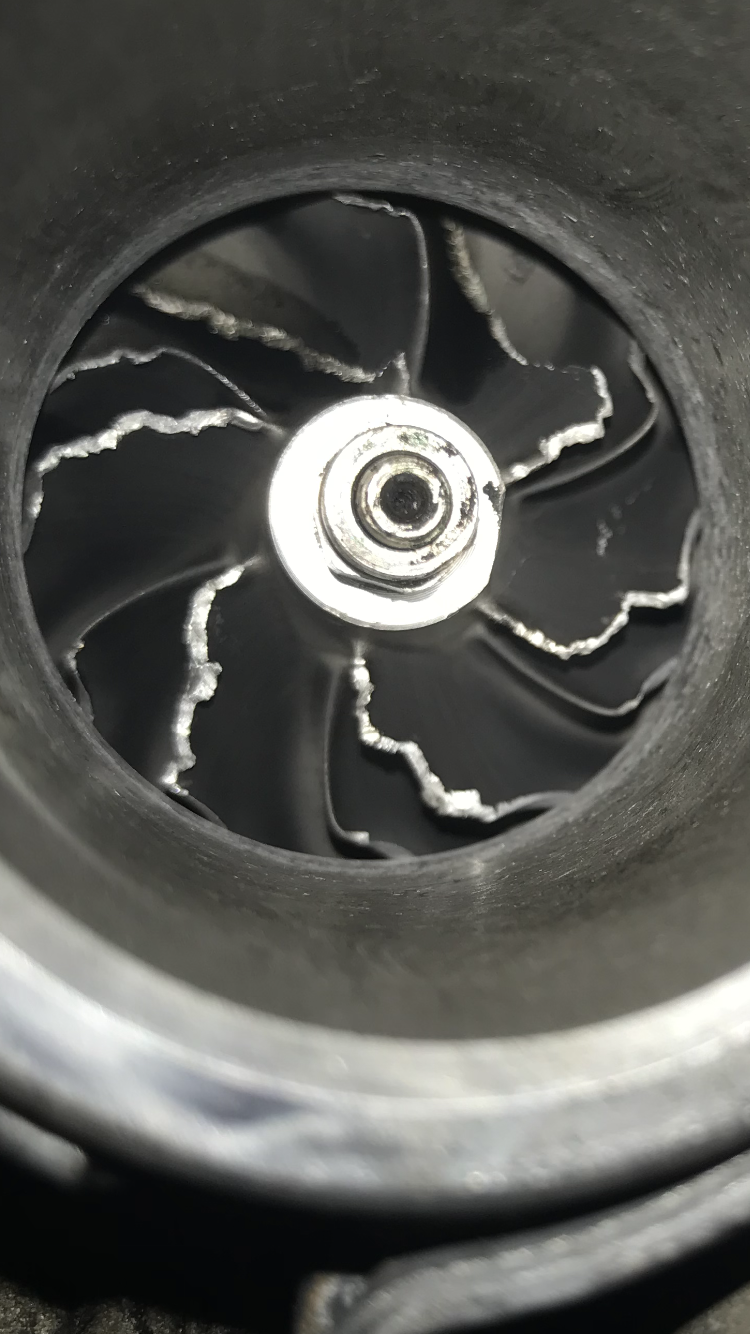

So looking at the turbo you would say just replace the cartridge? Granted the blades are damaged but still as a whole if that makes sense so possible damage to the housing isn’t an issue?
Nope, the housing will be fine, the blades are incredibly fragile and basically explode when they touch the housing, a lot of that damage is from bits of broken blade bouncing around before getting sucked through.
What causes them to hit the housing though?! That’s what I don’t understand funny thing is the shaft feels like it has very little play left and right and back and fourth!! Really confused as if something went into the turbo however it’s standard air box and standard filter!
The impeller runs VERY close to the housing, it can be caused by oil bush wear or impeller overspeed.
