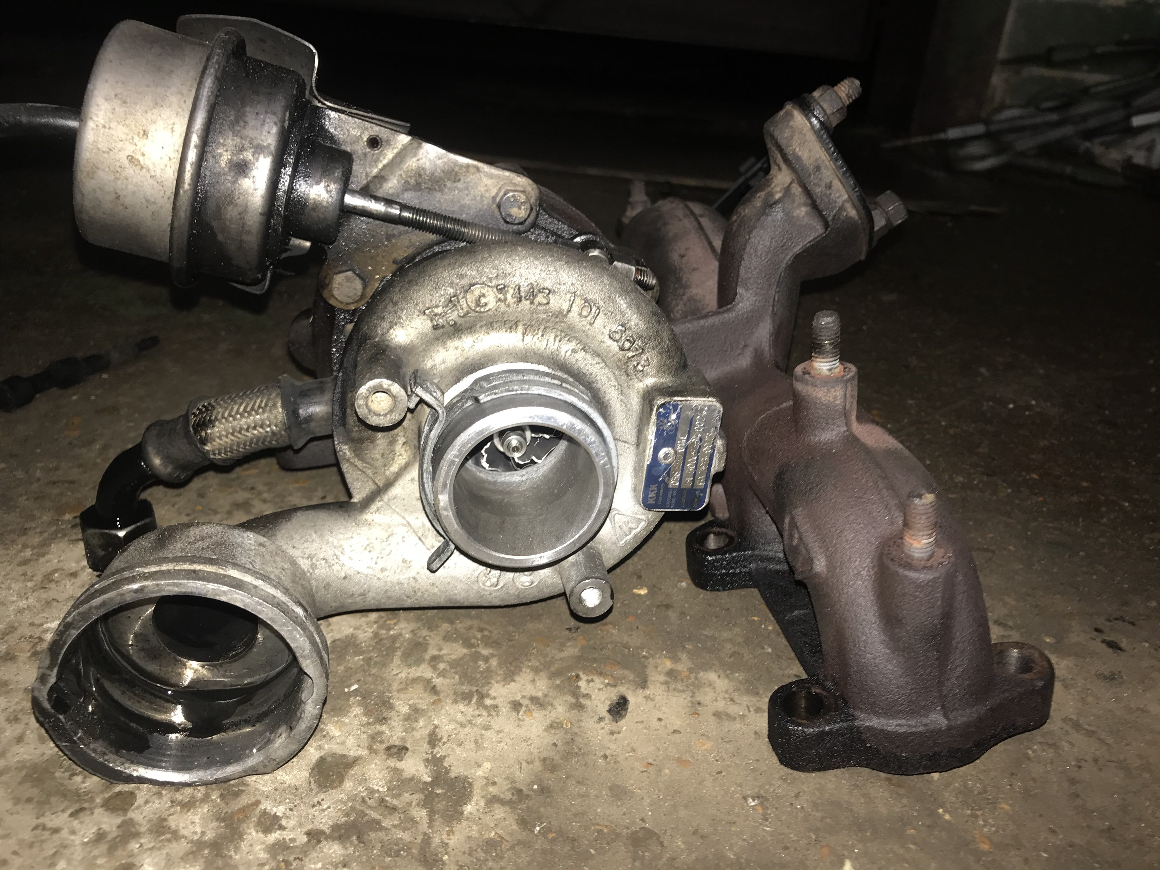

Ive torn the car down today, inlet manifold is off, exhaust downpipe is off, boost pipe onto turbo disconnected, as far as I know know it’s a case of disconnecting the bayonet click type fitting off the turbo, remove oil feed pipe, remove support bracket then take off the turbo and replace. The core does seem like a good idea, in terms of life would the core be better opposed to a second hand Garrett as it’s basically a new turbo? I don’t want to be doing this again a couple of months down the line but haven’t got the money to buy a complete recon turbo, I’ve been out of work weeks before xmas and only received my first weeks pay week just gone so times are very tough!

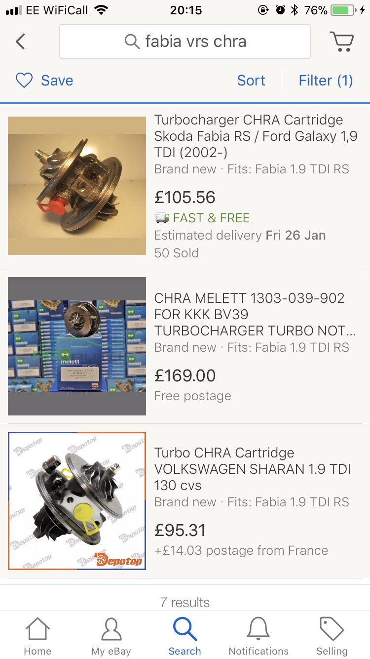

Managed to get the turbo off this evening, I’ve checked all the cast housing and manifold and found no cracks or anything so I think it’s okay to rebuild with CHRA. I’ve found Melett CHRA for around 140, would that be the recommended brand to go for? Or would you guys use another brand?
It's fine to rebuild. The impeller is like tinfoil origami compared to the rest of the turbo, who cares about brand, just get one with a decent guarantee and a spec. sheet showing dynamic balancing stats.
There’s a few on eBay UK seller 2 year guarantee for 100 quid, opposed to the 140-170 Melett kit. I want to rebuild it but worried it won’t work or smash into a million pieces once it’s done?! So Sepul if it was you, could you drop a link for me please on what you would personally buy? Is it worth paying the extra for Melett? I want it to last!
That’s the two I’m looking at, 70 quid between them there abouts. Obviously 170 is the Melett option. I’m worried about the VNT system, setting up the actuator same as it used to be, would a recon turbo be bolt and go? Or would it need setting up too? It’s a nightmare this I’m confident I can do it, but not confident at the same time! I’ve never owned a turbo or touched a turbo before hence my concern. I’ve watched videos and it’s looks so simple, is it really that simple? Is it a case of change CHRA bolt back together and go again? Or does the turbo need taking somewhere specialist to be set up etc?
No it's simple, as long as you have the tools and the talent, there's nothing clever, nothing tricky, mark the actuator linkage with paint so you can put it back together the same way it came off, take good pictures just in case.
There is no reason why the turbo should detonate after you've rebuilt it unless the CHRA is no good, remember you need all the gaskets and oil pipes as well and replace any dodgy nuts, bolts etc.
Rebuilding the turbo needs to be done under CLEAN conditions, that means a clean bench, clean tools, all parts clean, good lighting and careful assembly. Then you can throw it back on the car and start it, don't rev it at all for a minute to allow the oil to pressurise fully in the turbo bushes, then take it for a spank to make sure it's running well.

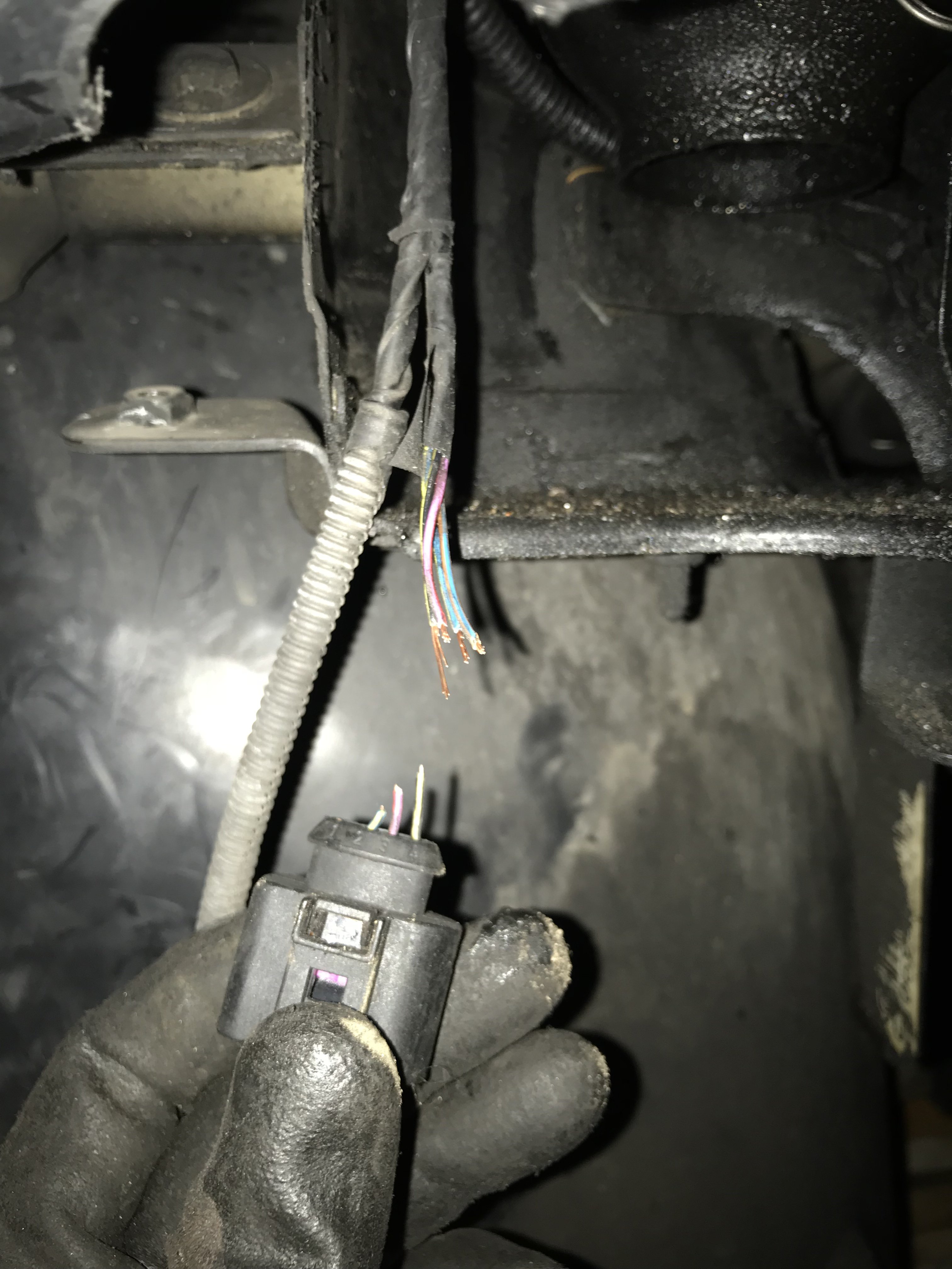

Started removing intercooler etc ready for front mount when...... ffs!!

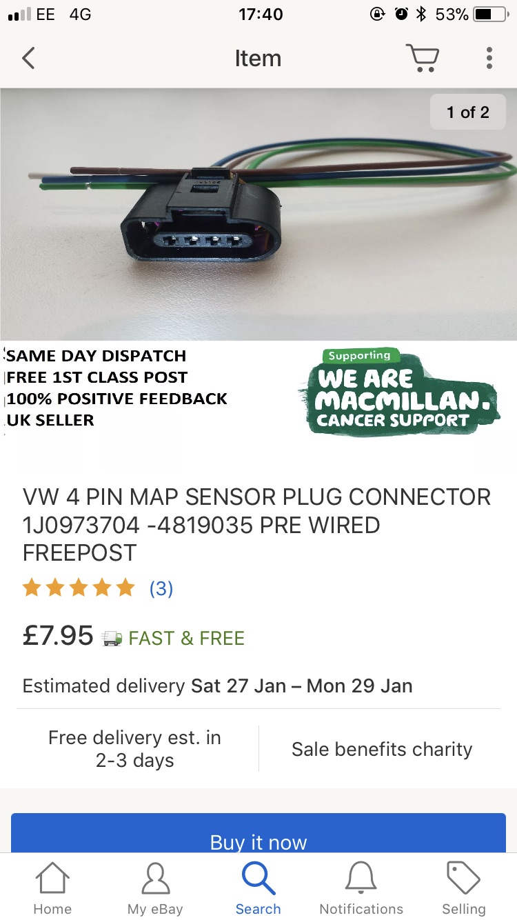

Guessing this map sensor! Wtf do I do now?!
Guessing I’ll need one of these?
Yup, that's a 'whoops' moment right there.
Was a proper whoops moment! My
own fault, I got a bit carried away and rip map sensor wiring

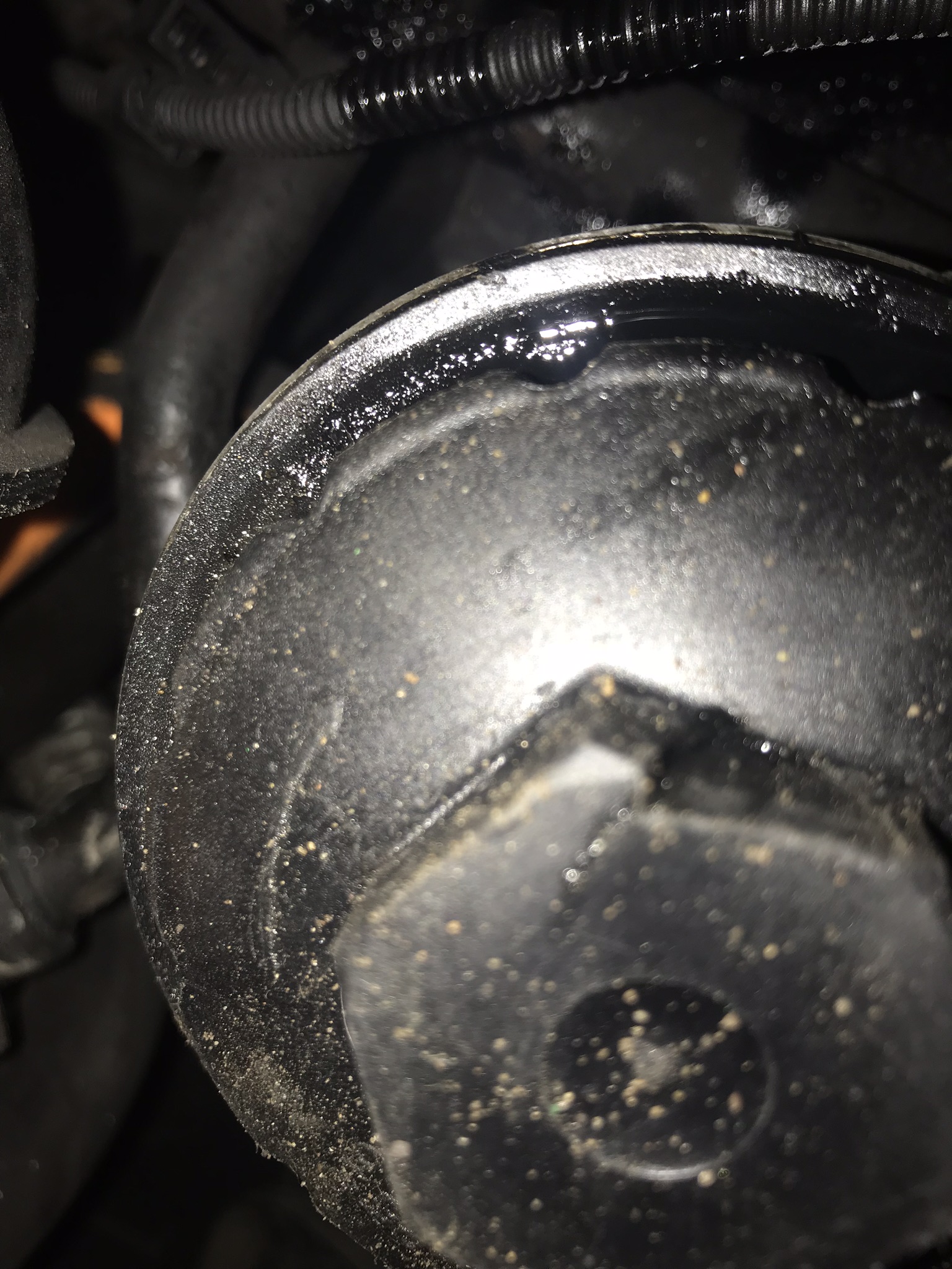

Finally got the car back together. New Intercooler fitted, everything modified to fit (had to do away with fog light and modify crash bar etc) crank the car over and it ****es out oil! Oil filter cover plastic useless thing cracked! £40 from TPS ouch, for a bit of plastic!! Never rains it pours!!!
