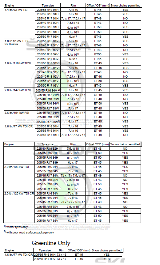

  • Does anyone know what size front discs this will have, and whether 16” wheels fit over? The 225/40R18s don’t really suit the compliant suspension.

Front disks are 312 mm and yes 16" wheels will fit. I've attached the table of type-approved wheel/tyre combinations at the end of this post.

Thanks for the tyre and wheel sizes, scuppers my plan to use my current Golf wheels (16x6.5 ET51) on this as the width and offset are quite different.
