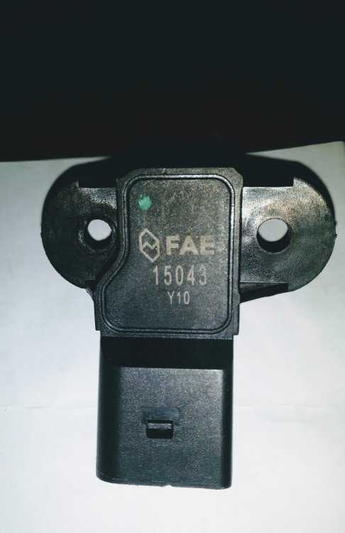

Hi, I have a 2005 Fabia Mk1 Elegance automatic. When started the engine starts smoothly, when I drive it the revs constantly vary as I'm driving by about 100-200 revs. It doesn't effect the speed, it sort of pulses.
I've had a bloke check the engine management and there are no errors. Has anyone seen anything like it?
I've changed the sensor that links the engine to the gearbox.
