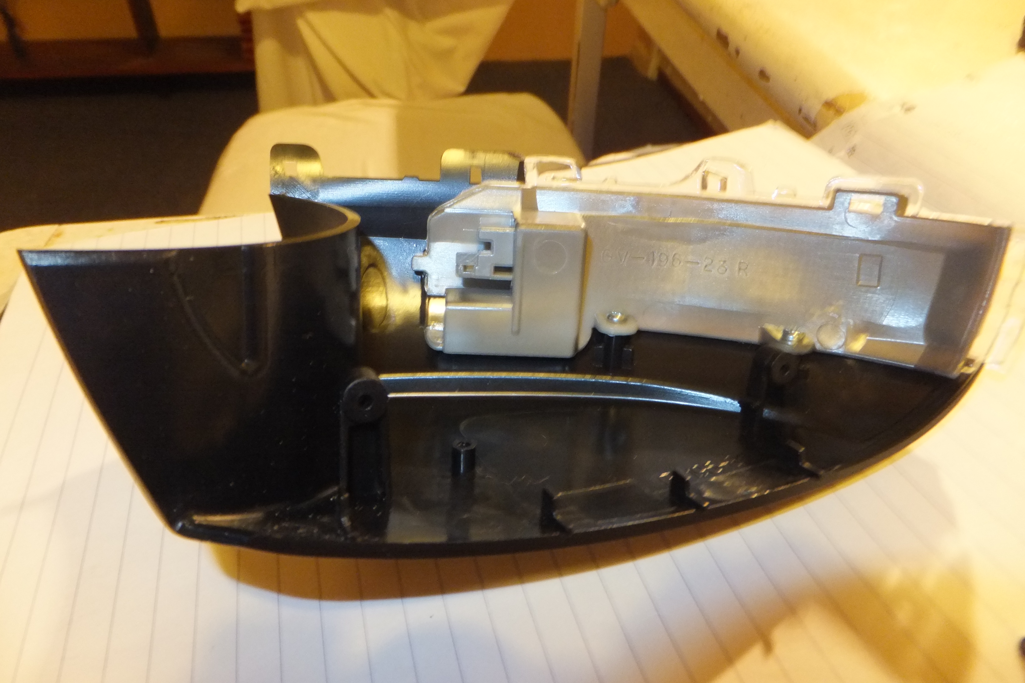

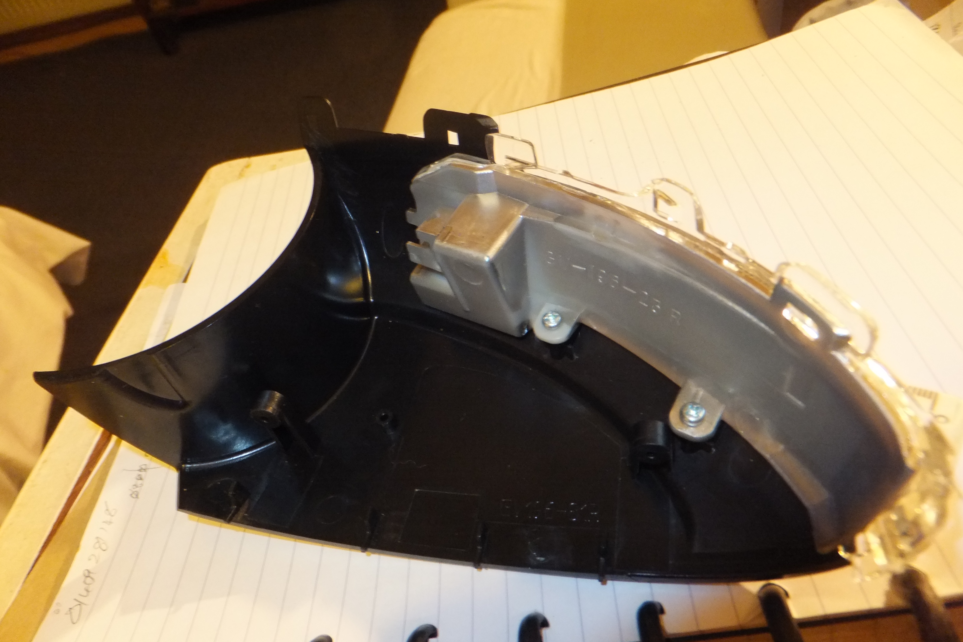

Shows two vertical pillars in base with holes that torx screws through main body screw into. Also silver lighting unit held to base by two cross head screws.DSCF0865.thumb.JPG.a9af292031367a3a80404d9972f5f9cb.JPGto

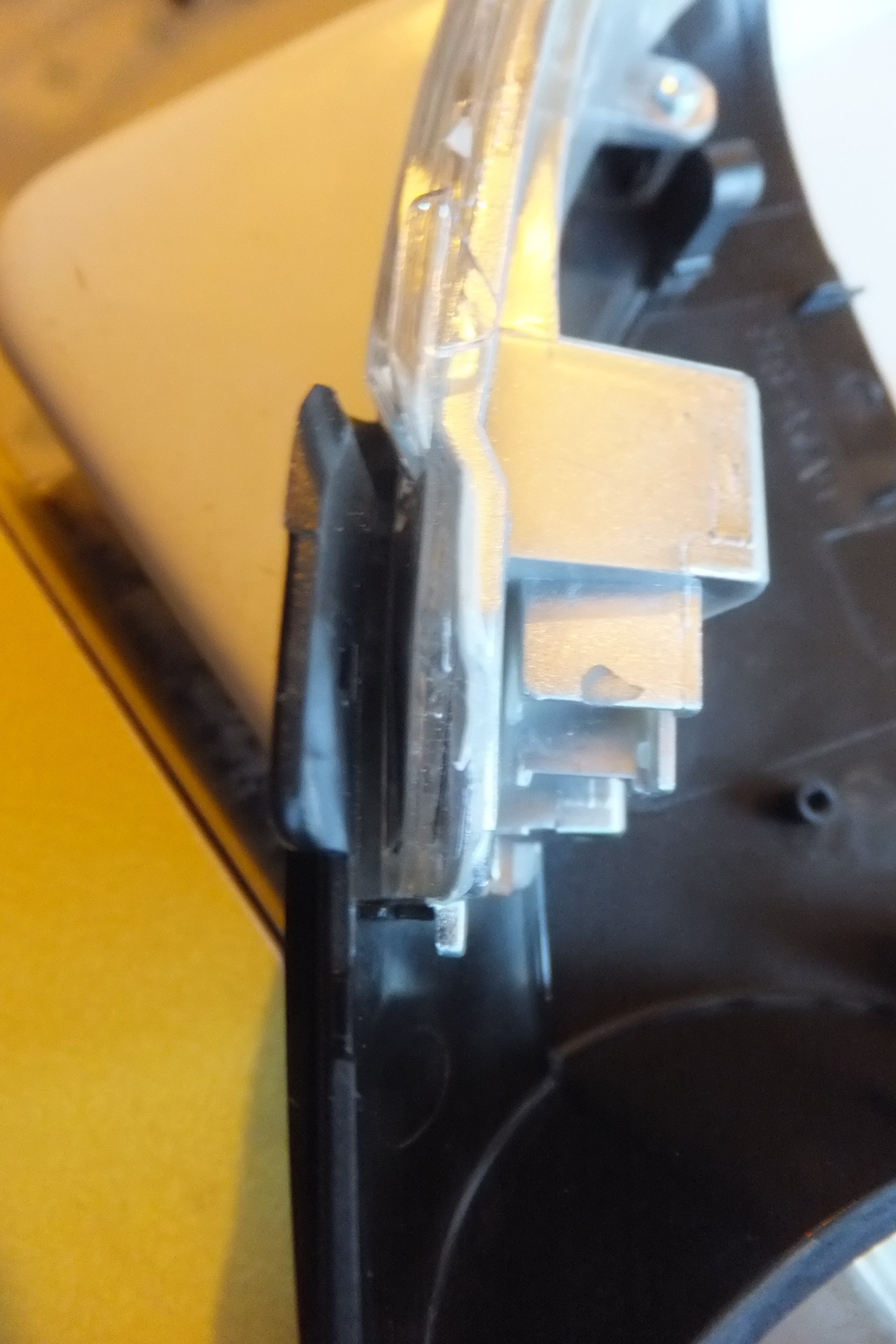

The two upward protruding tags on the left of the front black bit, and the body they are on actually stick a bit forward of the silver bit but hope that it will all get tucked back flush when it is pushed into the front cap.

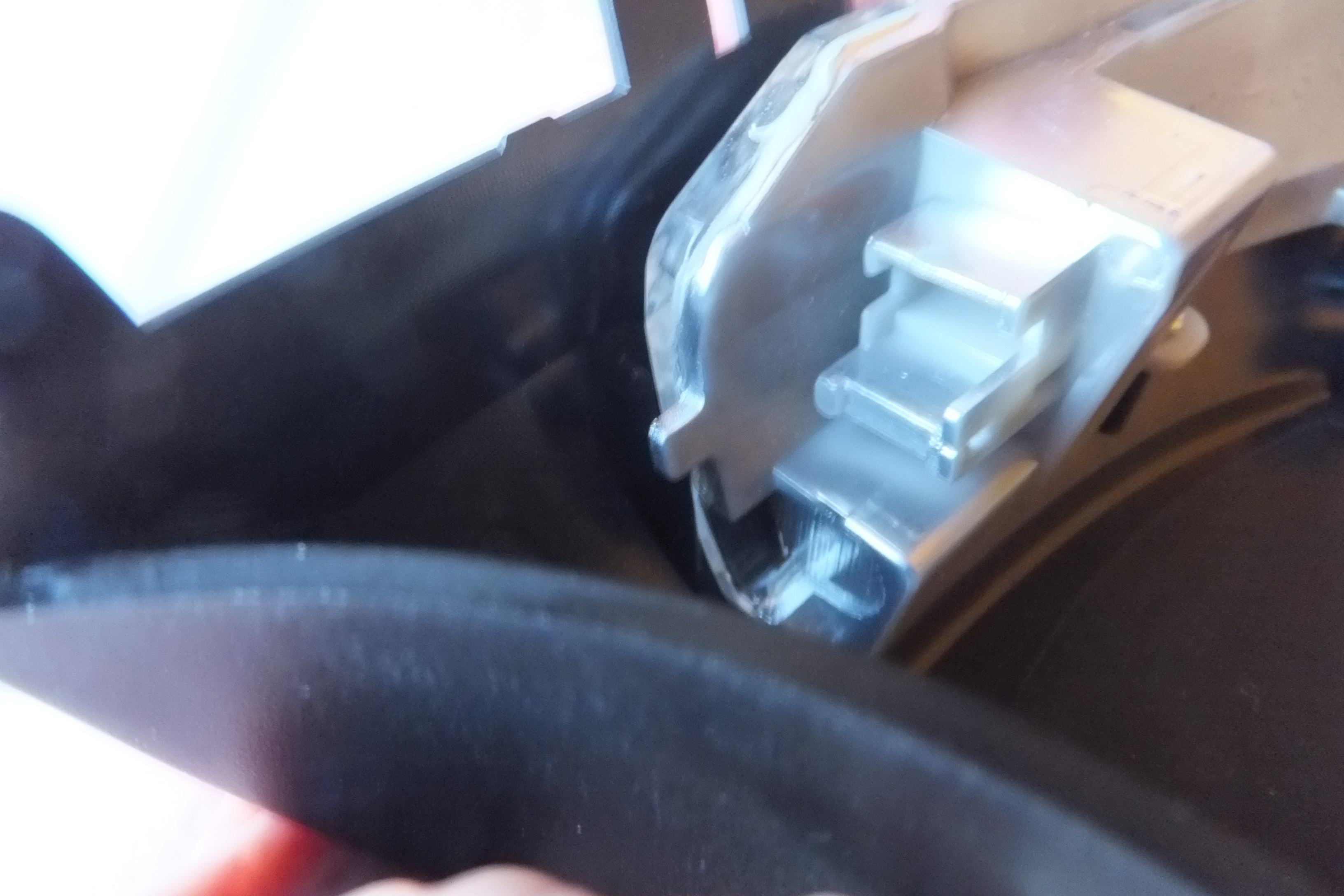

This shows very plain plug holder with the three connection pins just under the top of the flat bit

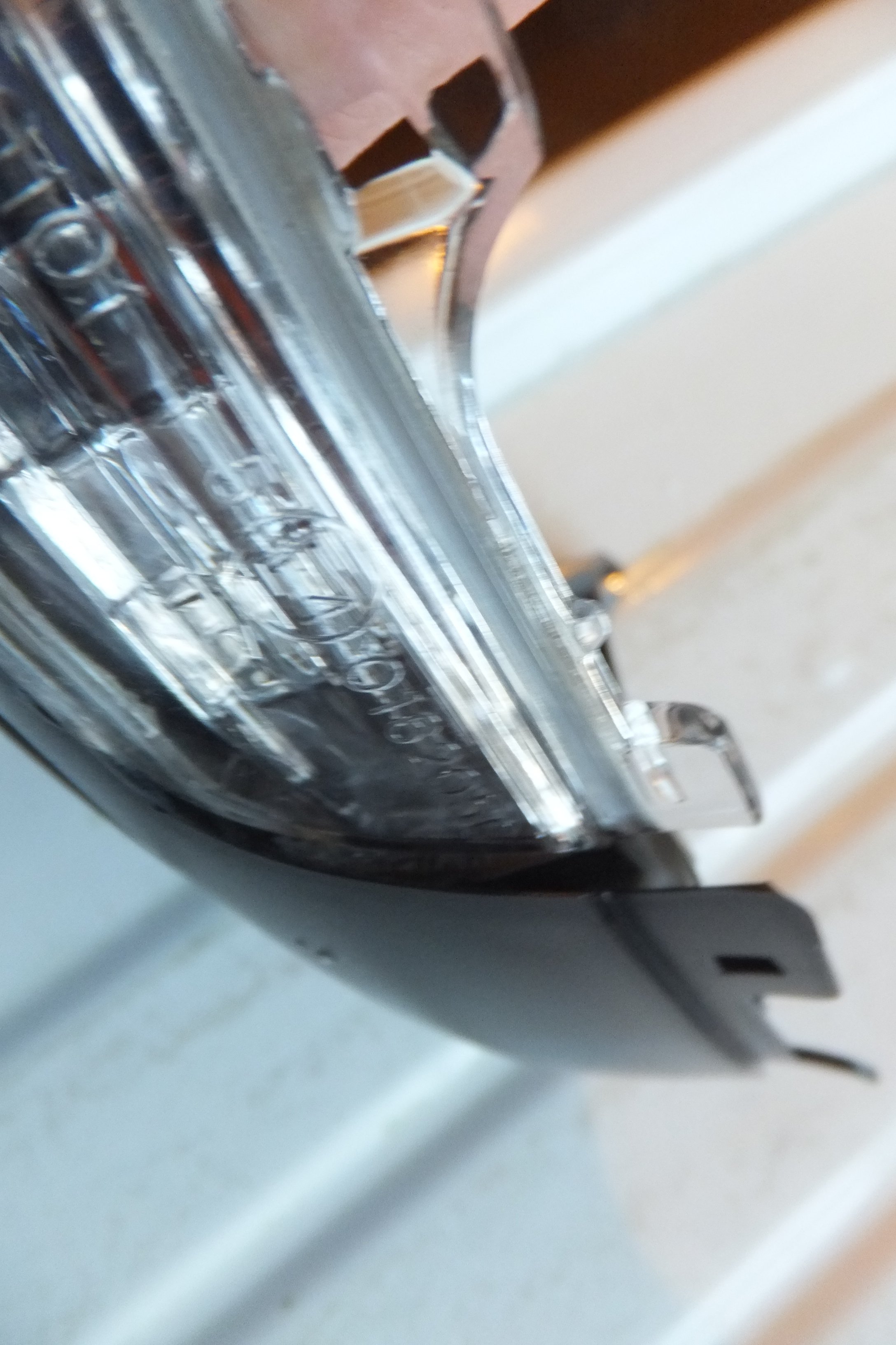

This shows the black plastic sticking out a bit from the lens bit
