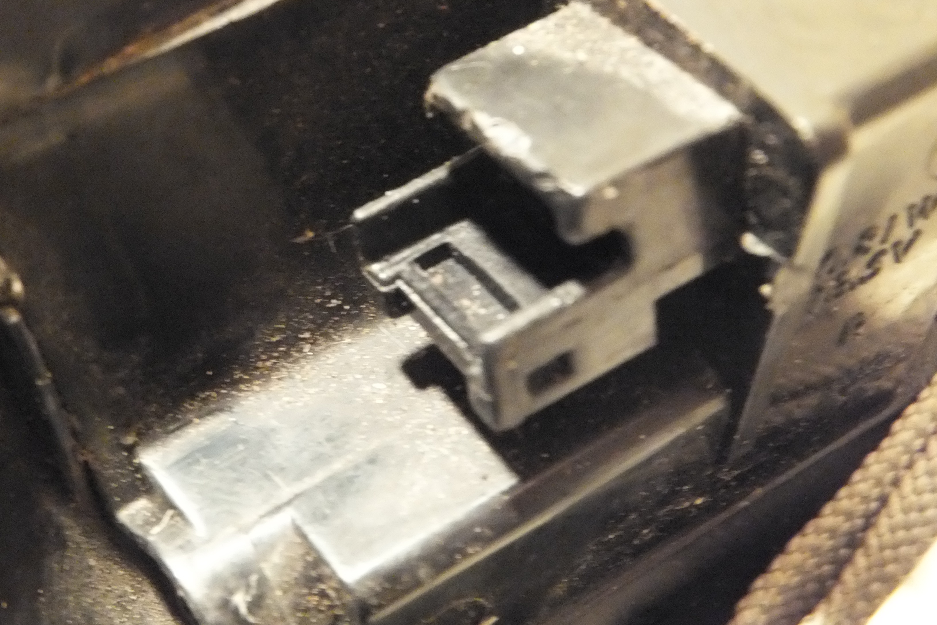

More dismantling and pics.  Problem of what keeps plug in solved?
See photo of old base and at the back of where the plug goes you will see a rectangular depression. I assume there is a matching protrusion on the plug at the end of the wires.  So the back end of the plug needs to be lifted slightly to clear the depression before the plug can be pulled back out.

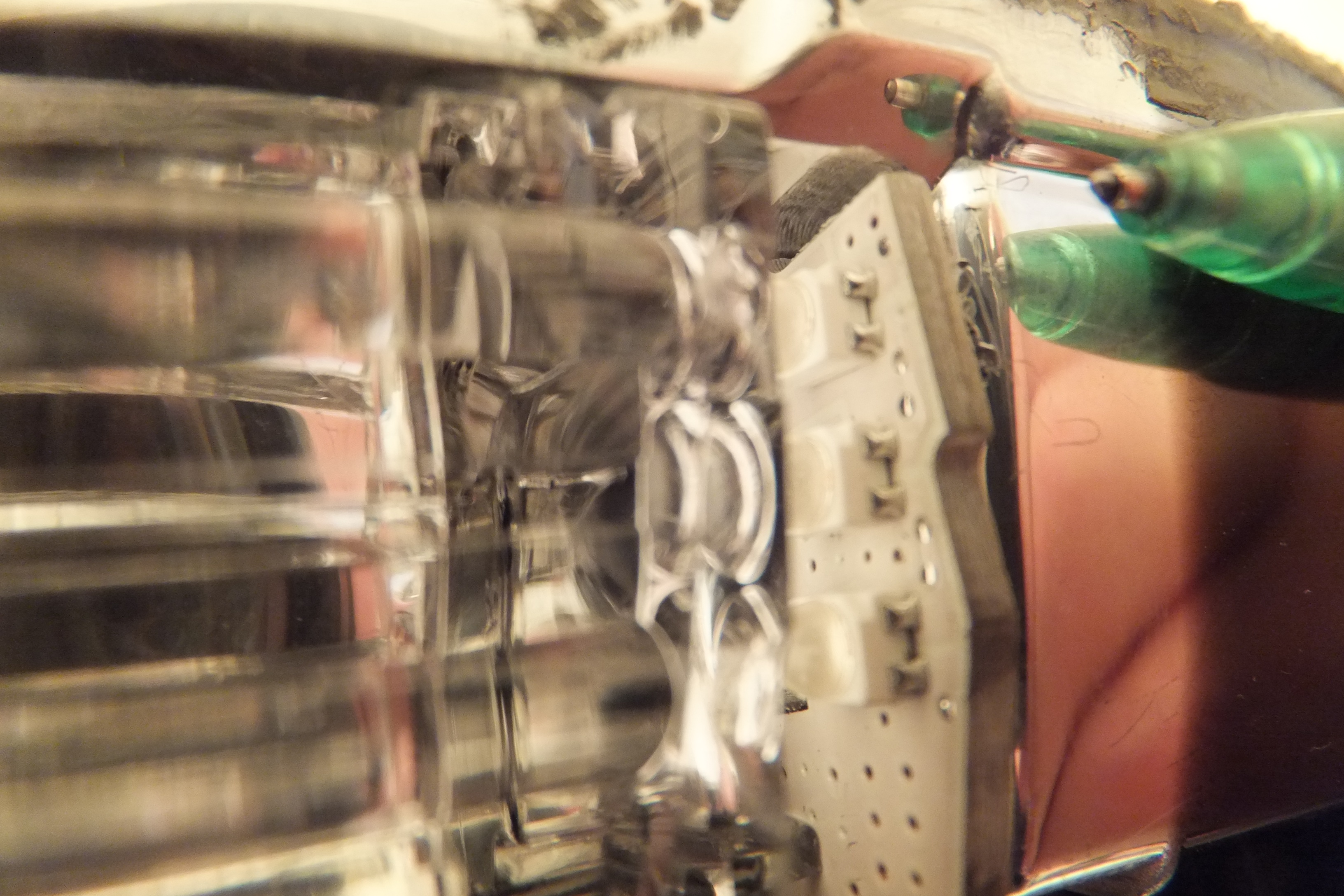

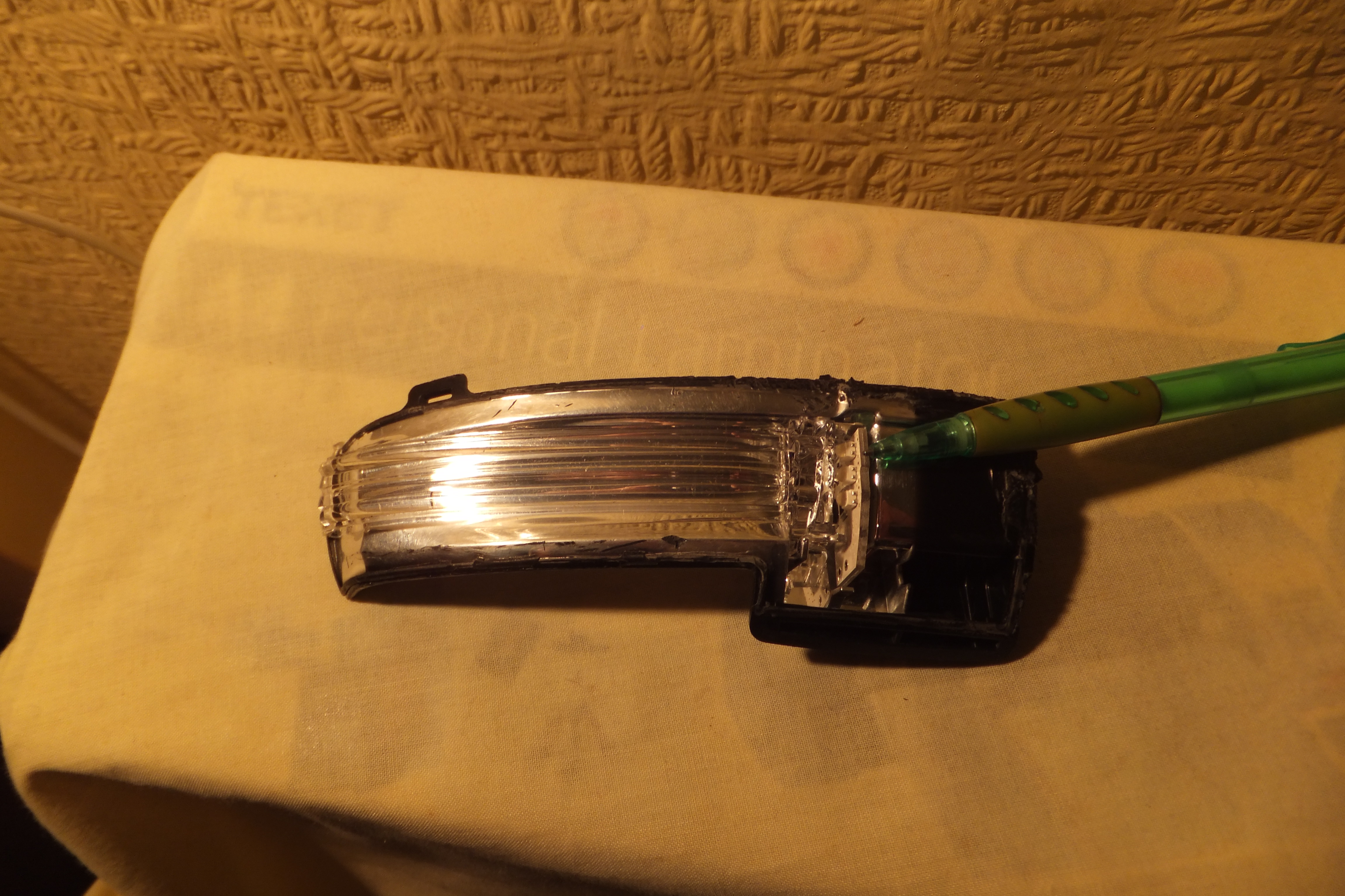

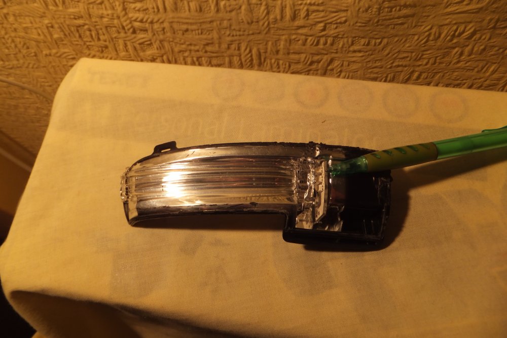

Lens, with socket, removed from behind front plastic cover in base. Green pen pointing at top one of 3 LEDs.  This unit was stuck by glue to the bottom cover all round the edge and sounded like cracking plastic as I prised it away from the base with a screwdriver
Closer view showing LEDs mounted on the little white square bits with 2 silver metal terminals on the top.

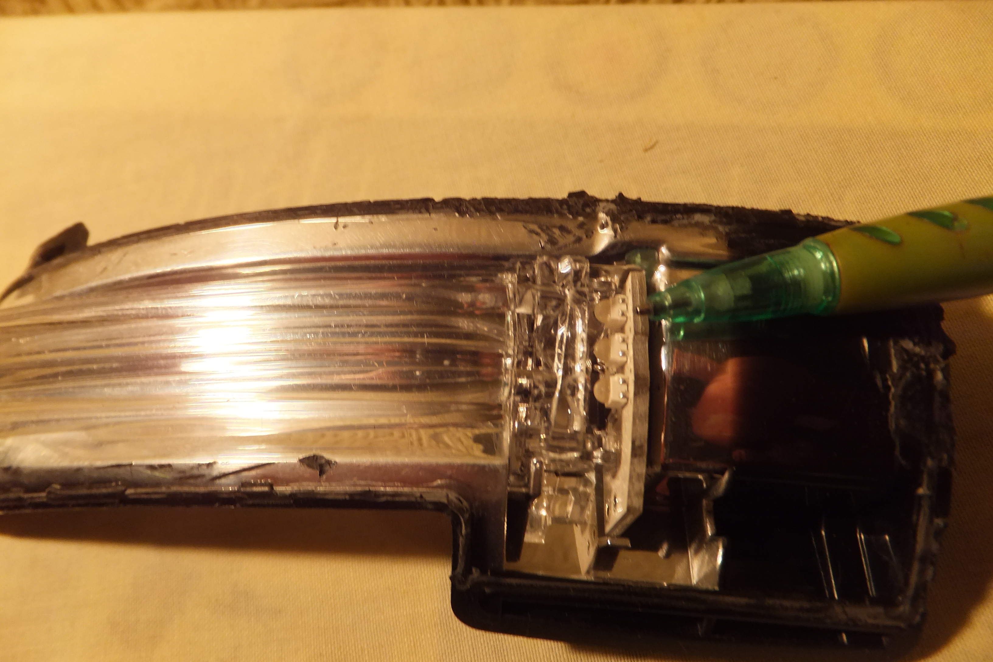

Even closer.  The 3 blurred bits slightly to the left of the LEDs are the round ends of the rounded ribs that run the length of the lens and presumably carry the light along them.
I will try a voltage across the pairs of terminals for fun......but what V?
This seems to be as far as I can go with the dismantle.  The ribbed lens is fixed to the white board the LEDs are mounted on.

I know it has been a long time since this thread was used, but I recently had to change my right hand mirror indicator repeater unit. Having read through the thread it was still unclear how the wiring connector should be removed. If it helps anyone else, I found that inserting the 'tail' of an unused small pop rivet fully into the rectangular hole shown in DensYeti's picture above, the connector virtually fell apart. Hope this may help someone having a similar problem.
