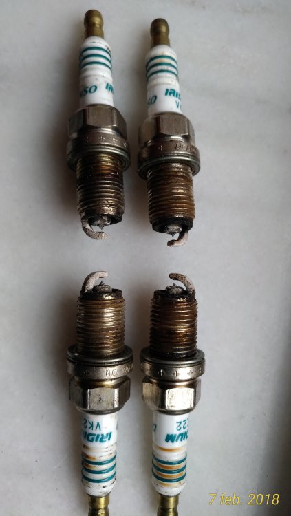

4. Spark plugs change at 90,000 km as handbook states (it says "in addition every 90,000km").
Answer: TRUE spark plugs need replacement at every 90K km mine are Iridium Denso  VK 22 First time I replaced them at 75K km and second time at 88K km interval. picture attached.
