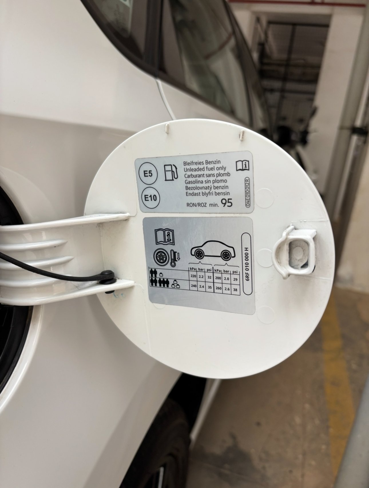

Are 1.0 TSIs fine with RON91 Fuel (Fuel Lid lists min. RON95)
My 2021 Skoda Rapid NA 1.0 TSI (India) lists min. RON95 as required fuel on the fuel lid.
In India RON95 and above are premium fuels while standard fuel is RON91. Premium fuels are expensive to standard by ₹10 - ₹50 per Ltr.
Given the cost difference, most people fill the standard fuel only given the limited FE of 1.0 TSIs. Very few would go for premium fuels.
Will using standard fuel (RON91) effect the running, longevity and performance of the engine? Will they ruin the engine over time?
Experts please share your opinion and recommendations.

For the convenience of everyone, posting the picture of flap for clear interpretation about the VW recommended fuel spec.
Kindly share your recommendations accordingly.
