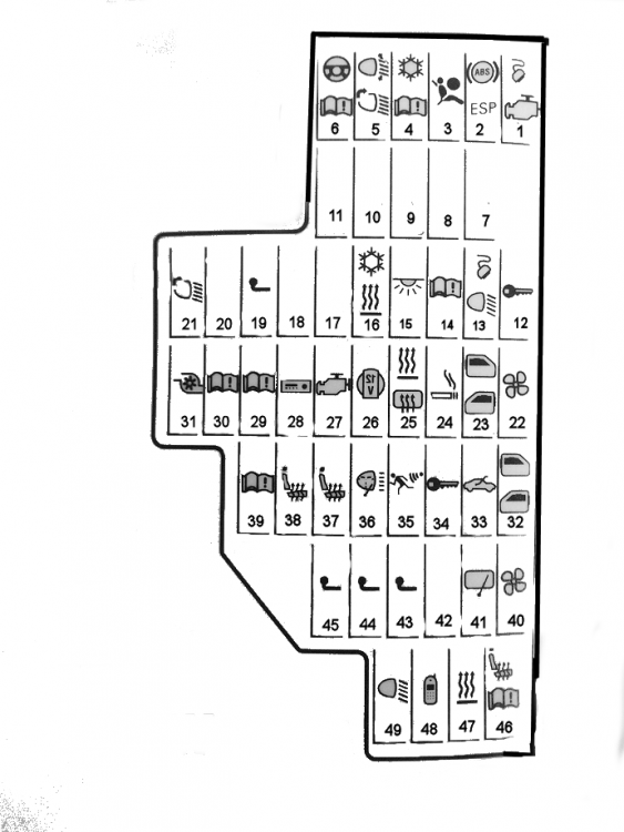

Cheers X Man. If i recall it was in a different location than 41 on the diagram. Will get a photo when its light.

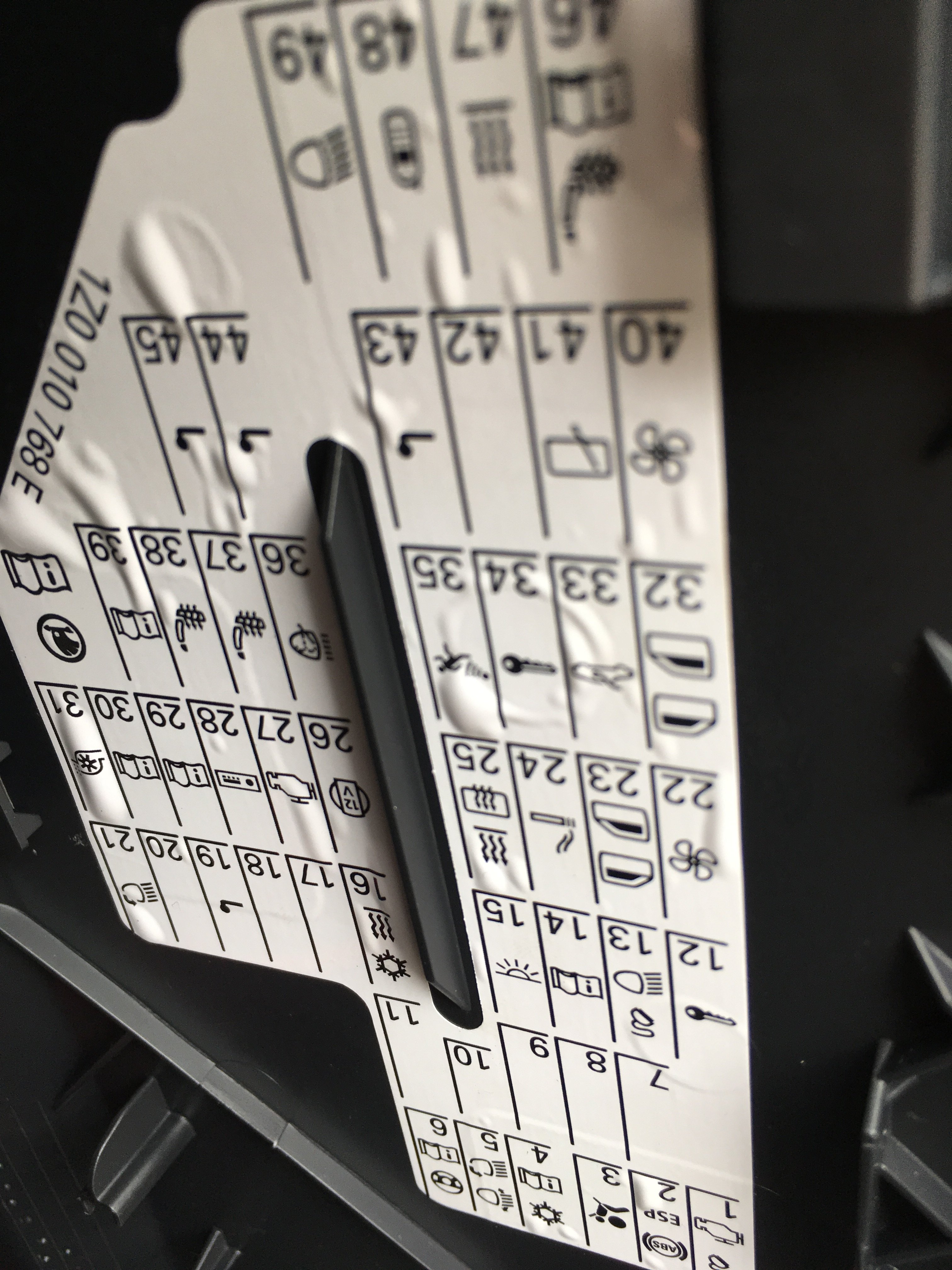

Just saying there are are other blue ones and its very easy to pull the wrong fuse. You say it was in a different location, so I bet you looked at the wrong fuse.
Remember, when looking in the owners manual and a lot of other sources, the fuse diagram is a mirror of what is actually in a RHD car! They are made as if it is mounted on the LHS. Makes it a confusing proposition to work out what even the manual is saying is where sometimes...
I'll take a pic in the morning. From what I remember there was nothing even in the row that the manual suggested.

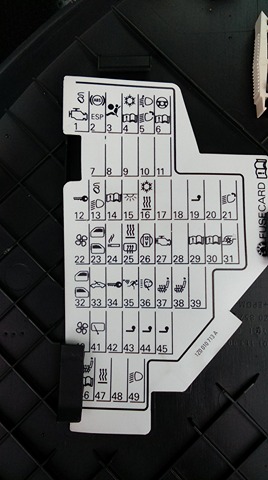

Hi guys,
Here's a pic I just took.
You can see that its not in slot 41 as the card suggests (was like this when I bought the car in May).
Either way the fuse is OK and i tried a new one in there with no difference.
Think its going to be a case of getting to the rear wiper motor to see if its jammed / donald ducked.
Cheers. SJ

Looks to me like fuse 41 is the one with the add a circuit fuse in. Second row up second from right, as said previously it is mirrored to the card so definitely looks like there is a fuse in position 41.

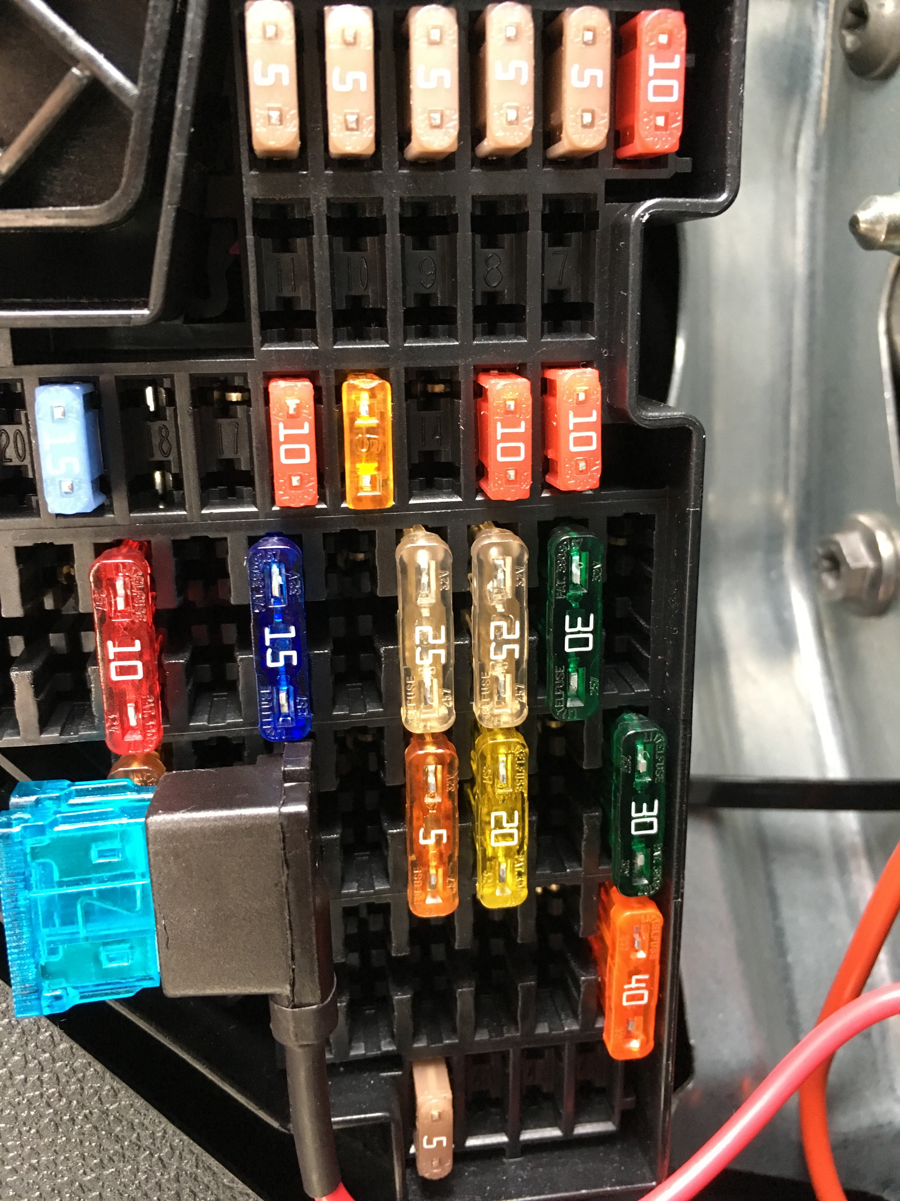

Have looked at the fuse box and it doesn't look like there is one where the wiper one should be...
see pictures attached:
IMG_0999.thumb.JPG.32422aaede16f9b22741f3063fc2aa31.JPGIMG_0998.thumb.JPG.e6f440cdf8036abbb0d7fe74b403c1d7.JPG
Any ideas?

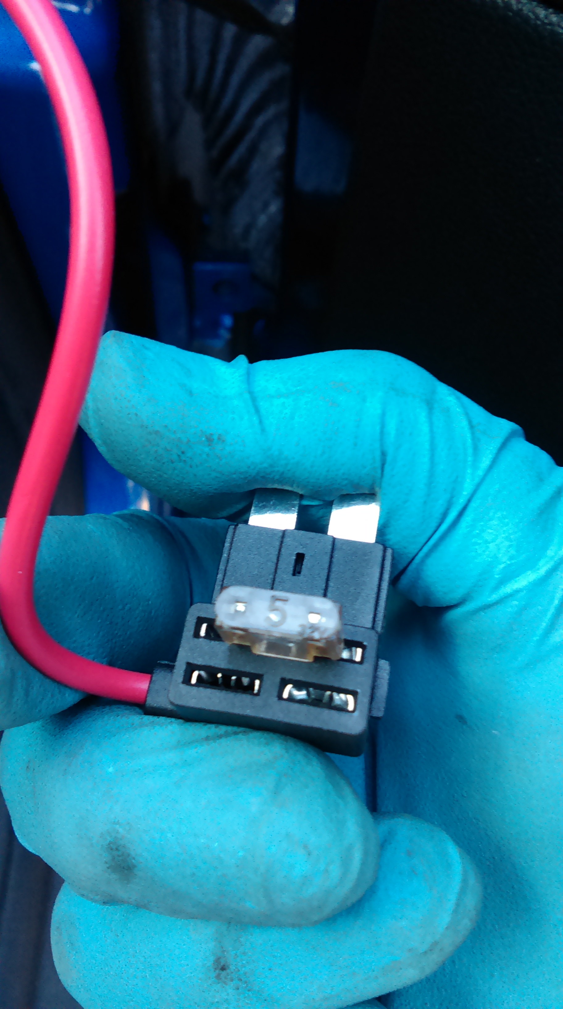

It looks to me that whoever added the take-off point put the fuses in the wrong way round, where you have that 5A fuse should be the 15A as this powers the original CCt (wiper) and the outer position in line with the take off wire should have the 5A as this is for whatever that wire feeds (dash cam?) hence any extra strain on the wiper and the poor little 5A is not man enough and will die

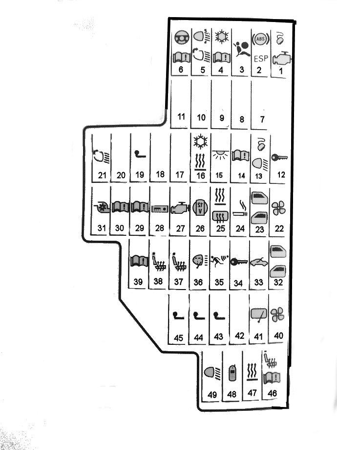

According to this diagram there is no fuse where there should be .
