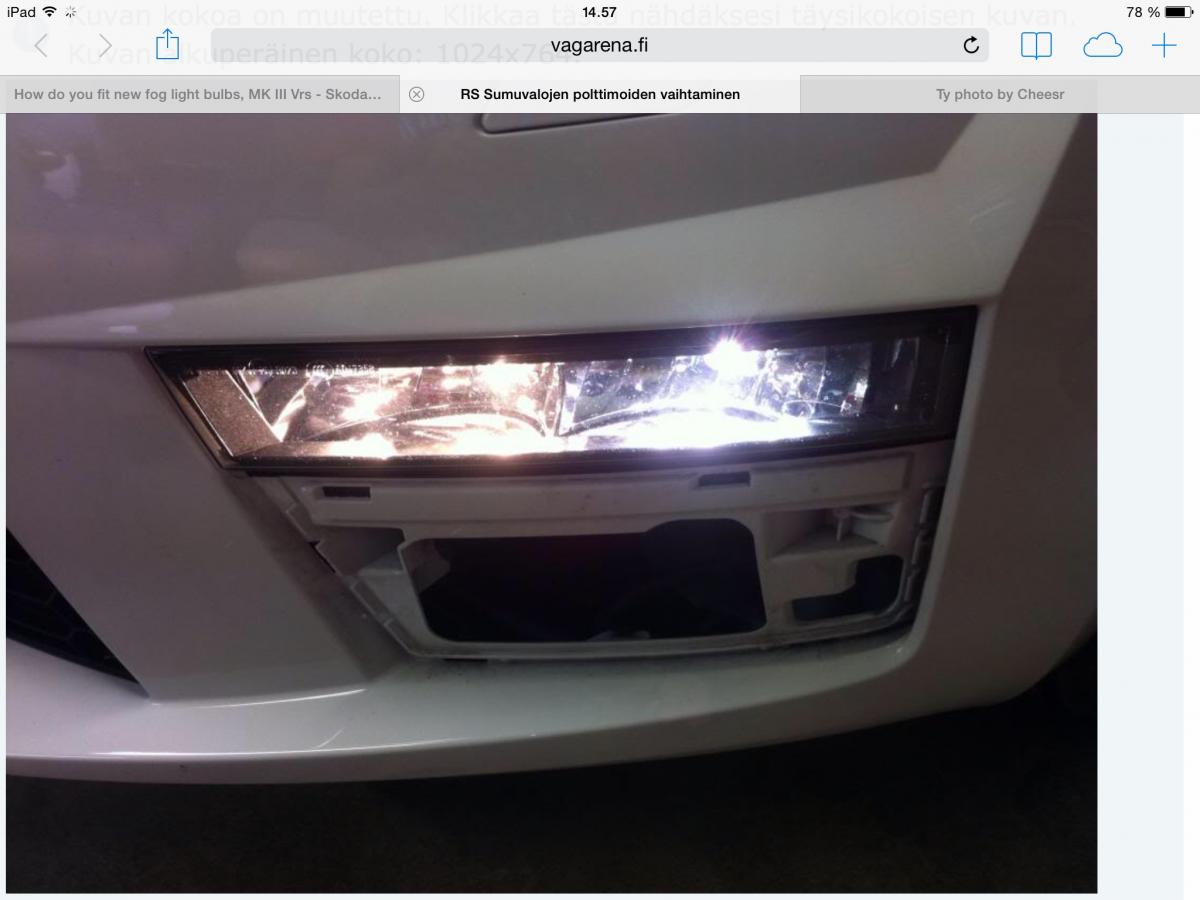

On some models Skoda used access panels to gain access to the foglights and DRL's (daytime running lights) on some older models, but on the Kodiaq there is no reason to gain access as the DRL's are integrated into the headlights and the fog lights are mounted up high.
Image result for skoda fog light bulb change
The only way in will be from underneath by removing the lower engine cover, or through the wheel arch by removing the wheel arch liner or by completely removing the front bumper.
