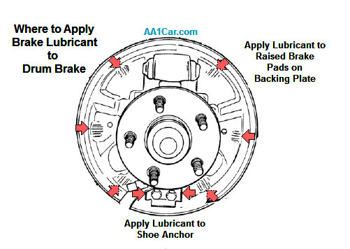

Ok so I looked this up, and now understand. I found this pic
I'll check this on next stripdown, though I was under the impression that the shoes did not rub against the back plate on the Fabia.
  • Sponsor
Those 'raised brake pads' are the plastic discs I'm on about.  On earlier generations of backplates they were indeed just pressed out, raised steel surfaces.
