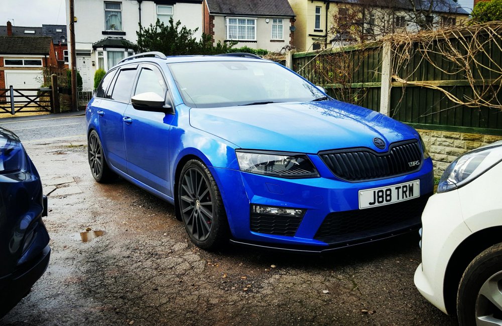

I didn't used any of their bolts. Just got another person to help align the splitter and make sure where it was going then drilled holes straight through splitter into bumper/lip then just fitted self tap screws x14 throughout. Seems solid!

Cheers man! Sounds like a much easier option than trying to fit nuts and bolts. Also, I watched a video where some guy caught the splitter on something and wrecked the bumper because of the nuts and bolts. He said a friend of his did similar but with self tappers and it just pulled out the screws and no real damage to bumper
if you use the bolts you need to remove the engine cowl on the bottom. i used self tappers it took longer putting it on the post lift, literally a 10 minute job all in.

H & R 40mm drop all around with 15mm spacer front and 20mm rear. Stock shocks.

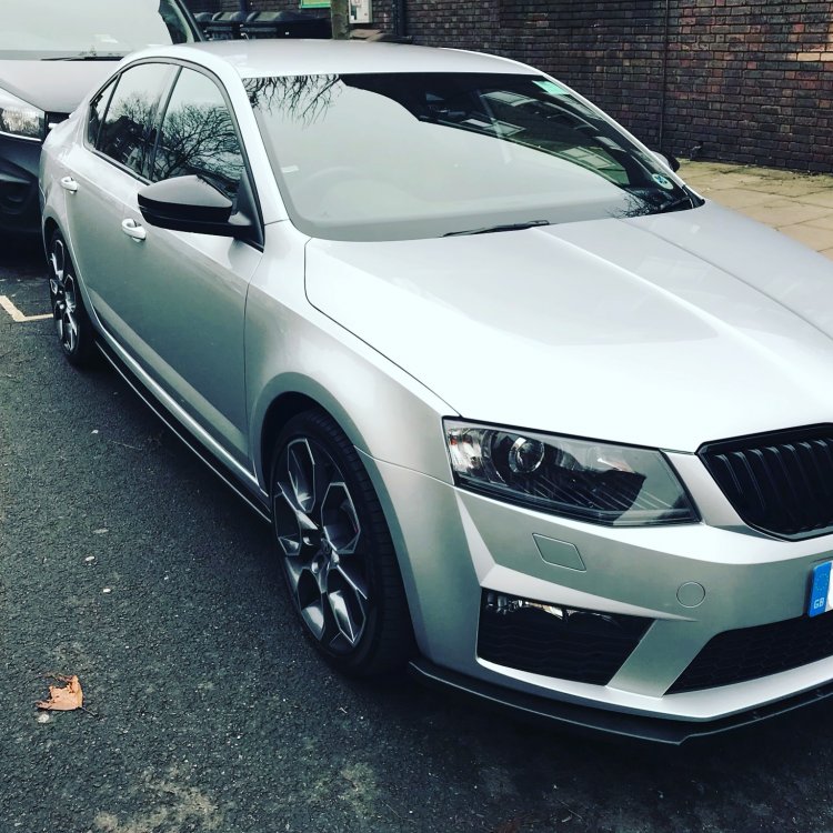

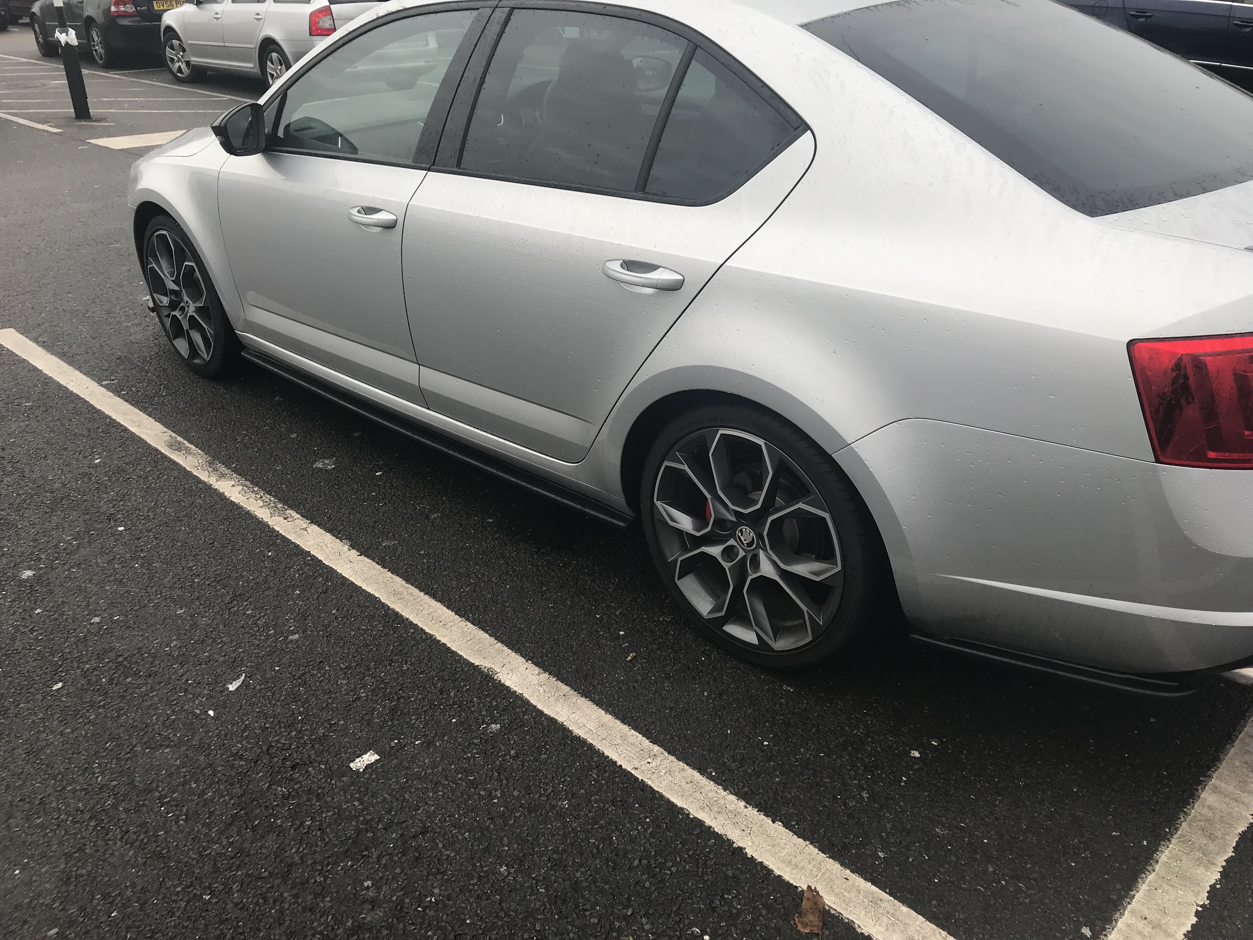

That’s what I have already. The front facing image is with the Spacers. The rear facing image is without.
Edited by Madmax889
Images added

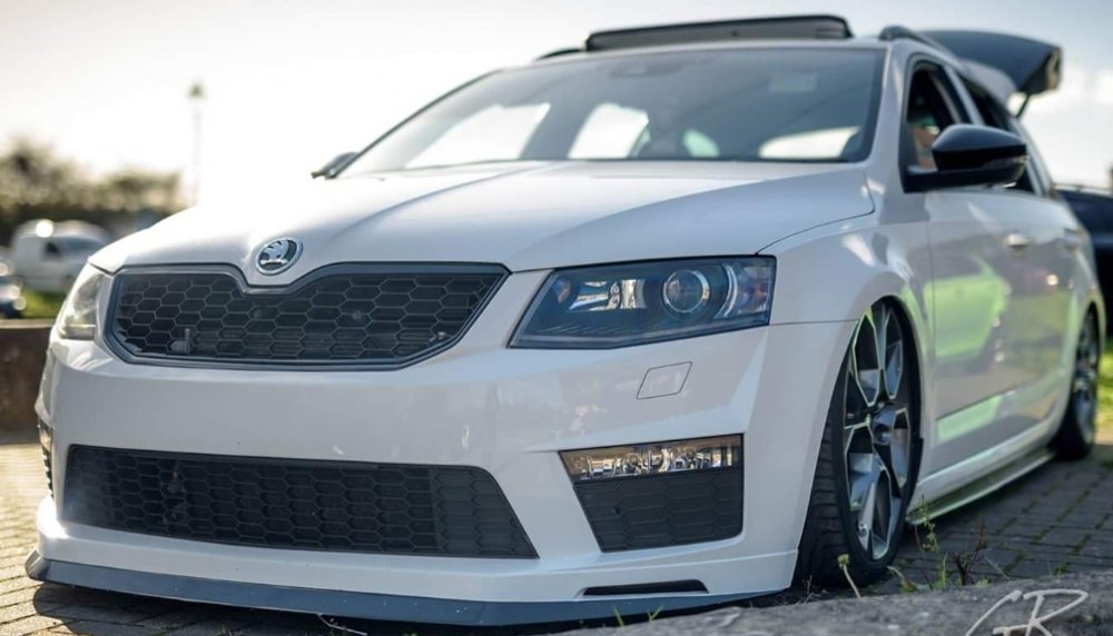

Genuine cup edition splitter and maximum drop :D
Never getting down my road like that mate. Tooooo low
What are the roads at Derbyshire like? That clearance wouldn't be enough for a centipede.

It's on air ride but i still catch the splitter at normal ride height :crying:

Skoda turinis 18*7.5j and on spacers 15mm front and 20mm rear.
It's also on H and R 40mm springs to lower it.
