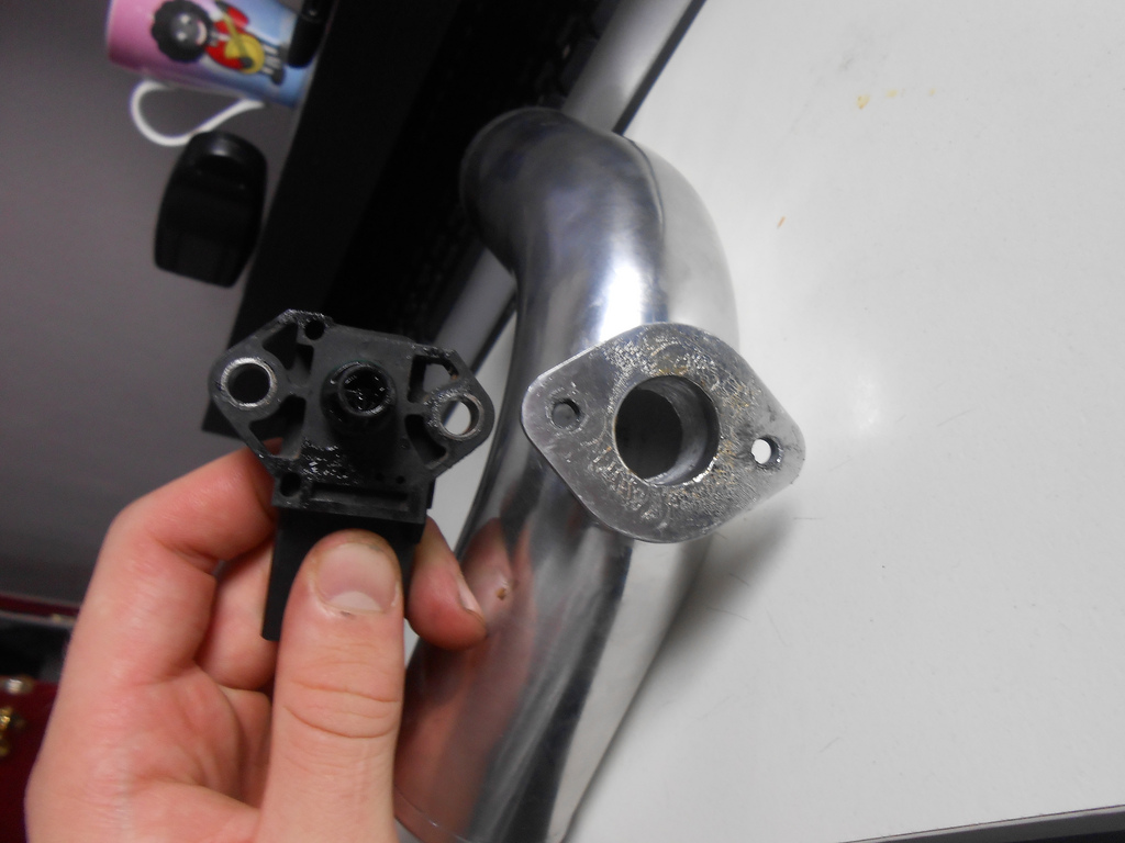

Hi all, got a boost leak on the Fab, all the hoses are clamped up tight however on Boost there’s a loud sort of whooshing sound, much more apparent when the windows are closed! The MAP sensor hole on the Boost pipe is far larger than the MAP sensor itself, would this cause the issue? I’ll attach a video but not sure if you can hear it, easiest way to describe it is like pulling the bung out of an air bed and the air whooshes out

How is the MAP sensor fitted if the hole for it is too big?
Just like this
I would definitely use some RTV if you have no gasket, that tiny O ring is doing nothing and you should remove it so it doesn't come off and get ingested.
Edited by sepulchrave
Sorry what is RTV? That’s not my photo however it’s similar issue
RTV silicon sealant, you must make it airtight.
Okay mate thanks, I have Hylomar Blue I’m guessing that’s no good?
Not ideal because the MAP sensor is plastic and hylomar is solvent based.

Woo boo, Boost Leak fixed, the boost pipes come with a MAP sensor attached I didn’t know if it was 4 bar sensor or whatever so put my sensor in place to make sure, not realising that it had a reducer plate attached to it so it takes up the 18mm hole in the Boost pipe reducing it to 12mm, Boost Leak seems to be gone! However we’re only holding 25ish psi according to my gauge so possibly got a small boost leak somewhere else or the VNT isn’t set up properly! Need to find out which if I find someone with VCDS lol
