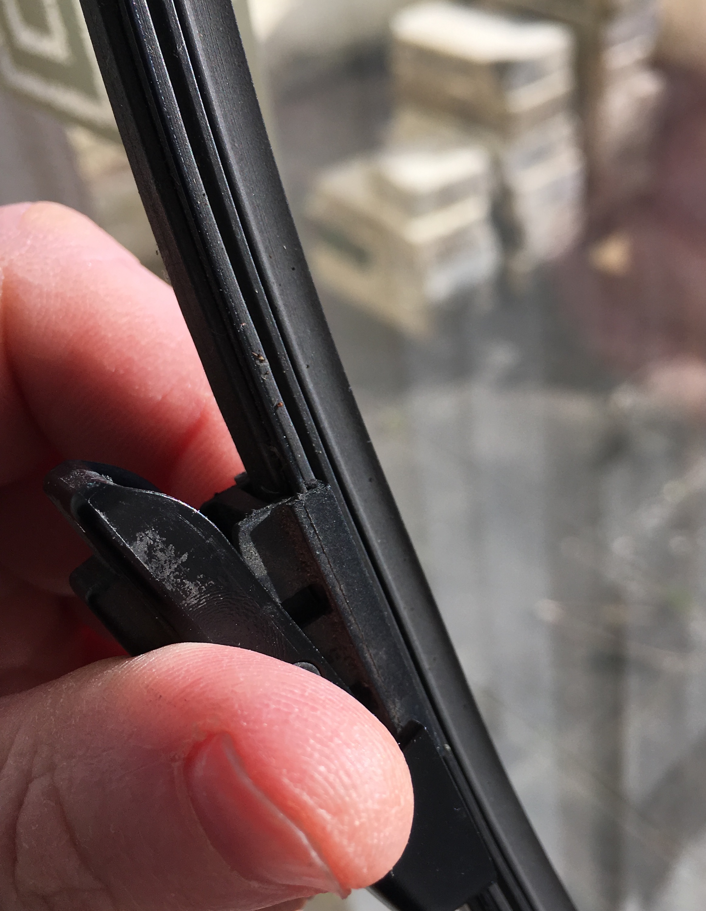

Going just fine on the front - but the rear hatch wiper starts the juddering after about 6 months in. The new, original ones did the same. Which is why I replaced them - not worn appreciably. Just the durn judder. So I just "weathered" the noise and limited my use of rear wiper. Always use the washer to trigger the rear wiper. Always judders.
Historically - just a quick bendy of the arm was enough to stop this - but the plastic arms don't seem amenable to coaxing !
Back seat passengers always jump when the rear wiper comes on!
So - just splashed out on a some new ones - Bosch of course this time - from Wiperblades.co.uk (excellent experience dealing with them - the very helpful Oliver sorted out a mush that I made with the order - got the Hatch ones by mistake and re-ordered the Combi ones - anyway, Oliver sorted it ! All good.)
So - the timer is running on this Bosch blade. MTBJ - Mean Time Before Judder.  But expect them to stay flexible/pliable for longer. We'll see.
The old ("Skoda") blade has a "set" on the rubber which points into the direction of travel from park position. (Pic 1)
Maybe it's the cold weather, that the rubber is not as flexible, and holds that "set". But both Skoda sets have been like this at any time of the year.

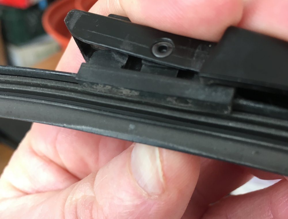

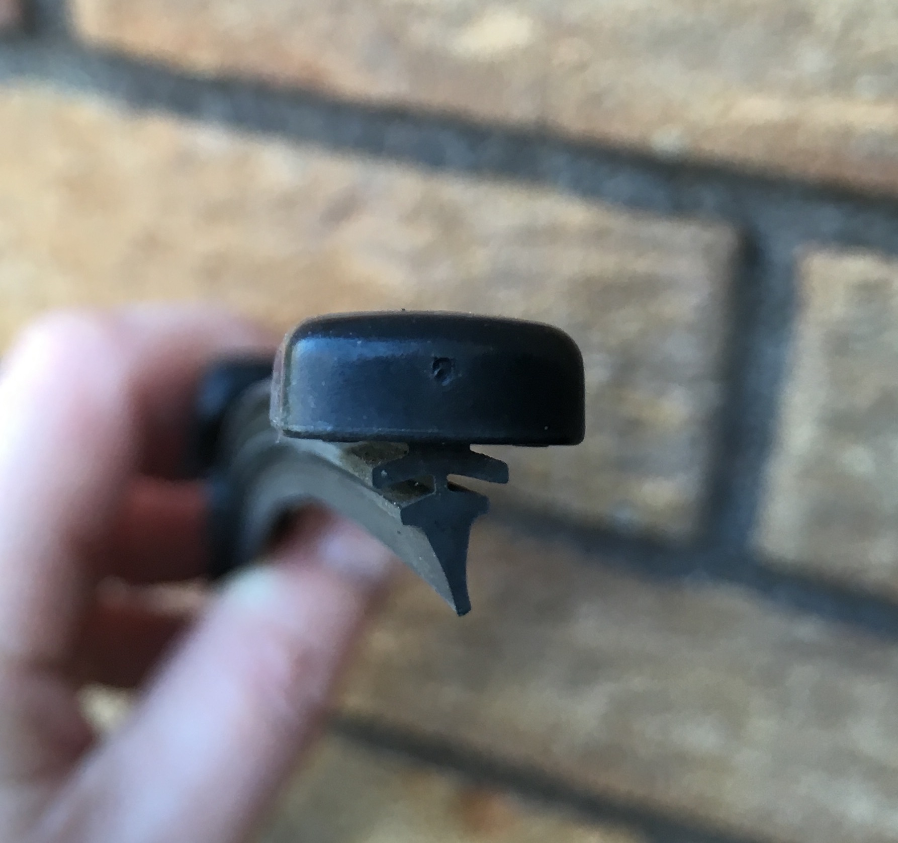

Also, there's a lot of wear at the point where the blade connects onto the arm, (Pic 2) which is understandable - but it means that the blade really digs into the screen on the up-sweep (Pic 3 shows the opposite side ).

PS Is that a stack of gold bars behind the wiper blade in picture 3 ?
Yep AG,  I keep the bullion out the back.   Well spotted.
Actually - that's the remnants of my garden wall - the high winds blew the wall down a few weeks ago. Lousy build quality - and next door neighbour had bolted big timber panelling onto their side - downwind !  So - I was gathering the remnants together before getting to re-build. Damn thing took out  400 litres of rainwater tanks as well. The tsunami cleaned up my patio. Grrr.
