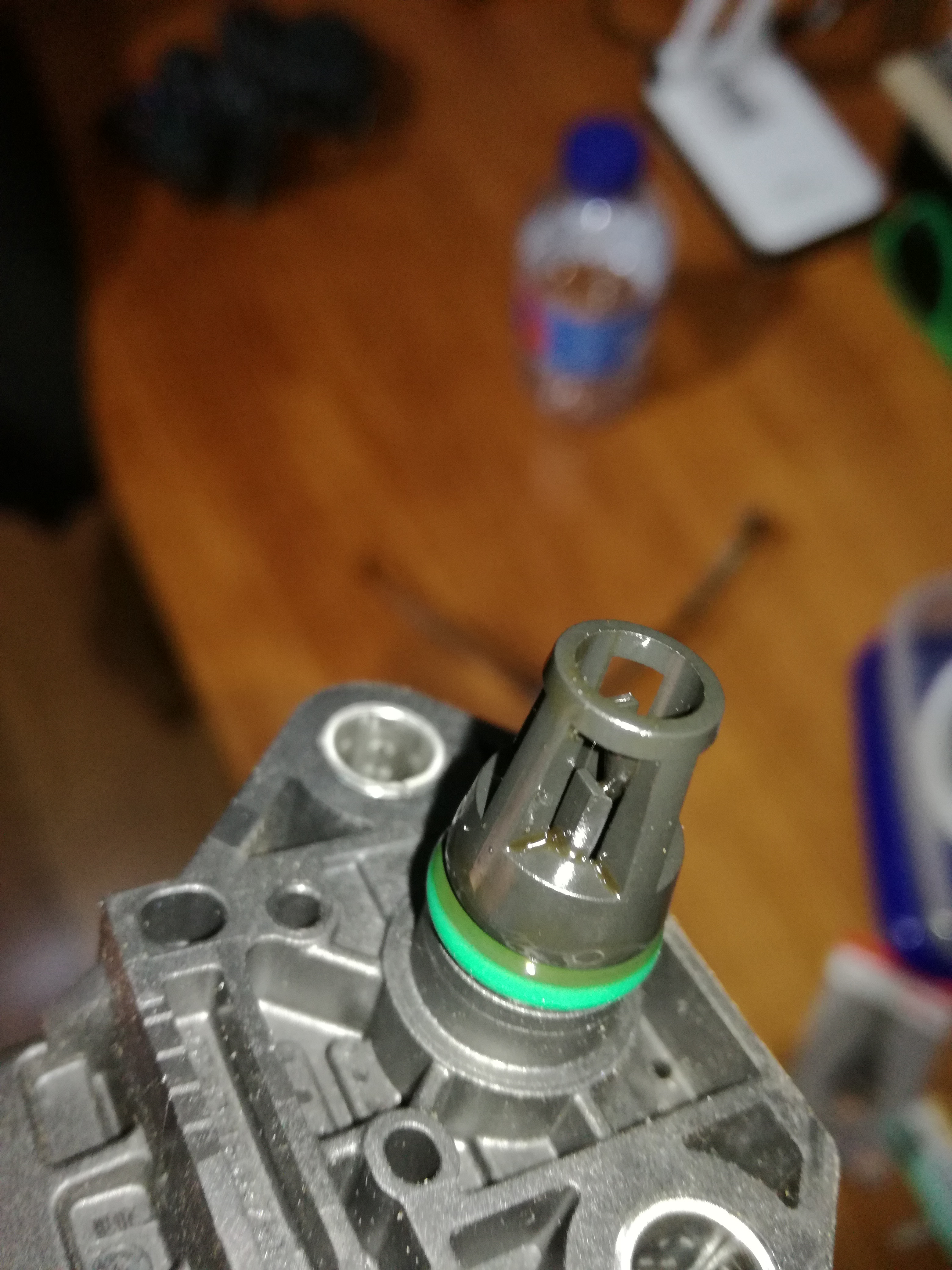

Also, cleaned map sensor... Was this done properly? It may have been better fitting a new one.
I used electrical contact cleaner that is plastic safe, this is what it looked like before, it had no gunk but had some oil on it

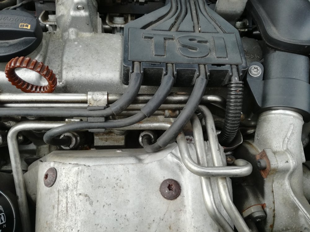

The one that failed is the one with the protection, and the others look ok from the outside, or is there a better way to check them ? IMG_20180207_145957.thumb.jpg.8905edbf35375c9f6d48b40dac0fa4ff.jpg
Check number 3, that one usually fails because its resting on the exhaust shield. Pull it off at both ends ( use a proper spark boot puller - do NOT try to pull using the lead) and use a multimeter to check its not open circuit or very high resistance. Should be around 9kohm afaik. Examine for black marking on the insulation.

I am very aware that some sensors have an extremely fine wire, like a hair, inside and this can be damaged so easily. Not sure about this one but you could have cleaned it to death!
The ones with fine wire are MAF sensors, and yes I'm aware but I think mine is fine as the readings seem normal and no codes so far.

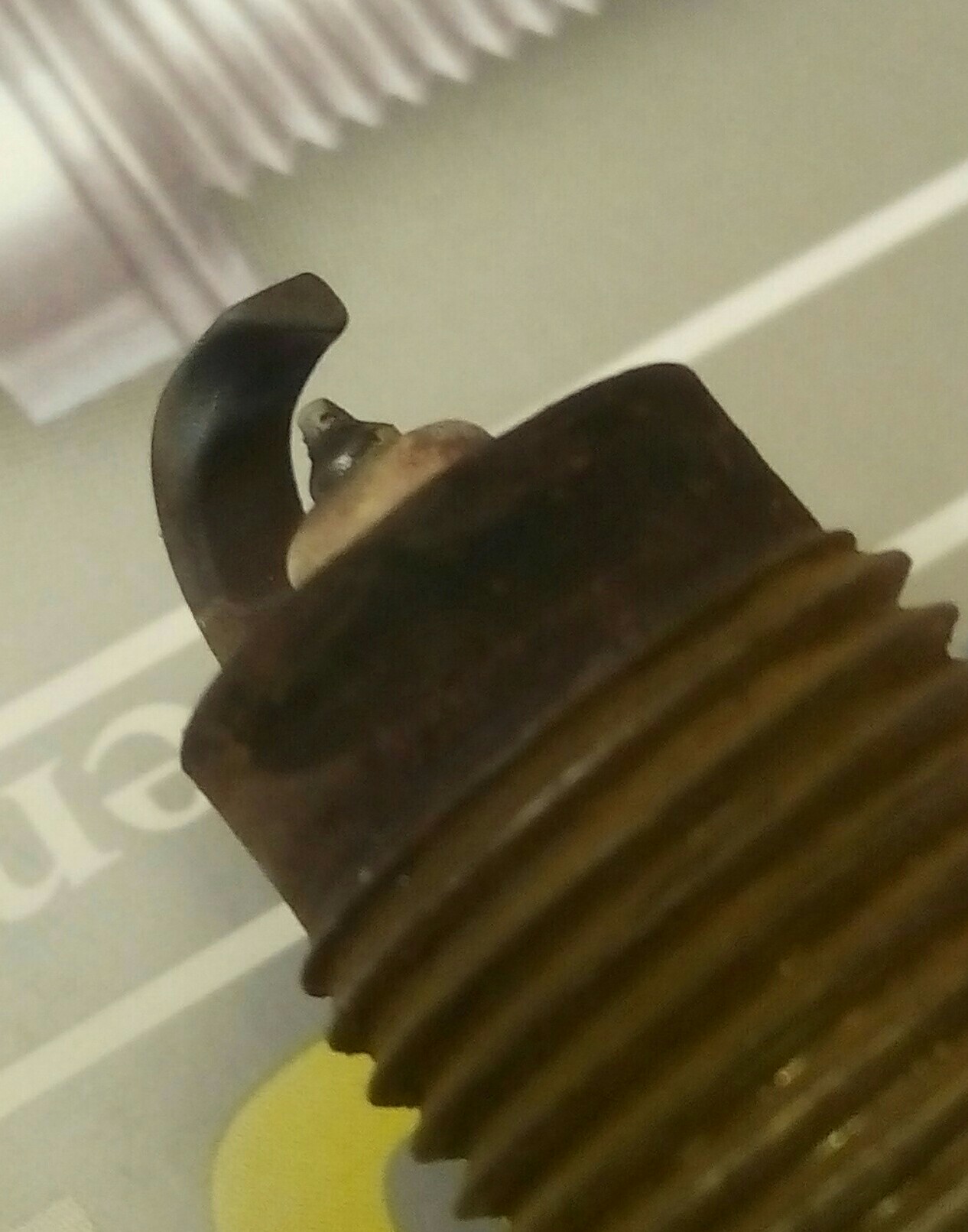

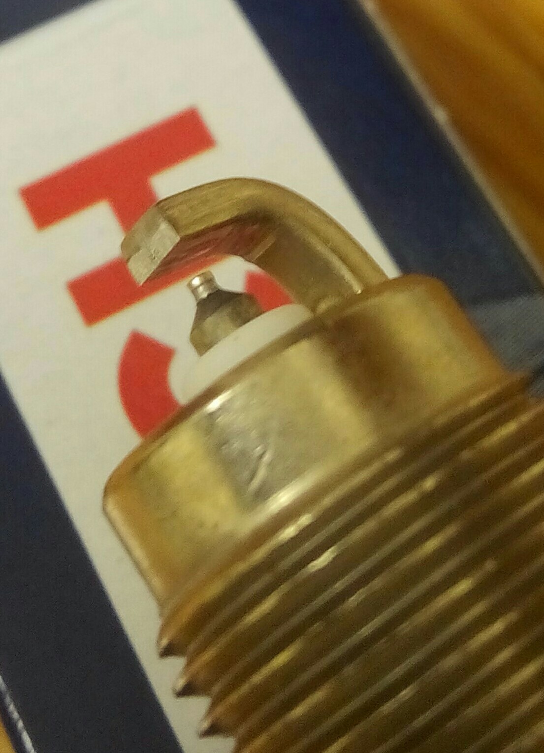

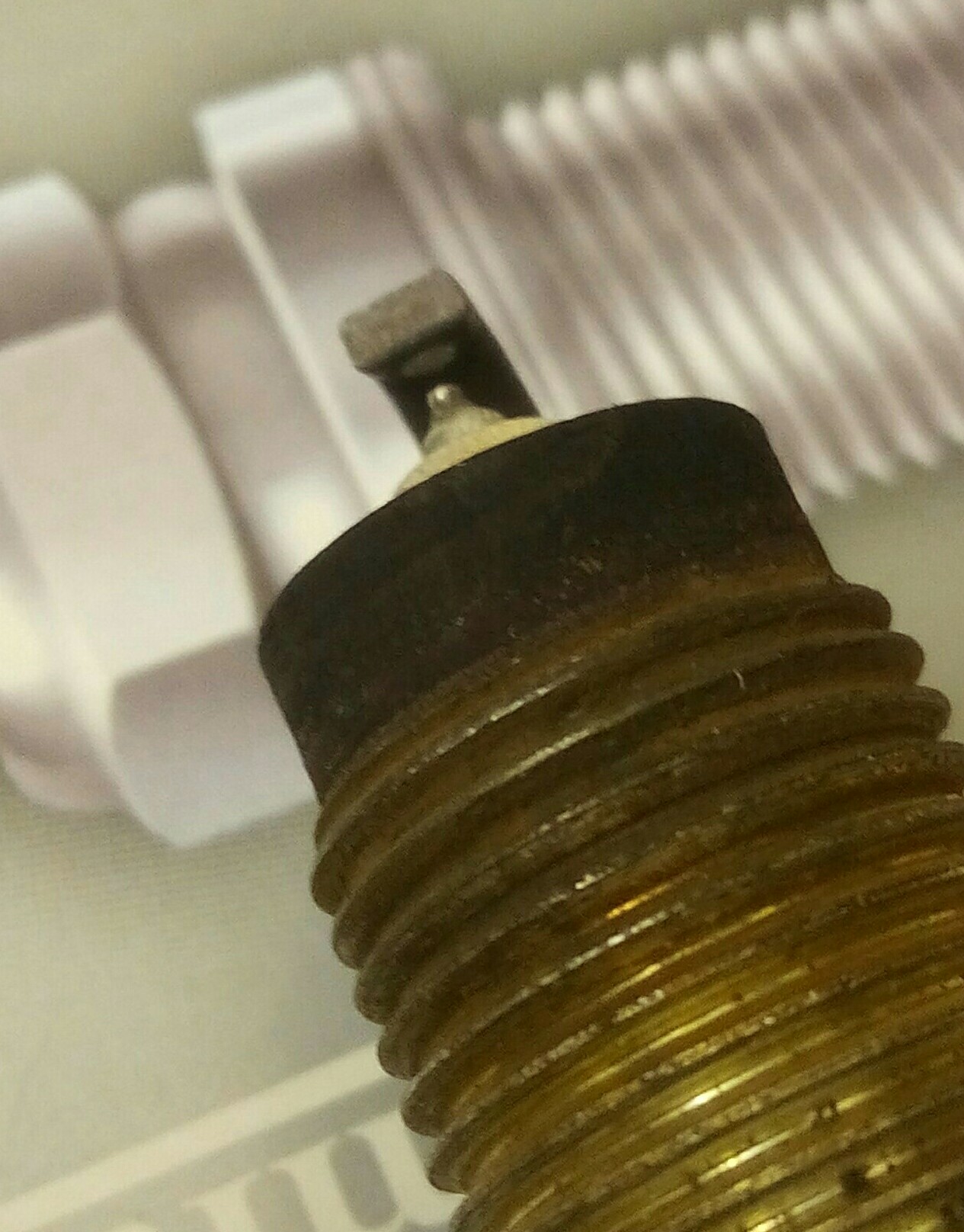

I inspected 8 NGK plugs (one set run 56k miles the other 85k miles) and the one weak point of the NGK seems to be the laser welded attachment of the small platinum disc on top of the ground electrode. The ground electrode wears away from one side and ultimately the microscopic disc detaches (happened in 2 of the 8 plugs, the ones that did 85k). Didn't stop them working though. On the Bosch the platinum bit is inset in the ground electrode and imo likely to survive longer than the NGKs. However not sure if the heat range is identical. We'll suck it and see......
In all cases the iridium tip on the centre electrode showed very little wear. 3 out of the 8 plugs were excellent showing very little wear at all.
No. 4 cylinder 85k miles 1.2tsi platinum disc on ground electrode intact, best example
No. 3 cylinder 85k miles 1.2tsi ground electrode worn, platinum disc missing, worst example
Bosch plug with platinum inset into ground electrode

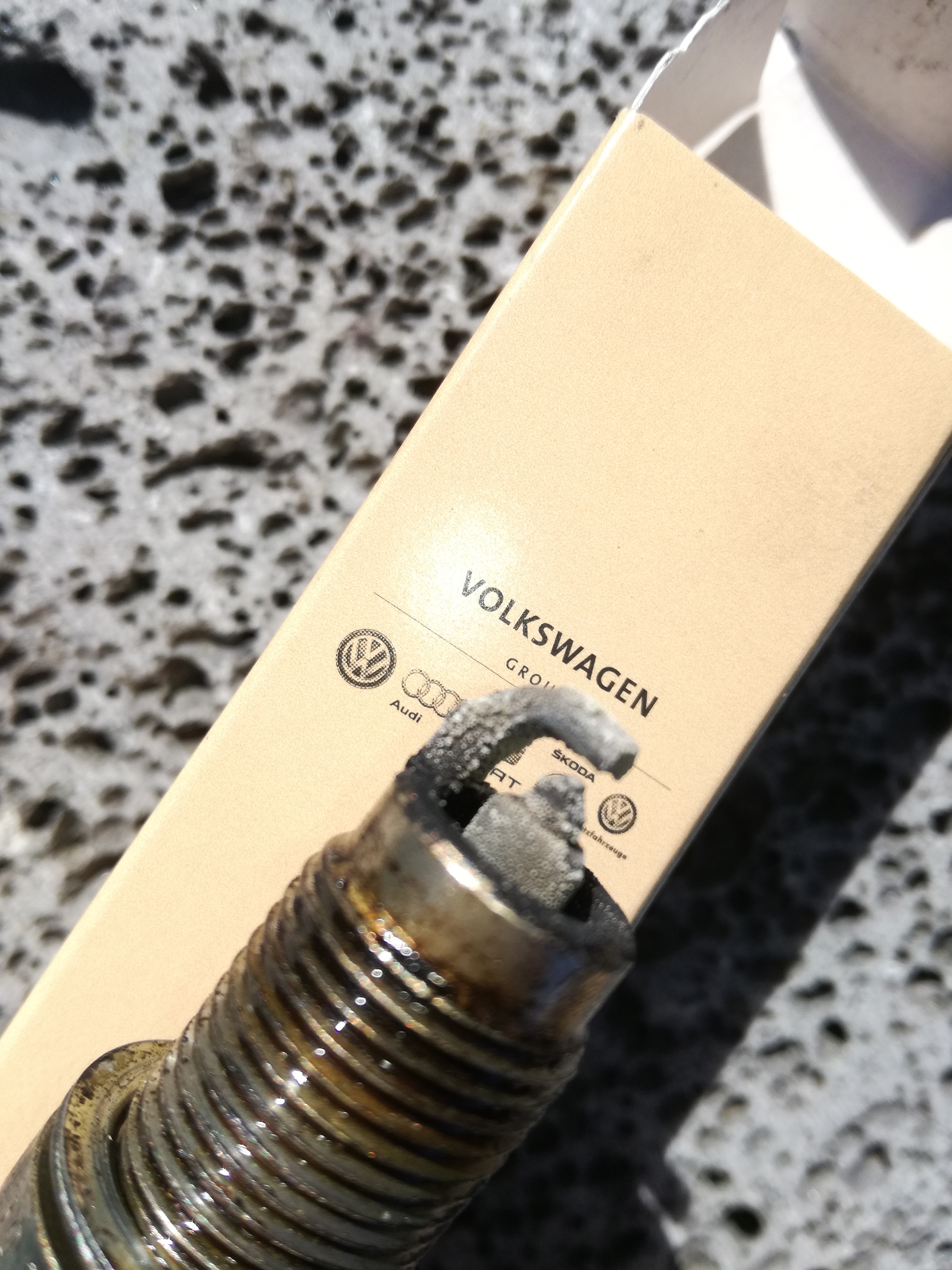

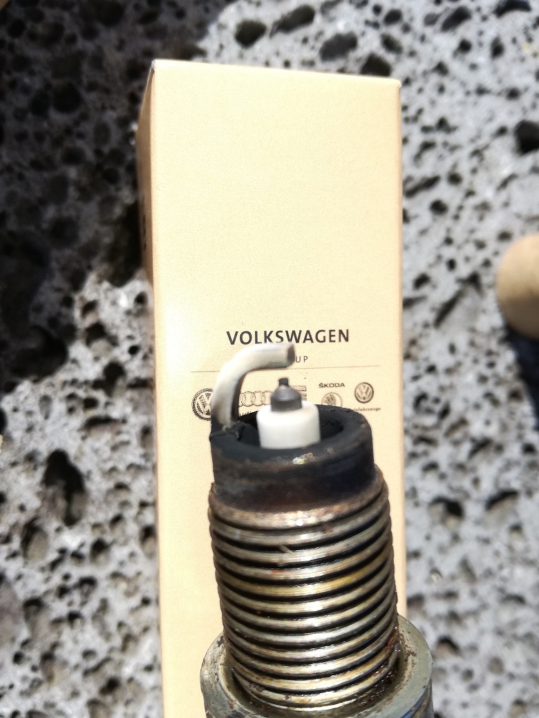

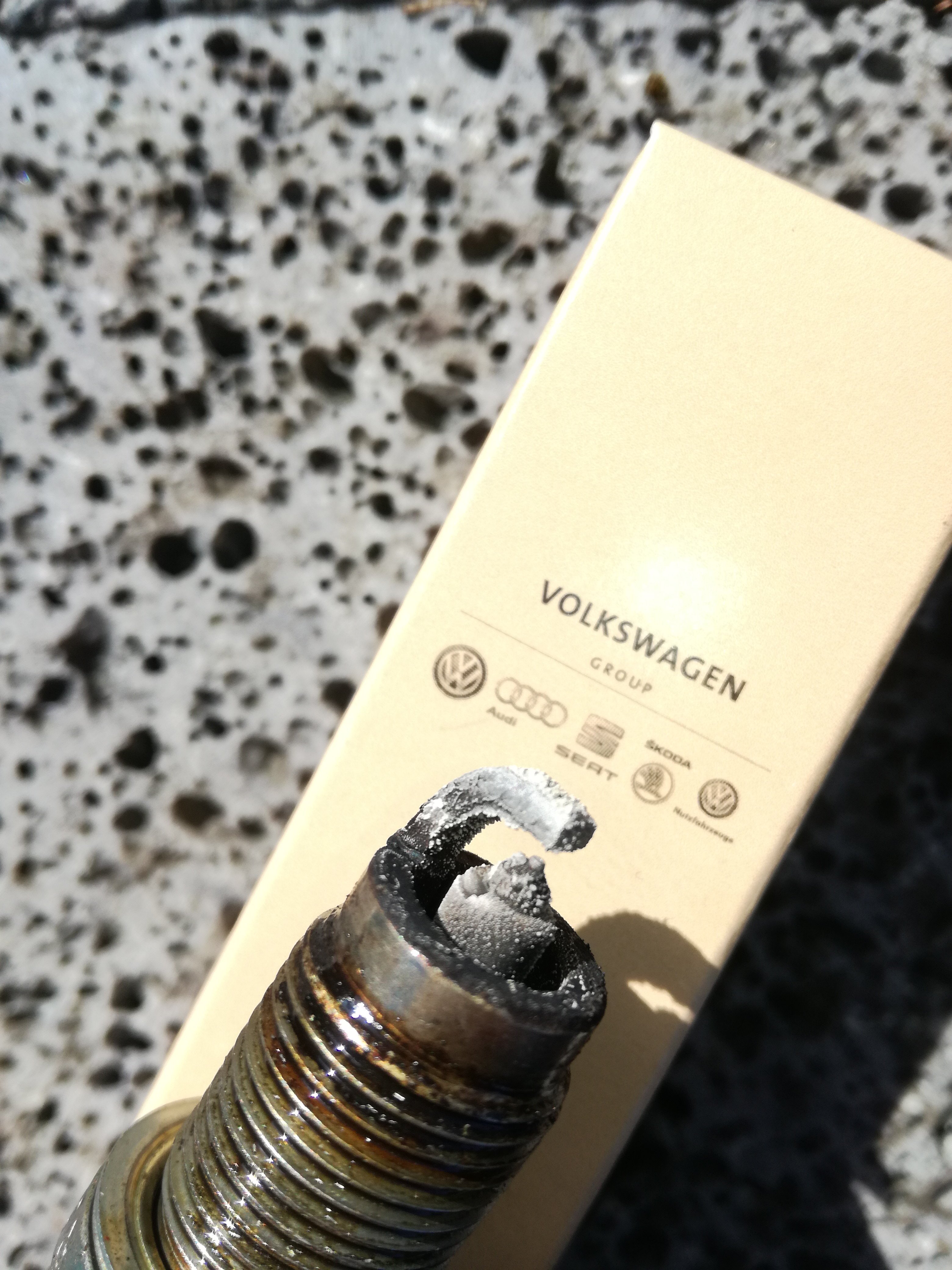

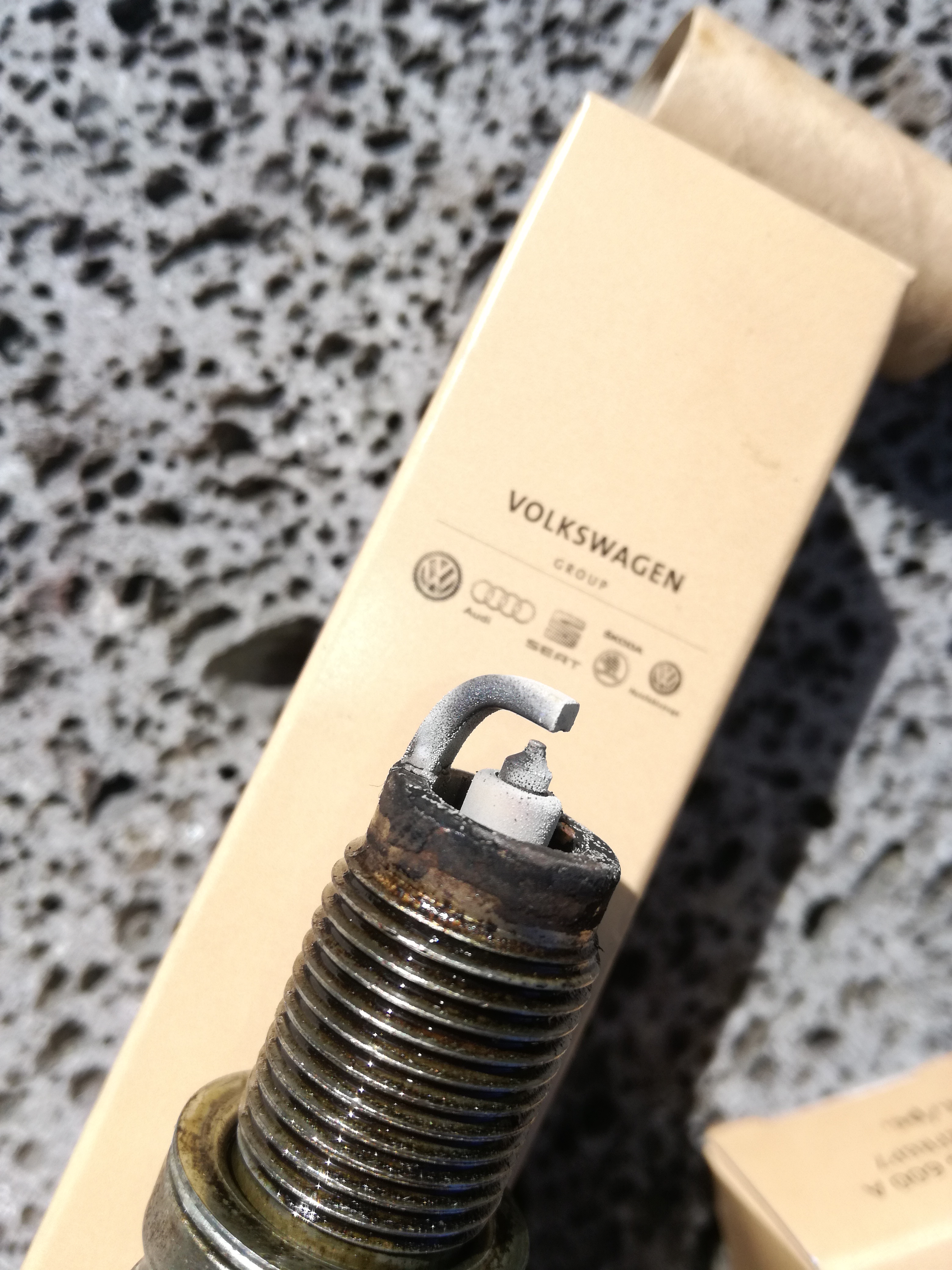

So today had a lot of misfires, dropped by the garage and went for a test-drive, misfires occurred on cylinder #1.
Last time my cable nº4 failed and was replaced, and the sparkplug for that cylinder, I thought they had changed all of them, so here are the plugs.
cylinder nº1
cylinder nº2
Cylinder nº3
Cylinder nº4
Ugly. How long have those plugs been in?
Mixture is running too lean and/or plugs running too hot. What plugs are they?
Plus lots of oil on the threads. You look as if you have a developing problem. They should come out dry, like mine.
And what kind of garage would replace just one plug? They obviously didn't even remove and check any of the others.
You've received very poor service.
Edited by xman
Getting worried :sweat: I dont know for how long, I bought the car with 35k miles, and the plugs aren't oem, they are bosh so they cant be for that long?? , It now has 45k miles, the plug they changed was roughly 6-7k miles ago so I dont know what to take from this, and if plug nº4 should be worse or better with 6k miles (considering the others).
Any advice on what to make of it and what to check? Thank you

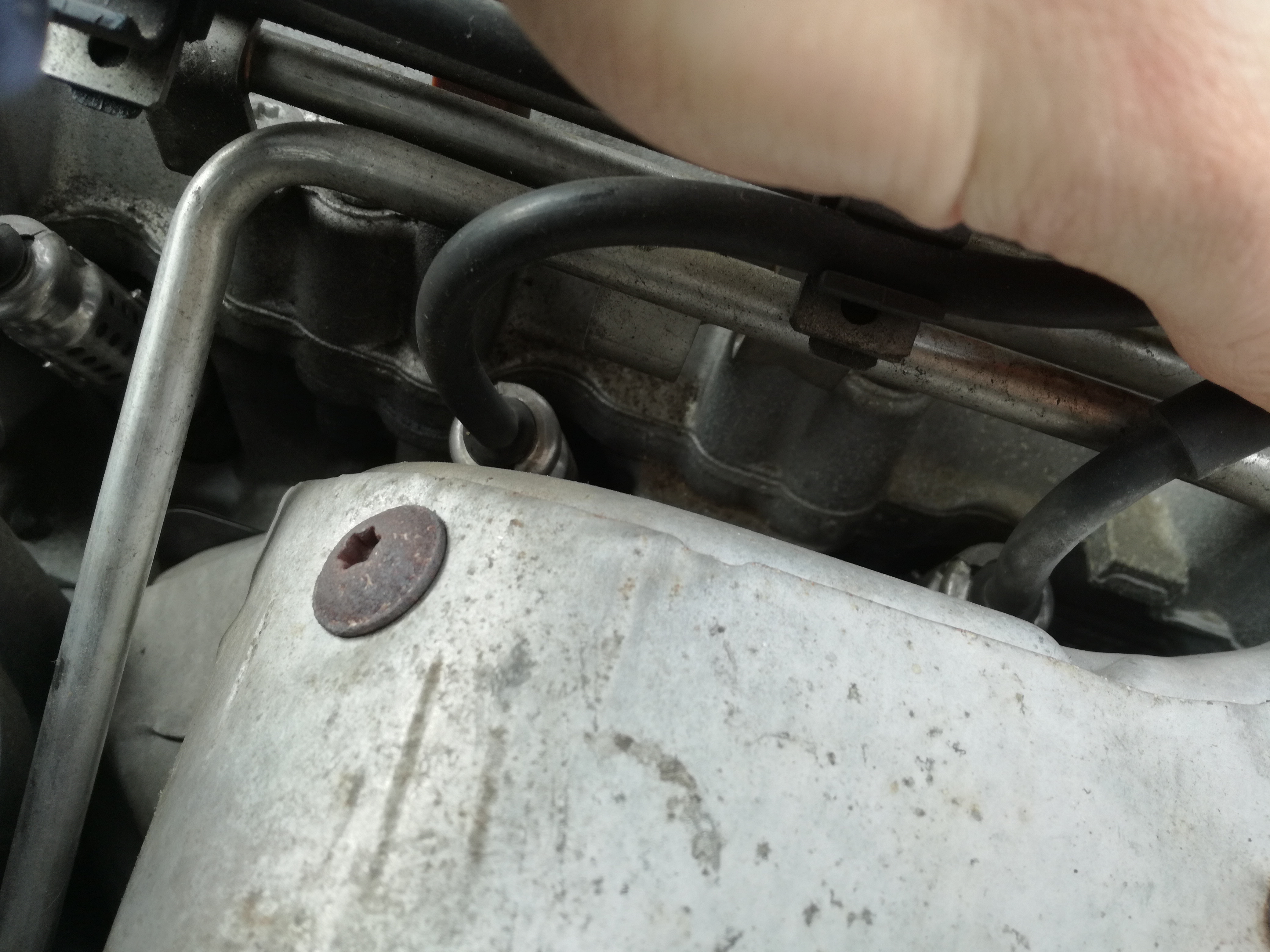

I'll take pictures of the lead nº1 and of the plugs to see if there are any clues.
Edited by Filipelol
Dont know if could matter but I had the pcv pike broken since I bought the car, who knows for how long it was like that, and was using 5w30 oil, pcv fixed and using 5w40 now, can the oil be cause from a bad valve cover seal?
