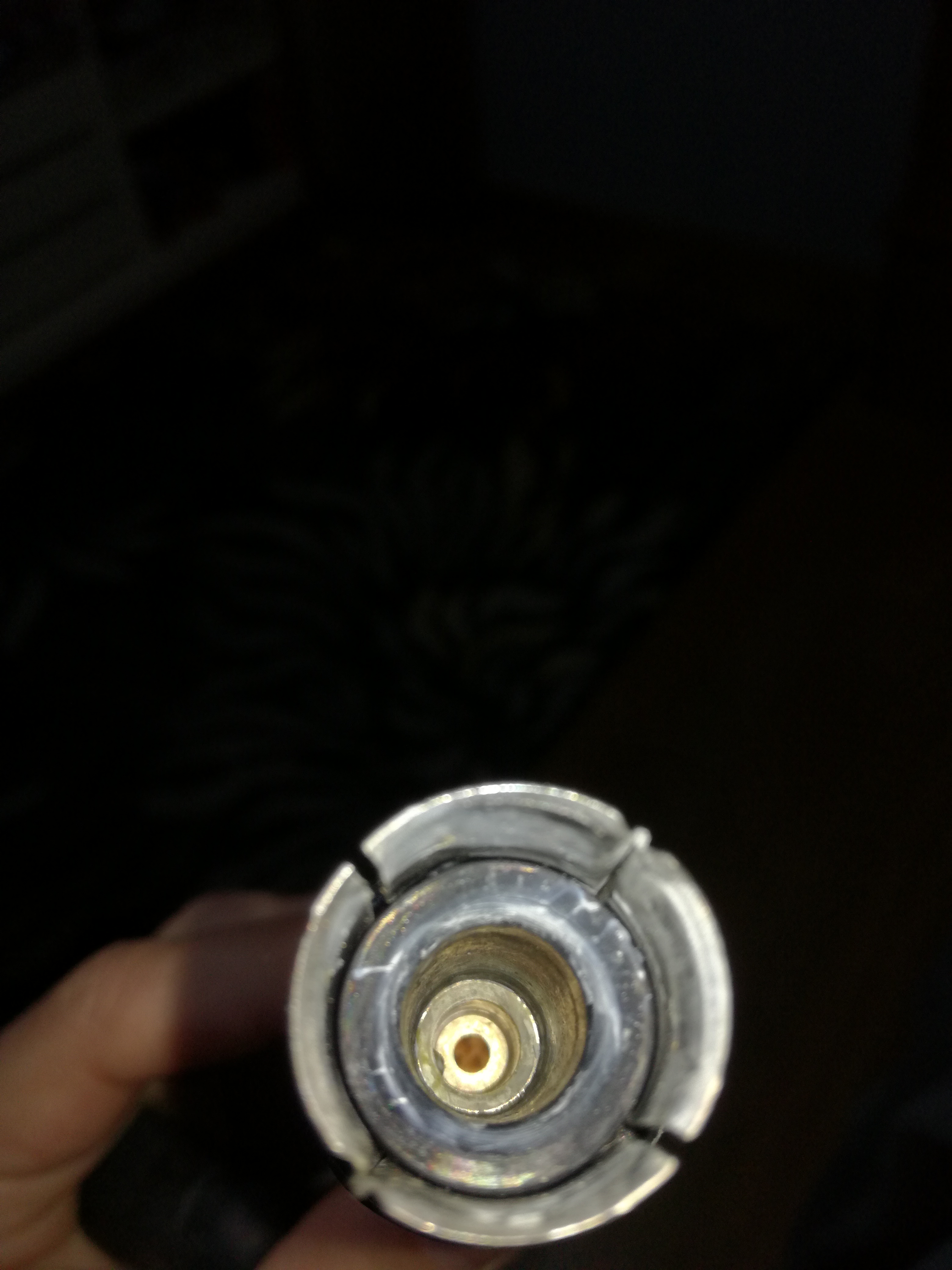

Lead nº1, anything wrong with it?
IMG_20180220_205623.thumb.jpg.105fbf3d6f0cb271b7745bc3a215eba7.jpgIMG_20180220_205539.thumb.jpg.86fc18930851f3afc6441d16febca1ce.jpgIMG_20180220_205153.thumb.jpg.9fb79e25361f49b4e34f5a171a1200cb.jpg
And also, the plugs and lead nº1 being changed didnt fix the cold start issue.
Pcv shouldn't make any difference.

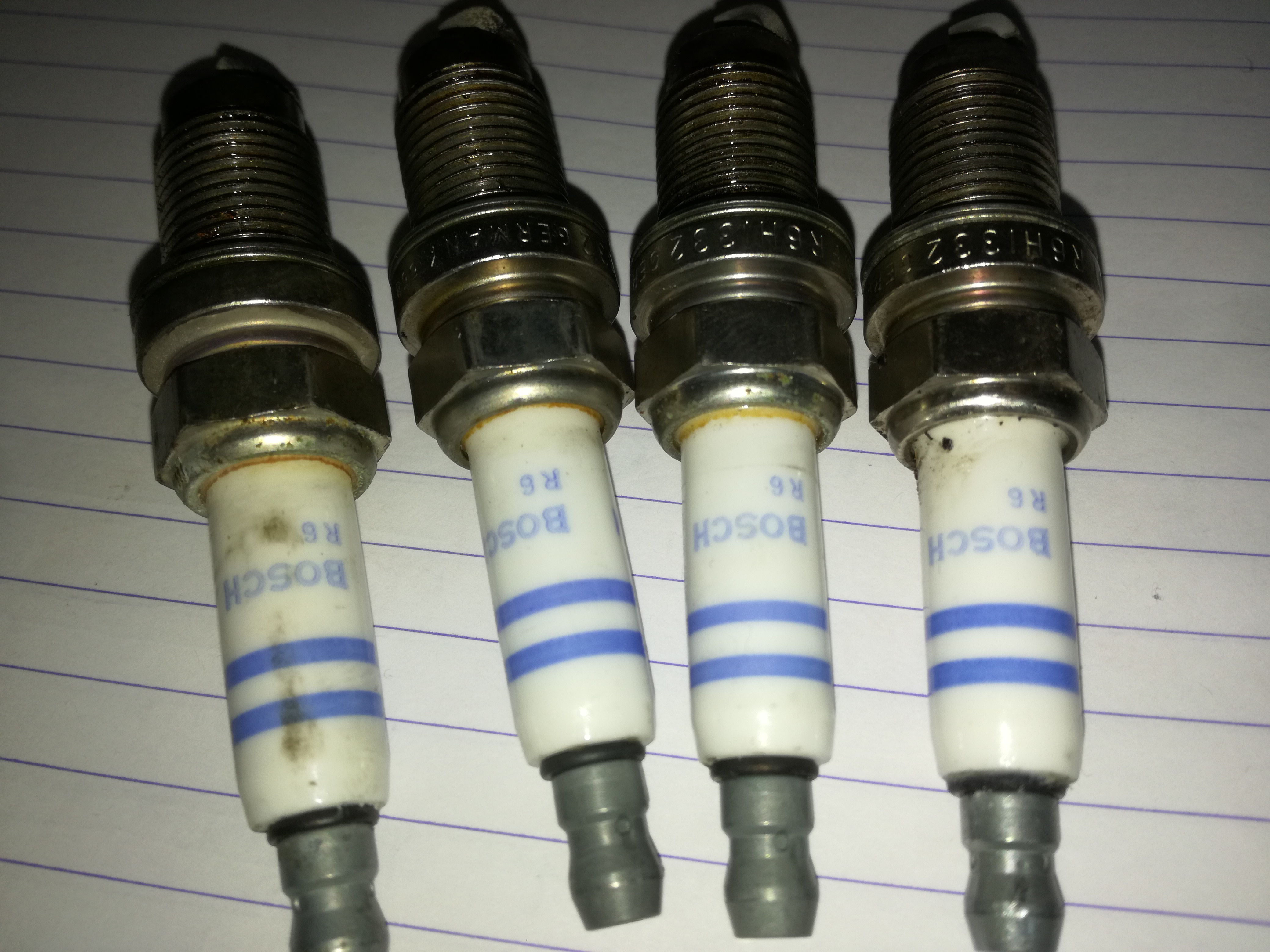

Change all the spark plugs, not one at a time!
If you can't test the leads for resistance, or don't understand, get someone who can.

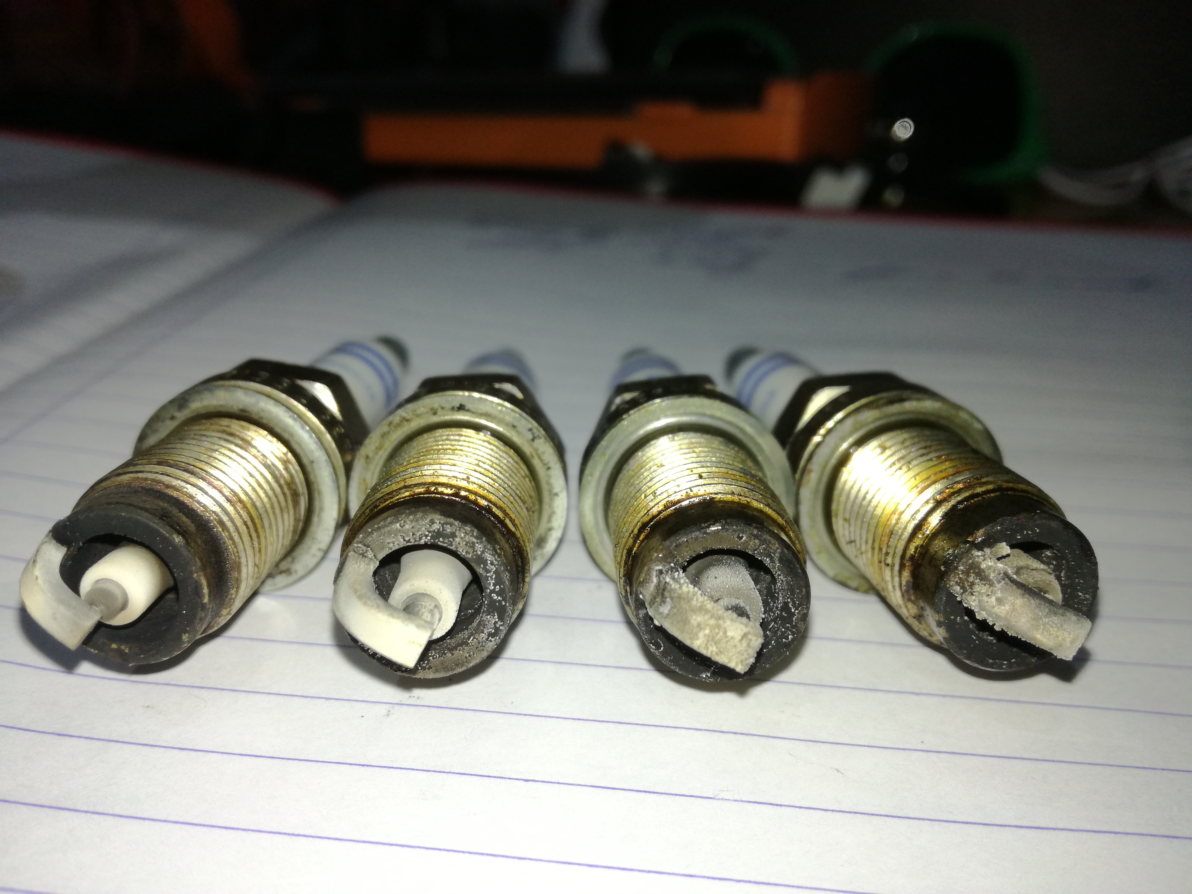

Hunting a little on a cold start is not something I would worry too much about. Cold starts the mixture is deliberately rich, and from the state of your plugs (1 and 2 in particular) I'm not surprised it misfires a little.
I also suspect whatever fuel you are buying is lower than 95 ron or has a high bio content, hence the white deposits,

http://www.ngksparkplugs.com/about-ngk/faqs/spark-plug-faqs/how-do-i-read-a-spark-plug
It would suggest that your car is starting to burn oil. Hence the oil on the threads and the condition of the plugs. How much oil does it use?
I would also check your fuel supplier. It may be contaminated or low octane fuel.

My car was burning some oil, one of the reasons i switched to 5w40, i'll look more into it and get a compression test when I can, thank you for your time.

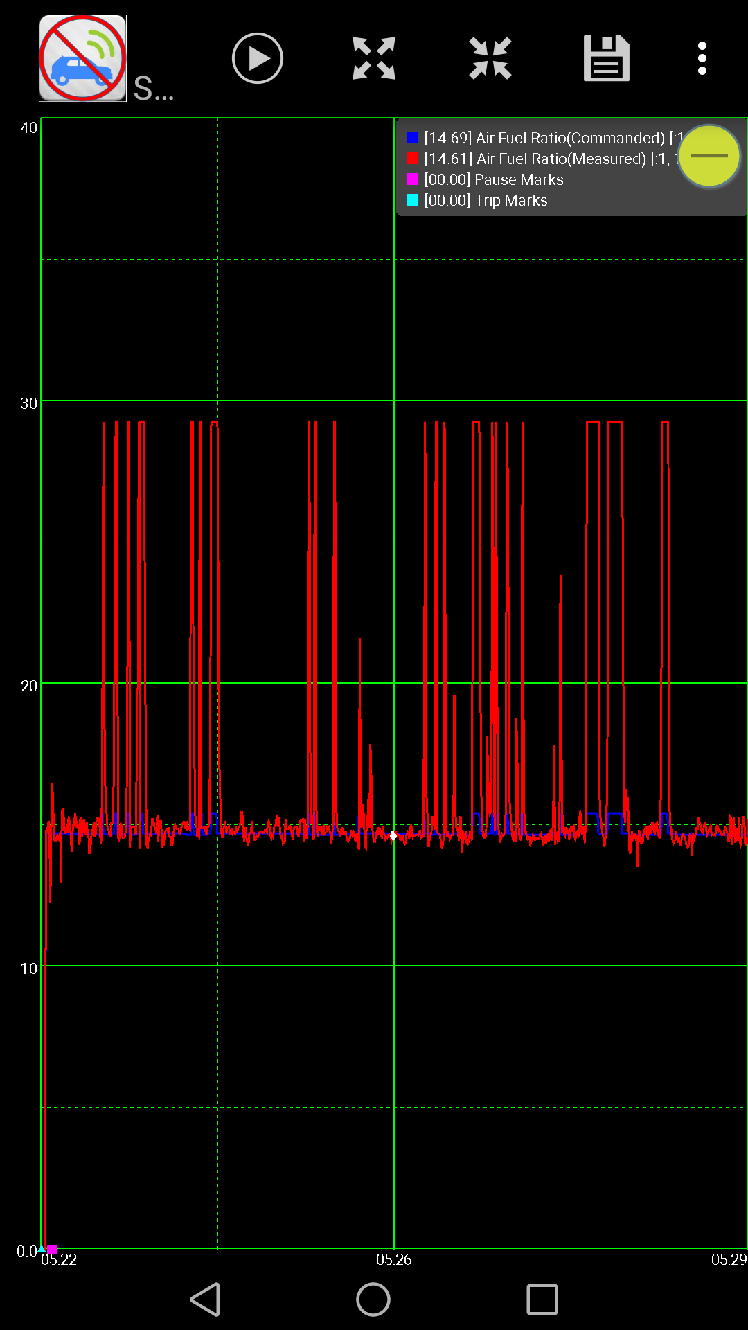

Hello, so I did a Air/Fuel ratio measurement with Torque app for about 10 minutes, from what I got I think I'm not running lean, although this test could mean nothing.
The spikes are from when I shift dont know if its supposed to be like that, I believe the A/F ratio should be around 15:1 ?
