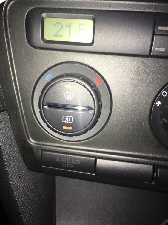

Well recently tried the actual button to clear it and it's pretty quick, bear in mind my aircon does not work at all on my climate control, been like that for a couple of years now.
The top button which although I wish was heated front screen like my Superb actually does clear the screen reasonably quickly, I used to just direct the air to the screen with the other button, next to the passenger temperature which shows a screen too . IMG_2473.thumb.JPG.57a3c2729b3fcd8c87b0a2ba9d2942f2.JPG
Correction it's the button top right next to recirc I usually use.
Left car for 1 hour and on return front screen and rear screen misted again. I do have pingi bags maybe need a recharge too.
