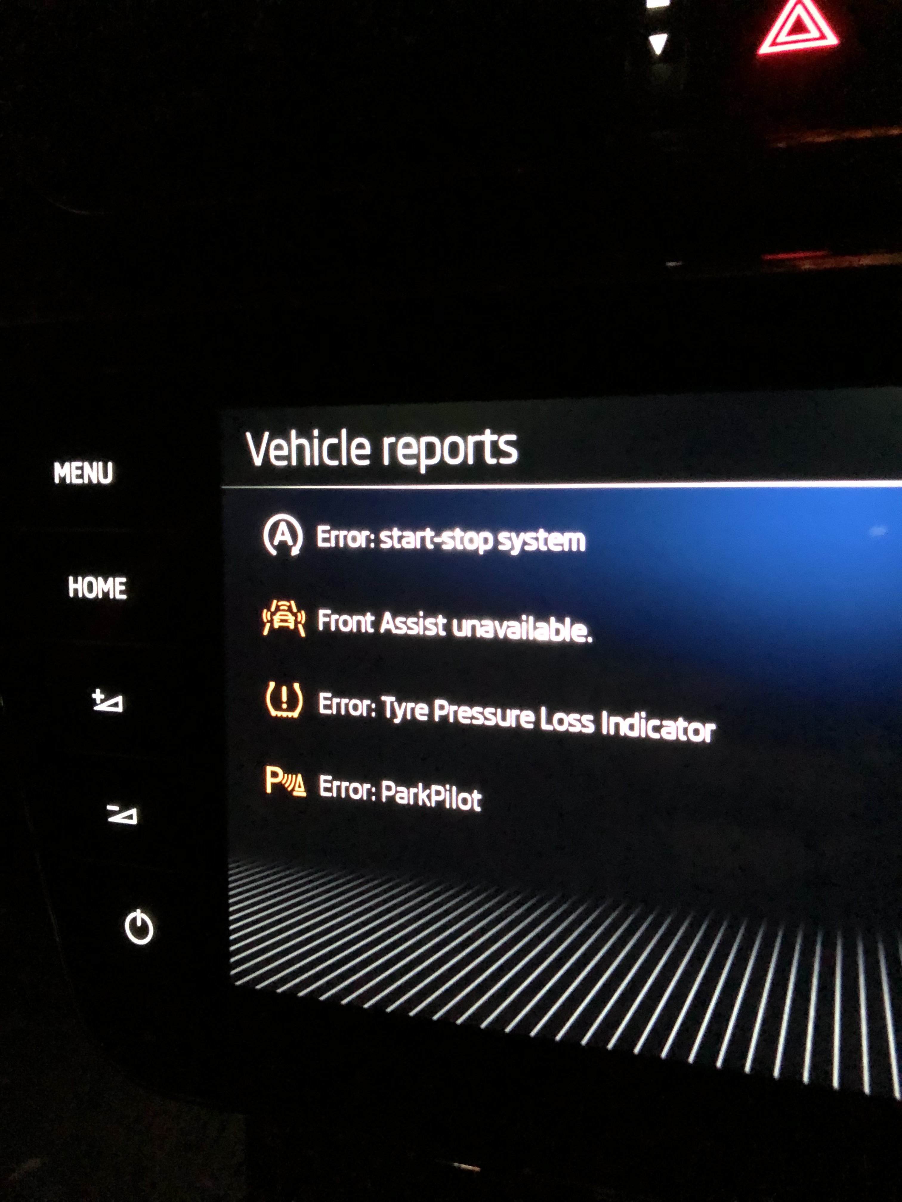

I removed the the bumper to change the headlight bulb. One of of those jobs you wish you hadn’t started but I had pulled one of the bulbs out and to get in behind the lamp housing and it’s just easier to remove the bumper.
I now have 3 errors so I suspect that I’ve pulled out a wire or knocked something on the ACC.
Can anyone confirm my suspicions? Has anyone had to also remove their bumper?!
Any help greatly appreciated.

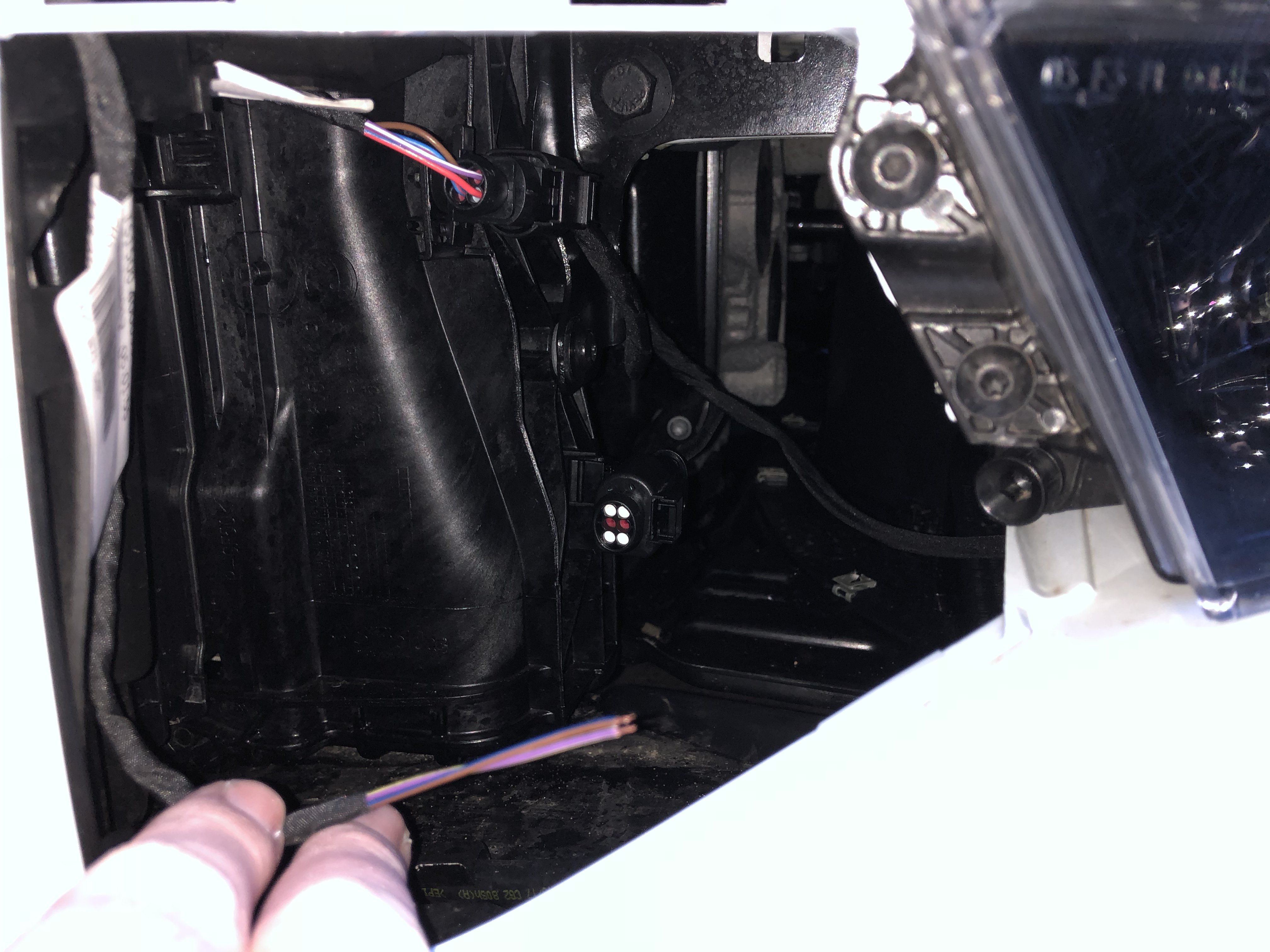

  • Me thinks I found the problem.    Not snapped, just the wires pulled out of the plug.    Will have to try and tackle that later.    Hownindidnt notice that yesterday, alt

I’ve not got front parking sensors which the park assist error is confusing me.
Also the tyre sensors?!
If it´s the headlight bulbs (xenon) you´ve replaced, it´s easier just to remove the front wheel and the inner wheel arches ;)
Did you remove the grille as well?`The Front Assist / ACC radar is behind that, and if anything has been disconnected it will throw an error. You might just need to get the errors reset.

That list of errors looks very similar to the list I had with the errant mouse problem. I'm not suggesting you have the same, but it would lend weight to your theory of a critical wire (or bundle) having been disturbed. I had all the same errors, but didn't have a start-stop error. I also had an emission control light on, and a missing ambient temperature figure, as this wire had been chewed. All were towards the front of the vehicle, underneath the tray and sound-deadening material - not sure where they terminated, other than the one for the front radar.
Nope, pre battery disconnect those same errors were there.
Tried to reset tyre indicators when stationary and wouldnt wouldn’t let me.
I never realised this would cause so much hassle, won’t be changing bulbs again!

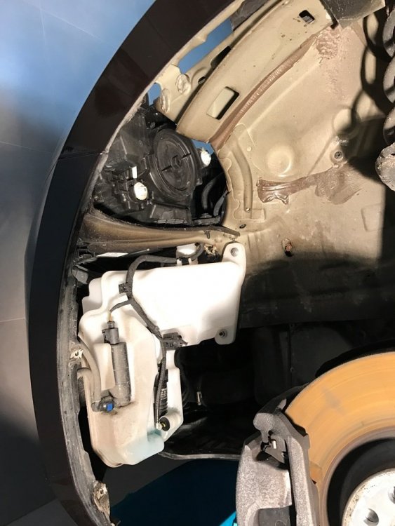

Yep - details here:
I have a video from Mitchell Cheshire Oaks if it's of any use , but shows the damage under the tray, not the bumper.
That would be helpful thanks. Whilst the tray underneath wasn’t removed, I was pulling at it in the wheel arch to get to two T30’s to hold the bumper on to the wing in an awful space.
I was also running out out of light so sort of rushing, sons iPhone light come in handy!
Edited by aldouk
No problem - I did check with the Service Manager at the time that he didn't mind me posting this if it was of any use to anyone:
https://video.citnow.com/vxJ8K9-sbtf
Just re-watched - they are right at the front and some are for the lights....
Little buggers, thank you for sharing.
Gives me an idea where to start. If I’m lucky I might be able to peek through the removable panel by the fog light. Failing that I can put up on the ramps and take the tray off.
There is no access hatch; you need to remove the whole wheel arch. It doesn´t take long to do.

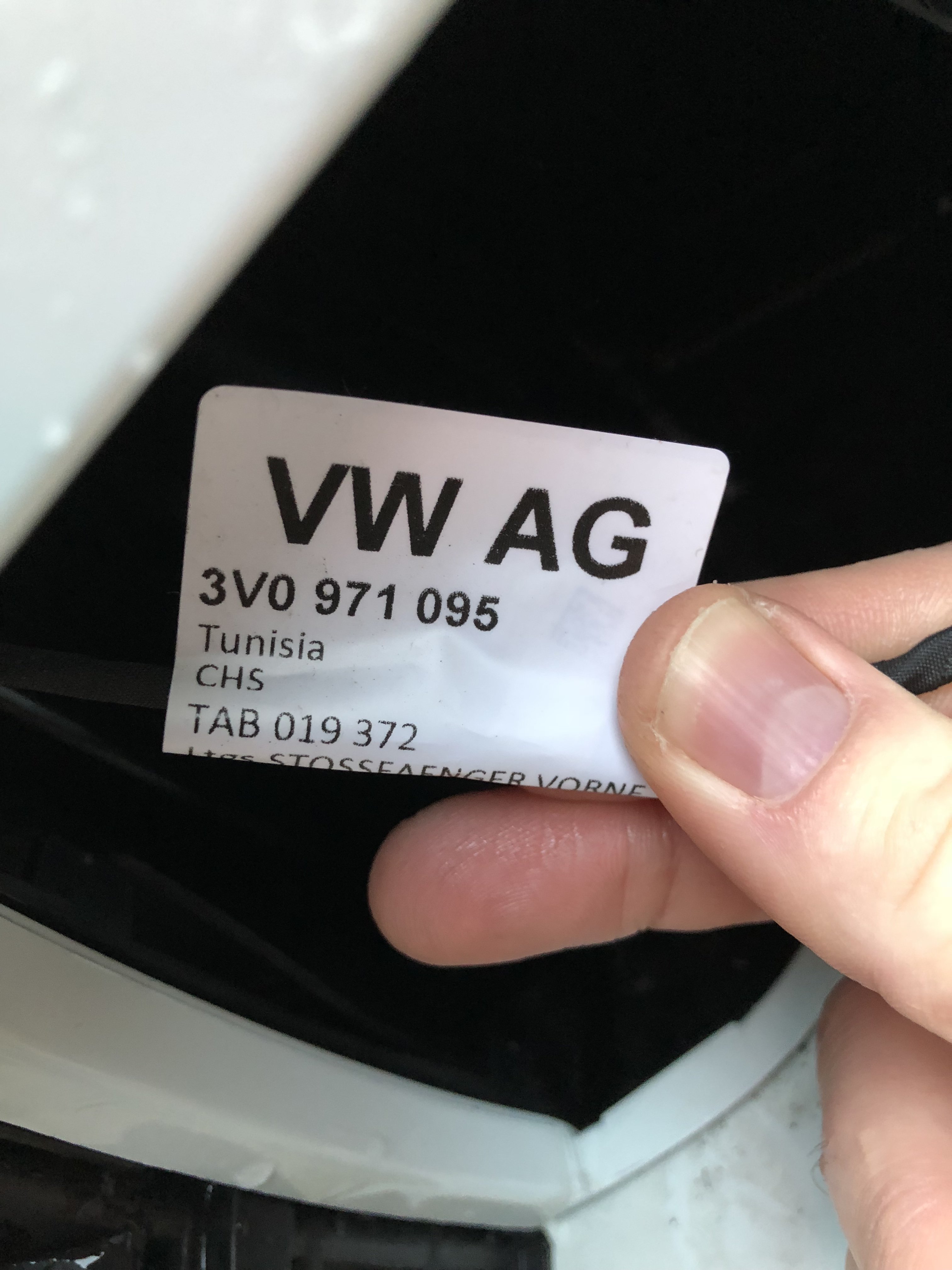

Hownindidnt notice that yesterday, although I had lost light at the end.

Ok cheers, bumper off job in end.
£14 for a new loom.

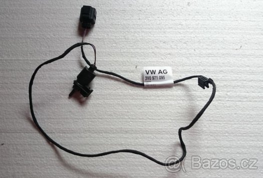

1 hour ago, xman said:
Very poor quality crimping. Wires pulling out shouldn't happen. I'd be surprised if its 14 pounds for a new loom, looks pretty complex.
http://nemigaparts.com/de/cat_spares/etka/skoda/sup/851/971010/
The wires only thin but it is the correct part.
