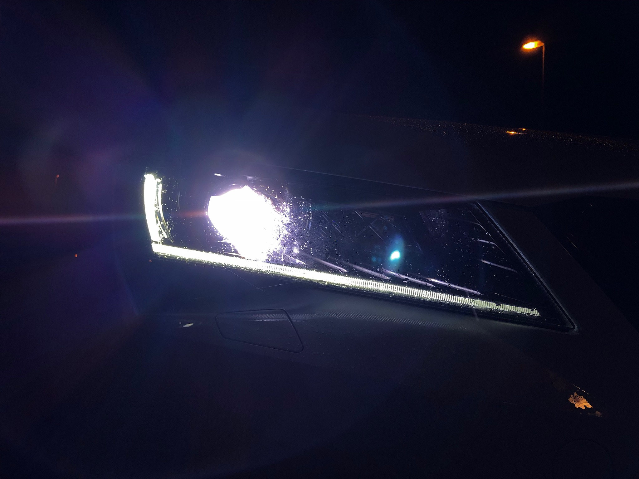

Depending on power it can alter the colour appearance of a supposedly rated bulb, e.g. a 6000k bulb ran at 55w will appear closer to a 5000k bulb ran at 35w.
Hard to photograph But this is best I can do, you can see the haze is bluey.
Certainly not a warmer light light like they used to be.
I need to to do a good run with them in but so far I like them.
GonetoBeemer has summed it up in terms of colours.
What are they like on a wet road?

Faults are gone now than goodness.
So are the 8k bulbs too.
You’ve gone back to the OEM bulbs and it cleared the remaining faults?
 No the new wire and my VCDS cable cleared the faults.
I just changed my mind on the bulbs and whipped the OEM ones back in whilst the bumper was off again!
Wont be doing that job again that’s for sure!
Maybe you would had been better fitting LEDs?
Edited by Gizmo
TBH I was thinking that 8000k bulbs don't sound like they'd be Osram or Philips and subsequently "how long will those bulbs last?".  It would have no doubt been soul destroying to have a bulb out warning in a few months only to have to repeat the whole process!
Glad to hear you got this sorted though :thumbup:
