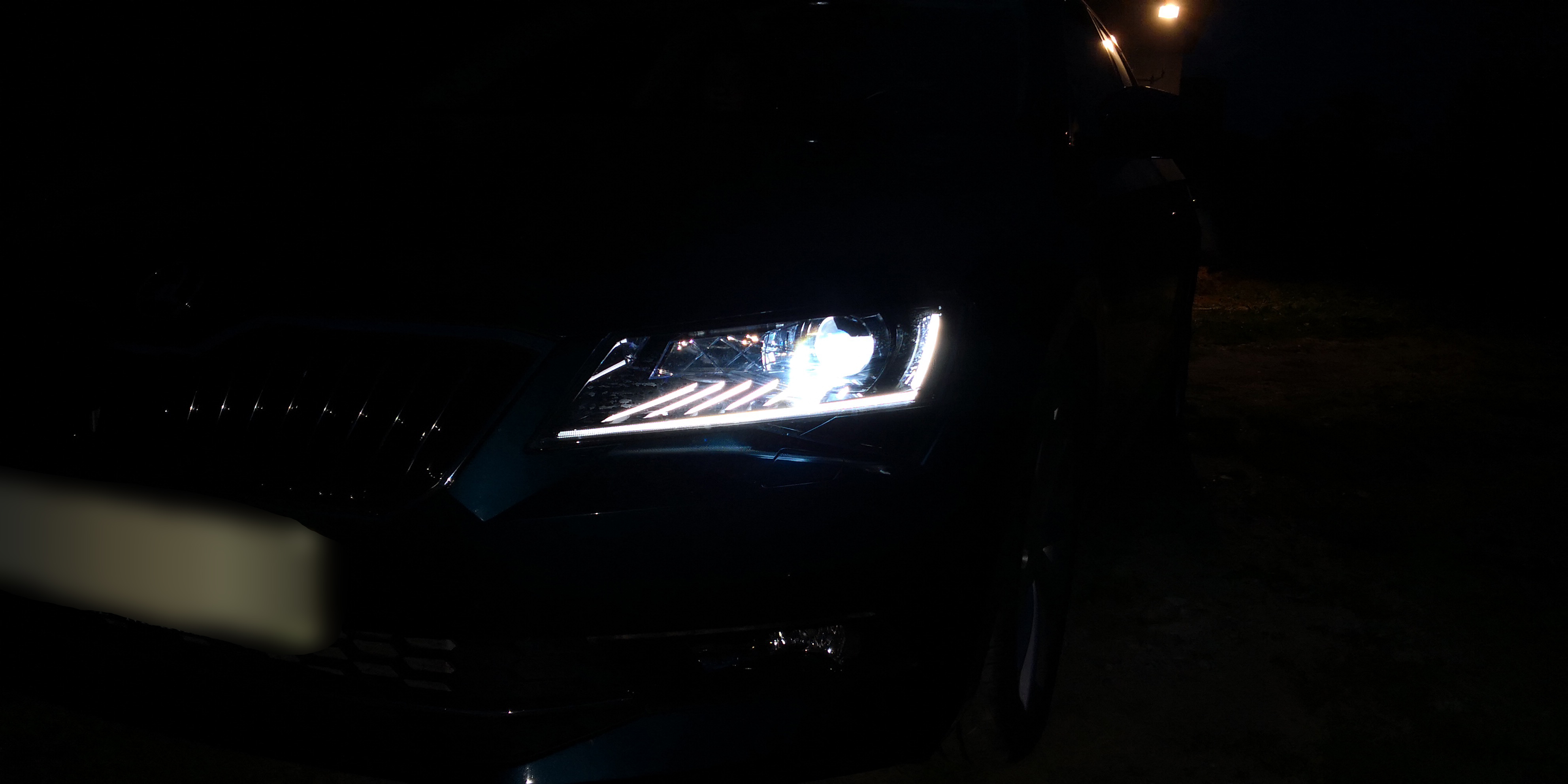

TBH I was thinking that 8000k bulbs don't sound like they'd be Osram or Philips and subsequently "how long will those bulbs last?".  It would have no doubt been soul destroying to have a bulb out warning in a few months only to have to repeat the whole process!
Yep these were low to mid range, doing more research they were boxed up more premium brand like which was misleading.
I had had same thoughts when that bumper was off! The Osram I know obviously are more tried and tested.
I swapped to Osram cool blue intense and they are much improved over the standard fitment bulbs. They’ve also become better over time; I thought ‘burn in’ was a myth..
Yes I was strongly tempted with them but read they are quite white.
The itch has been scratched now anyway, albeit a very combersone experience.

I replaced mine with 16€ Chinese 6000K. The quality doesn't seem bad, the bulb it self, color is great except the light output it self is not as strong as OEM Osram. I was hoping for at least same as OEM. So I have to change, again...
