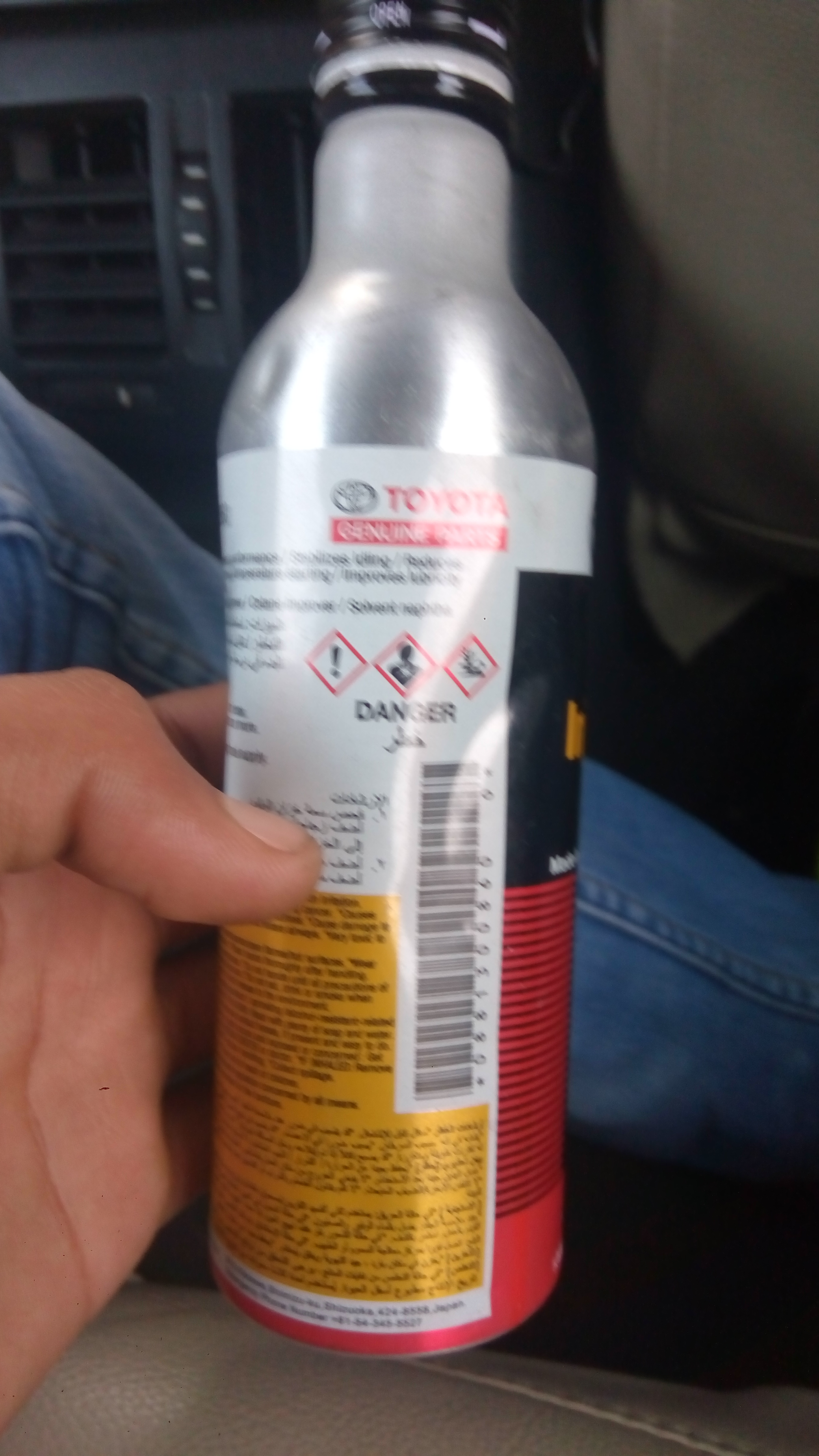

There is any reason?    Does full bottle of injector cleaner cause any problem on not much fuel?
I don't hhink the injector cleaner will cause any problems other than perhaps a bit more smoke.
