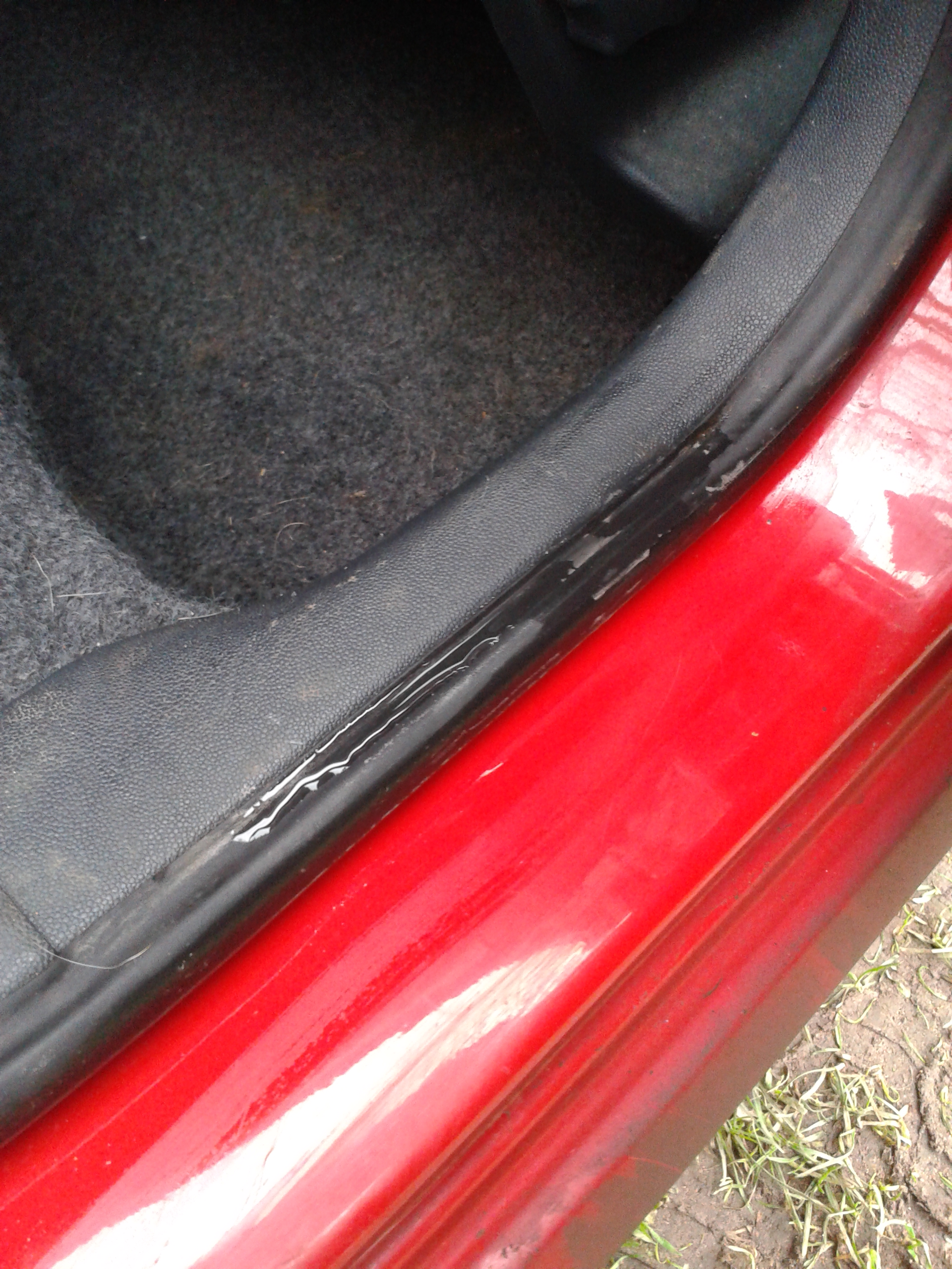

After overnight rain, check all four doors looking for little puddles on the horizontal part of the door seal at the bottom of the opening.
If anything at all is found there, that door carrier is still leaking.
as on the picture shown above, that is what I have found in my fabia vrs mk1.

also is it common to have leaking front doors, it seems to be the same problem as on the rear doors. small water puddles on the front lower door seal.
any ideas?

Front doors do also suffer leakage, not quite as often as the rears, but worth doing all four doors once you're working on the job.
Cleaning (with something like isopropyl alcohol) the surfaces that you are about to seal is quite important, and once everything is clean and de-greased, be quite generous with sealant quantity.

but sealing up the doors where the original sealant was... what is your opinion, can I just seal around the door panel as shown on the video above, or should I take it all apart and glue it back together?
does this also mean water stacks up in the door or does the water go into the draining holes instead as supposed?
Just seal around it. No need to take the metal panel off. The water will go out of the drain holes in the bottom of the door as intended.
