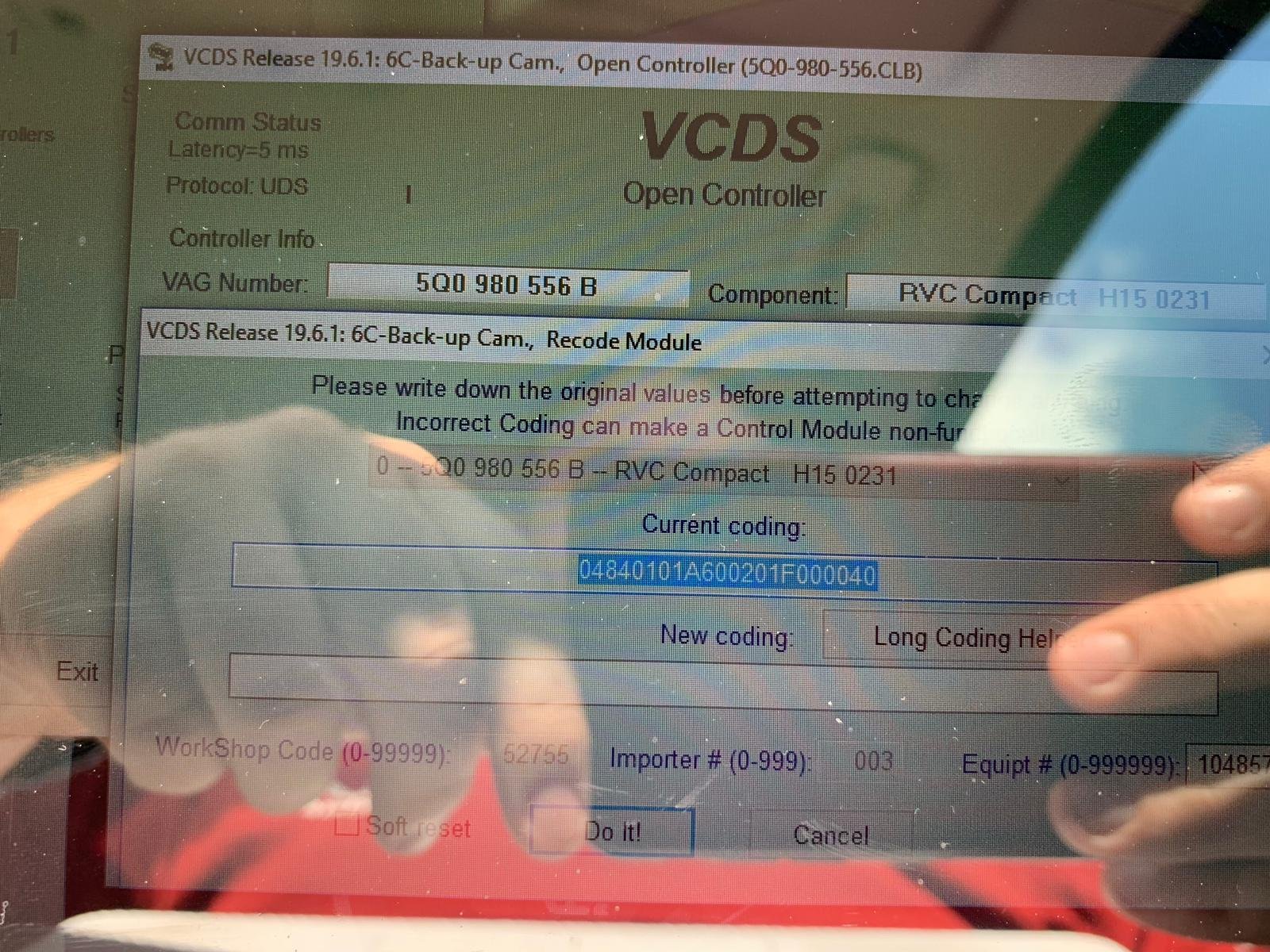

in the end I called Skoda (Ashford Kent) and they were actually very helpful. Coding and calibration done for £108 inc. VAT. I was happy with that. The guy said the coding I did was correct but it doesn’t always work and he had to go about it a more long winded way. No idea what he meant but I can’t knock them. They fitted it in next day too, so happy customer here. Doing the install myself was great from a learning perspective. If I had to do it again I would do it in half the time. If anyone needs advice feel free to ask.

Just looked at the long coding with VCDS that Skoda did after I couldn’t get ‘carsystems’ recommended coding to work. My car is MY17, hopefully someone will find this useful.

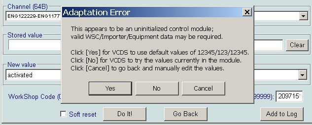

So I finally decided to have a go at this and bought the cam from the link above. It all fitted nicely, but when trying the coding from the guide (below) it’s not working:
https://www.cars-equipment.com/base/files/shop-attachments/6495308/44280.-kodovanie-6C-Highline-cam.pdf
I can enter most of the coding, but when attempting the last 6C (Manual tr.) edit I cannot even get into the module. VCDS attempts connection several times then exits the module window. I now see people referring to alternative coding for the Lowline setup which I would need for my Bolero unit, but can’t find the actual coding.
I’m now getting two errors:
5F-Information Electr. -- Status: Malfunction 0010
6C-Back-up Cam. -- Status: Cannot be reached 0100
Also, when I change the “Car_Function_List_BAP_Gen2-VPS_0x0B” I get an Adaptation error (image below) and tried both “Yes” and “No” and both appear to activate it though. Tried with and without adding the “Security code: 20103” before going into Adaptation.
Any help would be greatly appreciated. I’m now wondering if a faulty camera or leaving the Can wire connections disconnected could cause the issue.

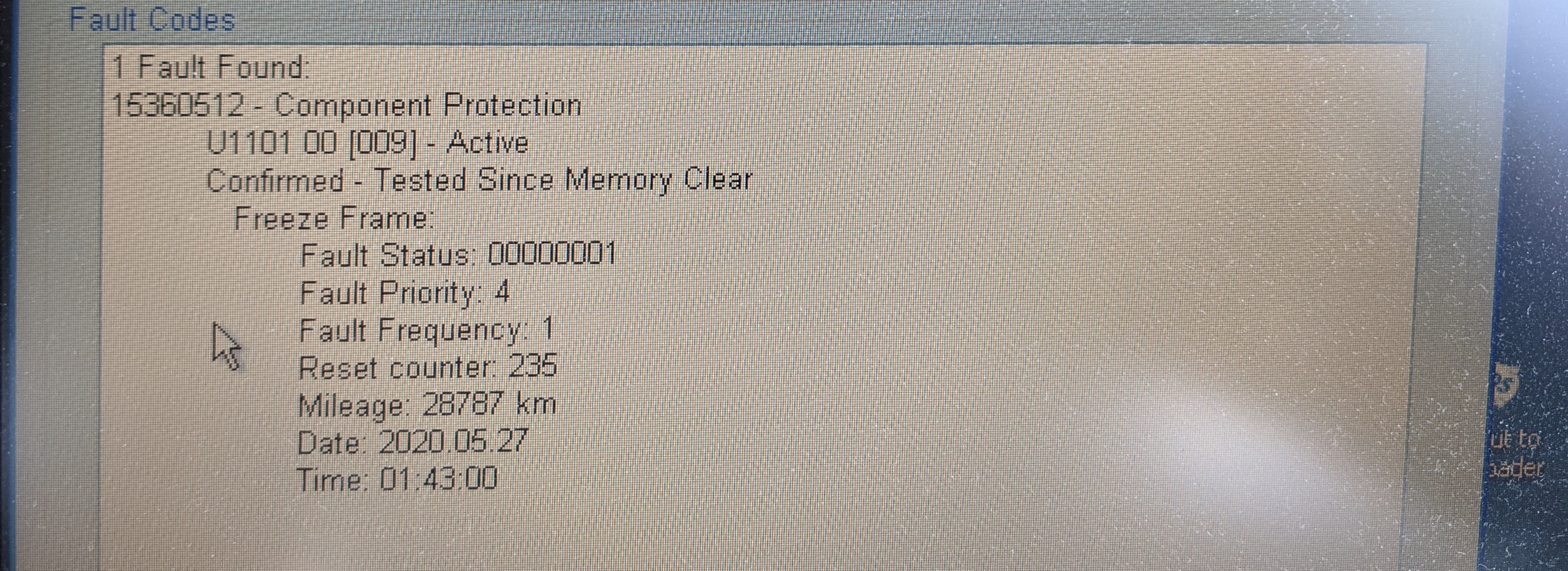

Ok seems to be a component protection issue. Looks like I will need an online odis service. Is there anyone on this site who does this??
