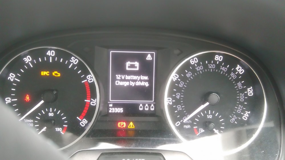

A few days without using the Fabia (2015 1.2TSI), well maybe a week or so, and I get this message just after turning the key.
The warning doesn't return after a few short runs, but it needs a few longer journeys before start/stop does it's stuff again.
Edited by johnh510

The Fabia in my picture above - "charge by driving" - resumed stop/start after a couple of journeys about 40 minutes each the same morning.
That being said the Fabia is a bit over two years old, so the AGM(?) battery is presumably still OK.
Edited by johnh510
