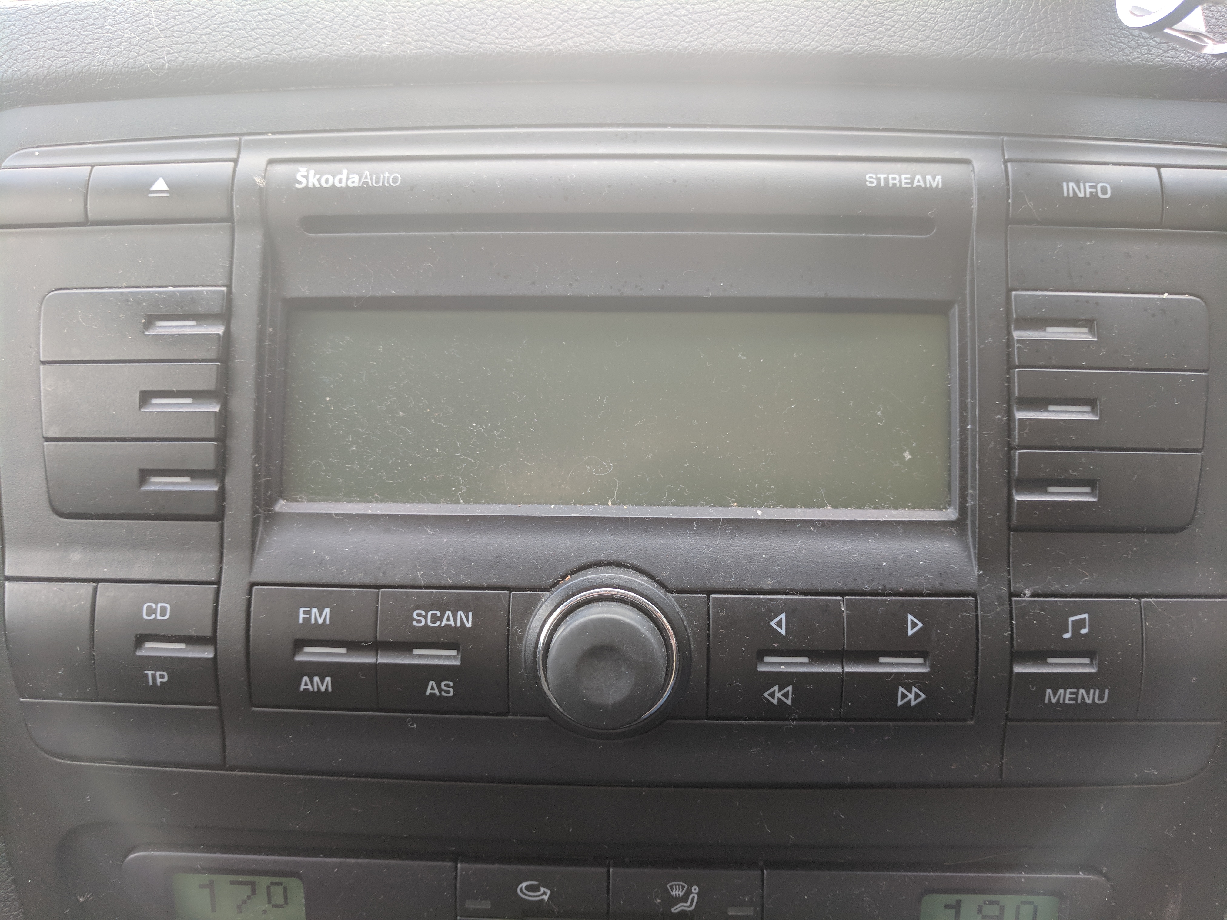

I'm looking to replace my factory head unit (pictures attached) with a DAB option and I'm a little confused and need some help please.
I know I will require (at the very least) a DAB aerial, either internal or external, but will I need anything else?
What are my options?
Checking ebay I can see VW head units, such as the VW RCD 310 DAB+, various Android units, Skoda Drive Audio, etc etc.
Very confusing!
Thanks.

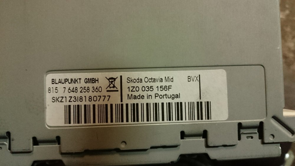

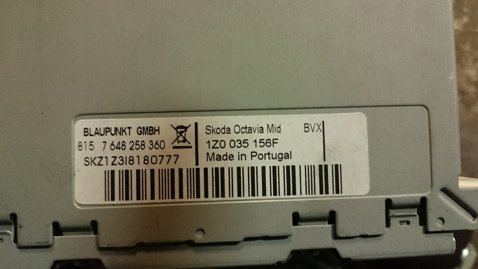

1Z0035156F don't have DAB :)
Seriously? Thanks!
The lister says it does, the scamp!

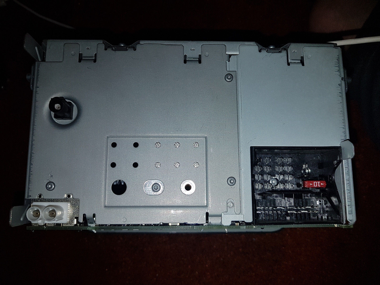

Here's the back of a RCD310 that is supposed to have DAB. Which is the fakra connector? Is it the one on the upper left hand side?

Which one is the fakra connection?
For the RCD310 picture you posted, the black and white connectors are both Fakra, the big block in the bottom right is known as a quadlock.
Fakra connectors tend to be colour coded for different functions in Skoda and other VAG vehicles, for example:
- White, AM/FM
- Black, DAB
- Blue, GPS
- Purple, GSM

If you fitted the smaller 220/210/130mm headunit, you'd need a facia designed for the Amundsen/Amundsen+/Columbus. Based on your picture in your first post, it looks like you have a pre-fl with the least expensive (matt black) trim. Therefore, you'd probably need something like this, just double check the climate panel looks to match your existing one:
