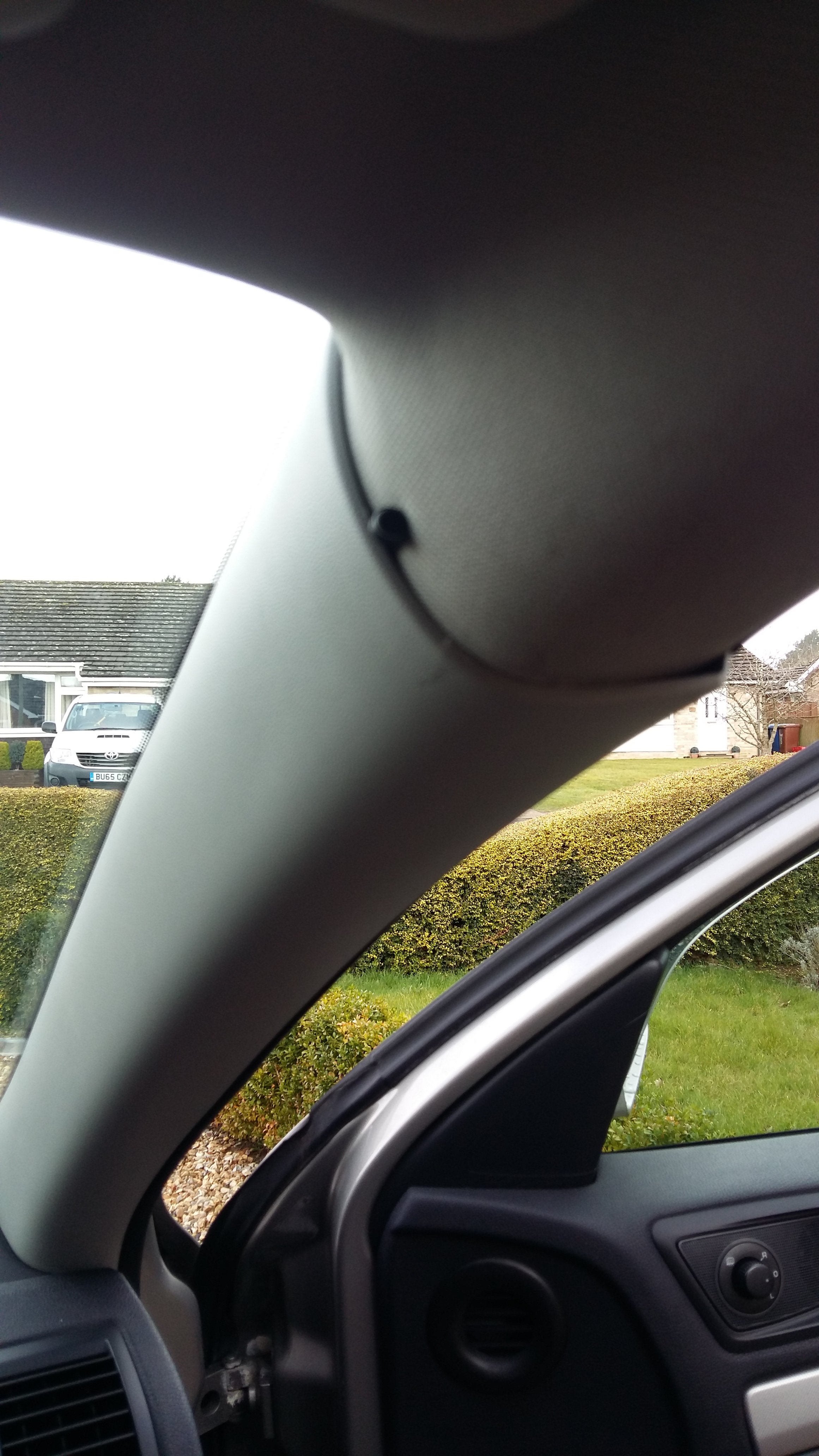

Where do people tend to mount the external microphone?
The only thing to do now is to fit the mic/DAB aerial/GPS and put the dash back together. Oh, and fix the aerial connector! :blush:
My mic is mounted at the top of the drivers A pillar, would have preferred near the mirror bur the cable is to short for that

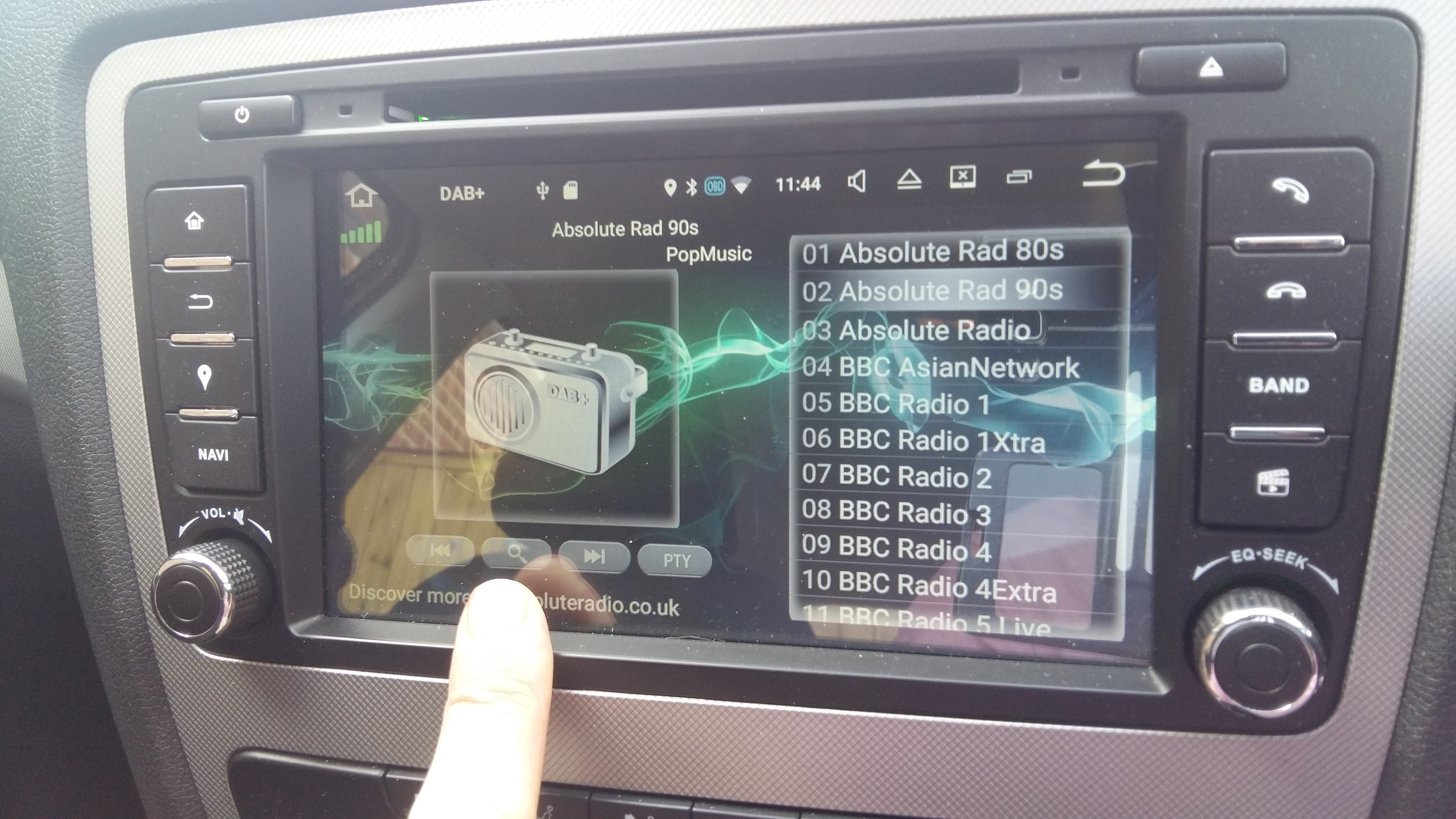

Anyone recommend a good DAB app, or worked out how to add new stations to the current one? I don't seem to have BBC Radio 5 Live, just BBC Radio 5 Live Extra.

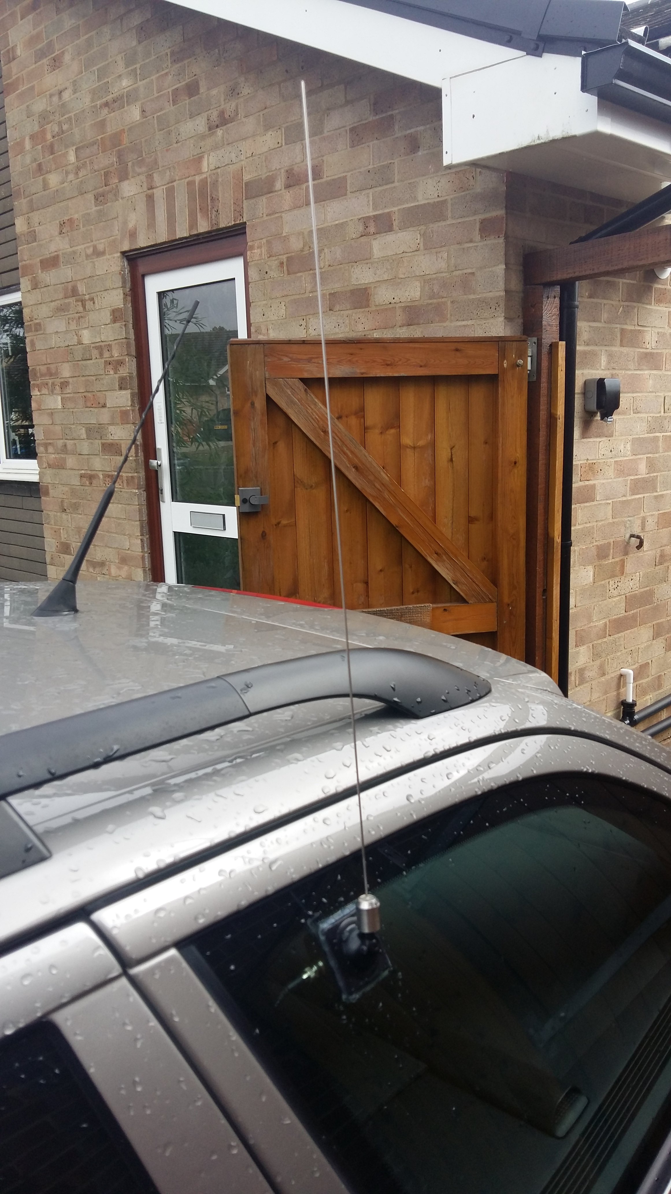

Get a better aerial, I used the screen mount supplied for a couple of weeks before changing it to an external glass mounted on,
http://www.dabonwheels.co.uk/Kinetic_DEGA-4001_glass_mount_DAB_car_aerial.html
The telescopic bit is a bit crap and you can no longer get it with a solid whip so I made my own, reception is very good with very few drop outs, haven't looked in to a different app but it wild be nice to have a favourite button.

So do you think the app auto detects stations and there's no Radio 5 because it can't find it?
No, you need to scan for them,
