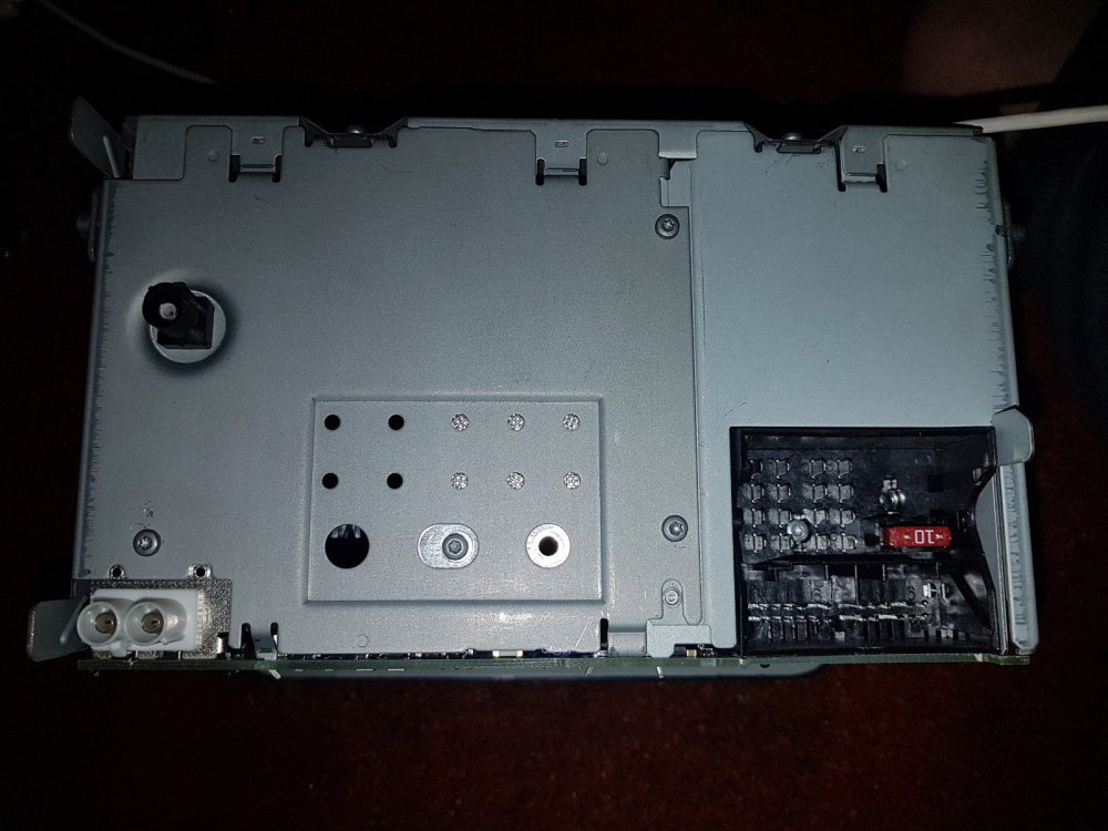

  • I think the only OEM options are the Amundsen+ (RNS-315) and the Columbus (RNS-510). Only some variants come with DAB so make sure there is a black fakra connector on the rear.   There is al
