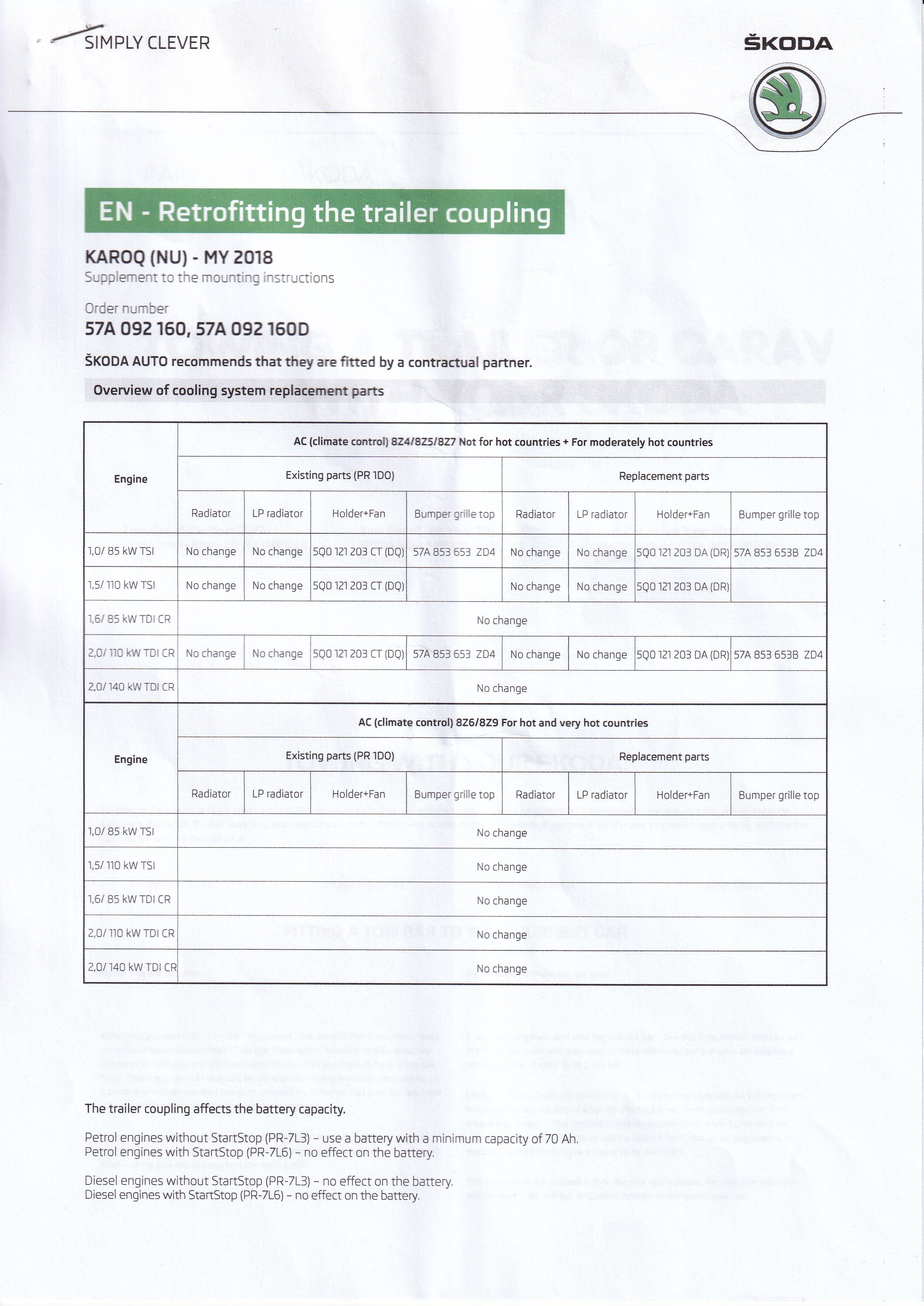

Take a quick look here, some useful information on what is actually different between cars that have the tow bar factory fitted and those that don't.
The 1.4 TSI isn't listed, but since the 1.5 TSI is very similar it can be fair to assume the changes apply, or applied to the 1.4 TSI...
1016106817_CooolingModDetails.jpg.dafbf0b940378f48e46e49ed2d346ea2.thumb.jpg.1751c85097303c040c8dfb6f3927123f.jpg
Regardless of engine, the only modifications are to the cooling fan (upgraded) and radiator grill (the opened slots / air intakes are larger).
As all Kodiaq's get Stop/Start the battery doesn't change either. See the notes at the bottom of the document attached above.
Part numbers for the fan and grill are included too, so you could try pricing them up. No doubt the front bumper and headlights have to come off to fit the new fan, but the modifications don't appear to be as extensive as previously discussed, which might raise questions on the price you've been quoted.
The main issue in the thread linked above is that the dealer was quoting for parts which weren't needed when approached for a quote to retrofit the tow bar.
