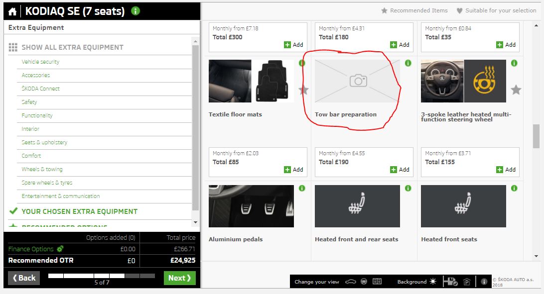

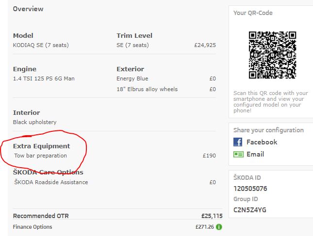

Also, another trick to try to strengthen your argument.
I've just checked and it is possible to add the 'Towbar Preparation' factory option to your model Kodiaq without the upgraded cooling system @ £190.
By offering this option then Skoda UK are essentially allowing customers to add an aftermarket towbar after delivery without the upgraded cooling system.
If you are speccing the 'Towbar Preparation' on a new build are Skoda UK warning customers that if you fit an aftermarket tow bar your warranty is void if you don't also upgrade the cooling system? If they are (as Winchester Skoda tried to do too late) then whats the point of the 'Towbar Preparation' option on affected cars?
What is 'Tow bar Preparation' though? Common wisdom would suggest that it is just pre-wiring and stuff ready for one to be fitted... but maybe it also means that an upgraded cooling system is also installed at the factory (same as if you get the factory fitted tow bar)?
I think that's exactly it, the wiring is routed from the front of the car through to where the tow bar electrics would be located, but its done in the factory.
However a lot of aftermarket tow bar fitters claim it isn't needed though, not sure why.
I remember my neighbour paid circa. £200 for the 'towbar prep' on his Octavia which as far as I'm aware didn't include any cooling component upgrades. His tow bar fitter didn't use it in the end.
Its all a bit confusing really.
Don't forget this cooling upgrade could well be just a slightly bigger radiator and fan which from the factory would cost very little extra but adding it in later means in effect you have paid for 2 radiators, 2 fans and all the associated labour that goes with it
