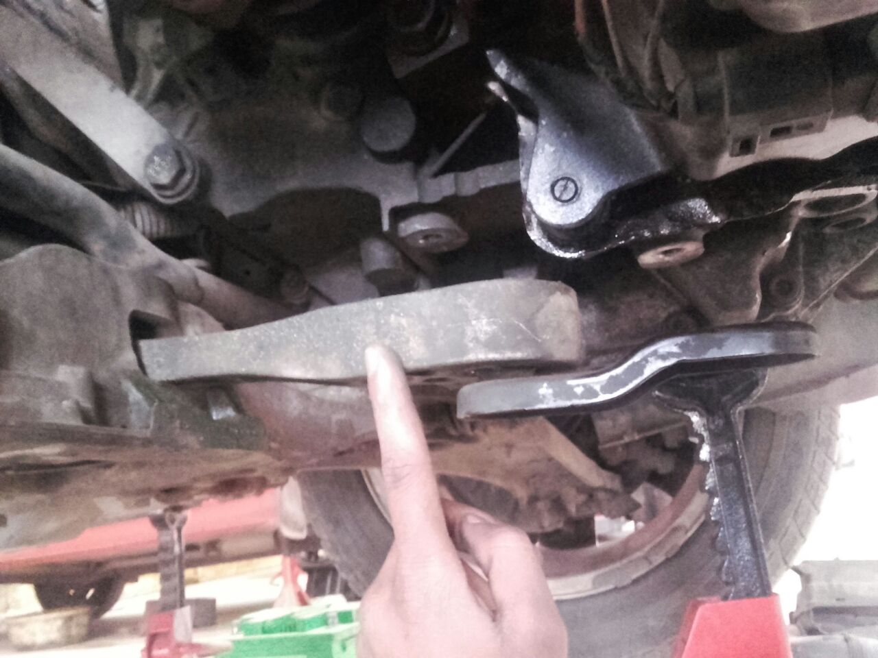

Hi,

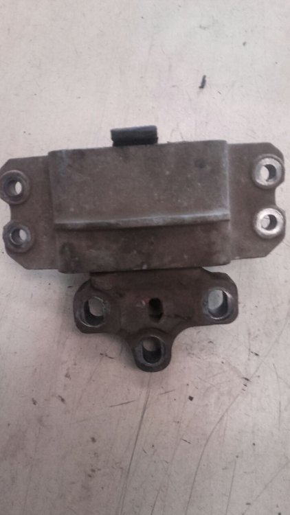

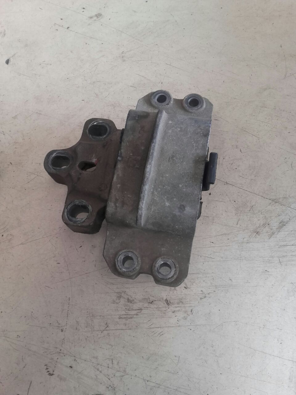

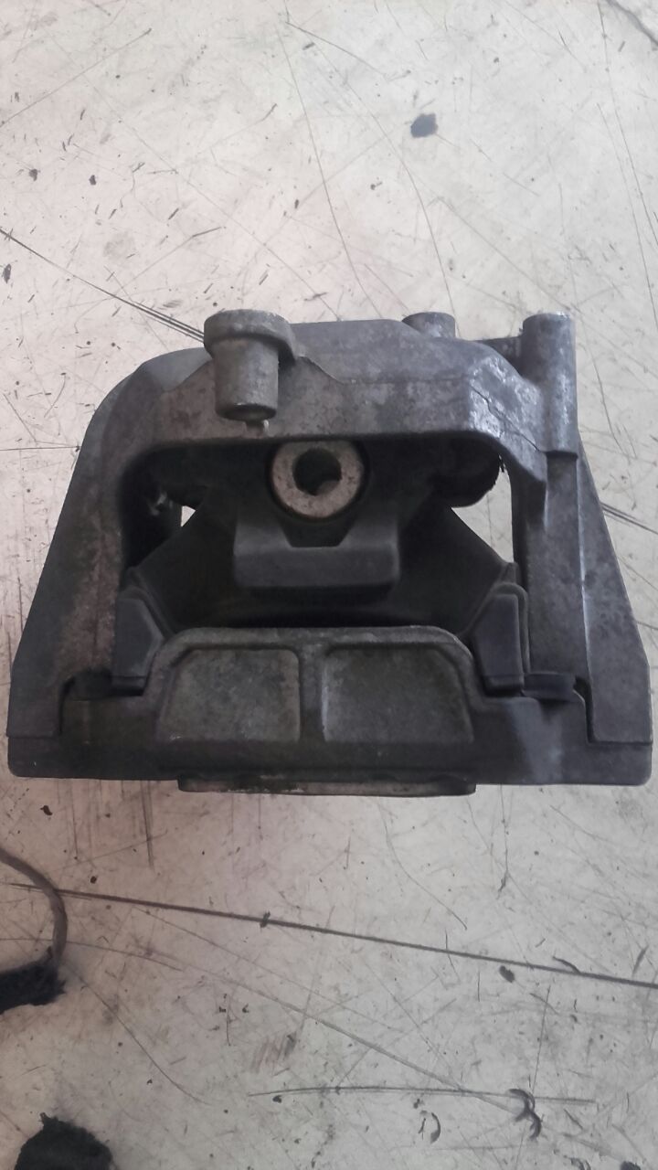

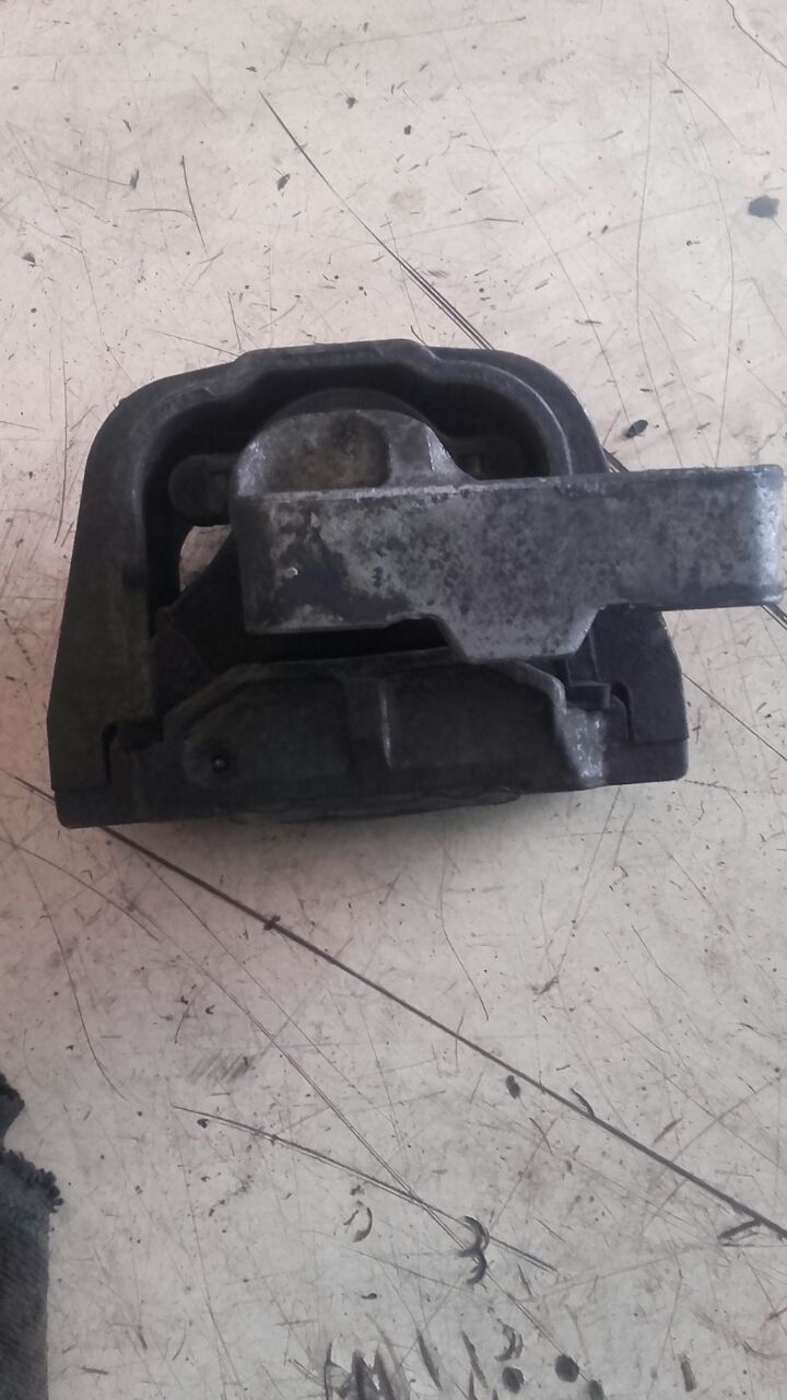

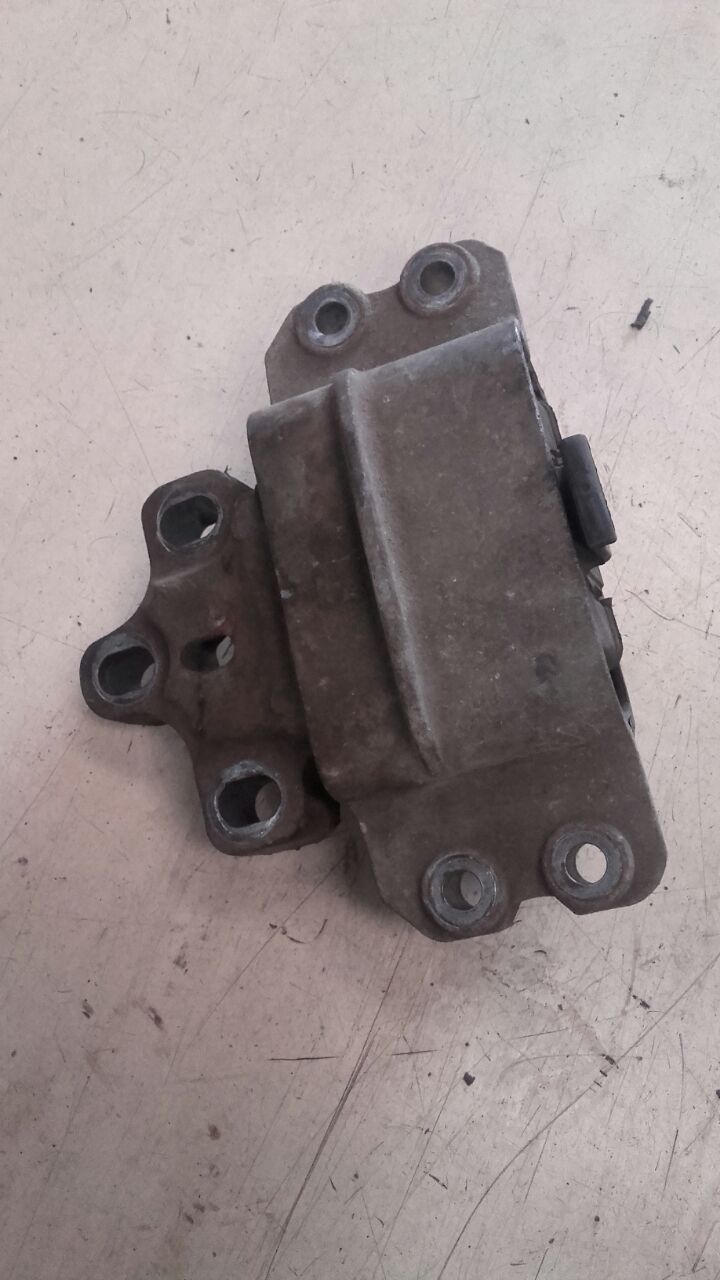

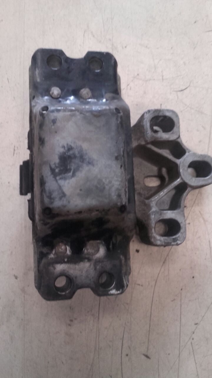

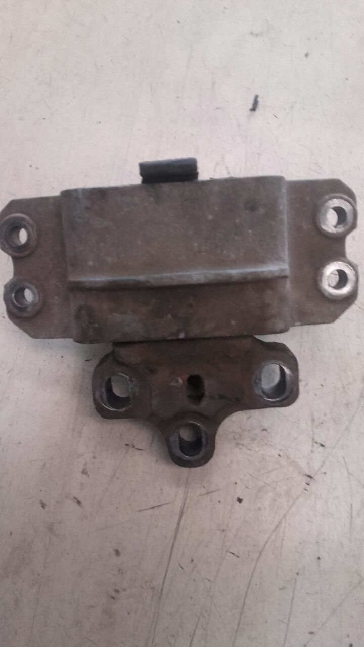

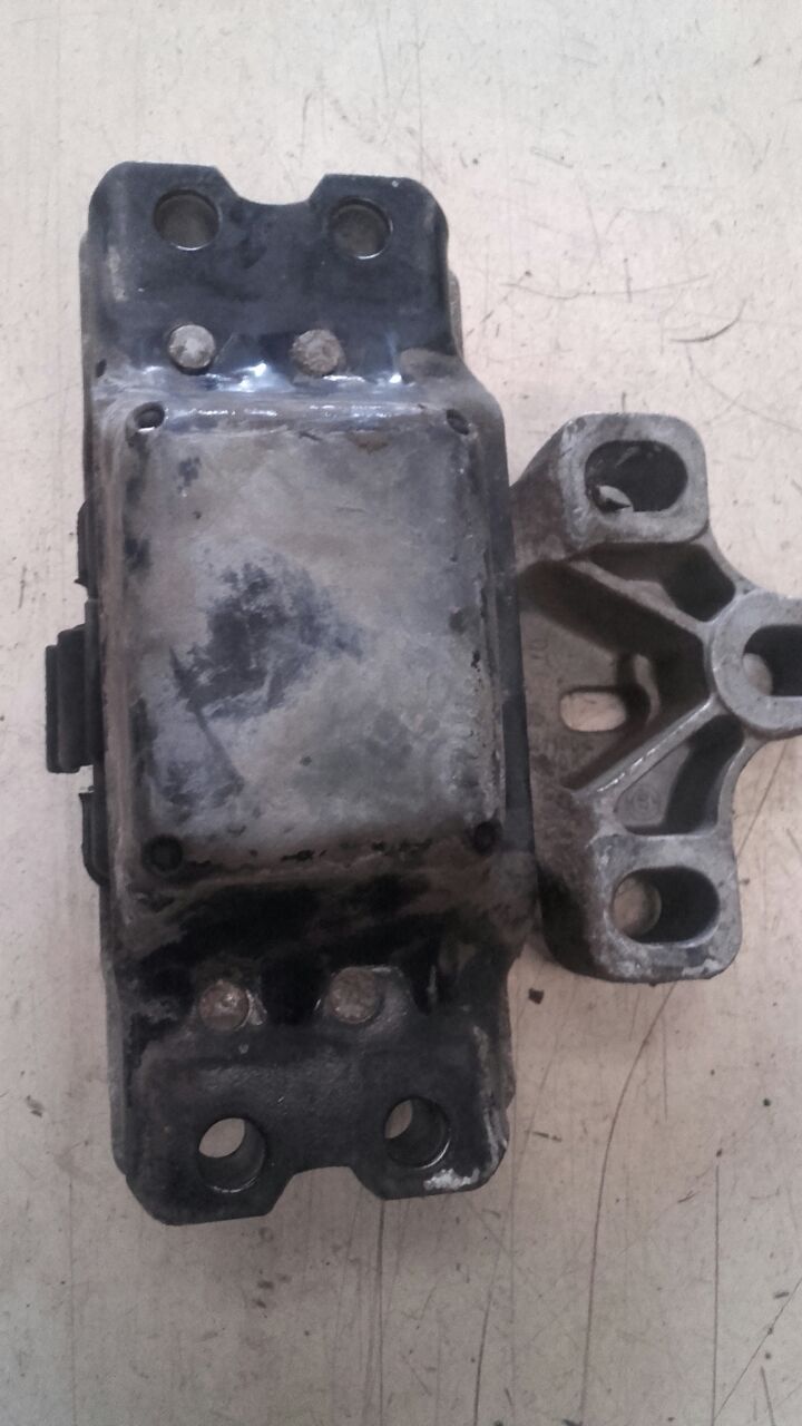

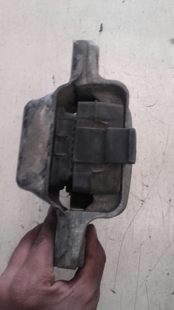

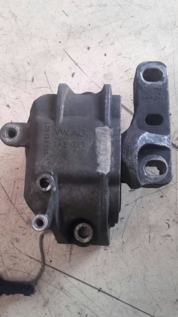

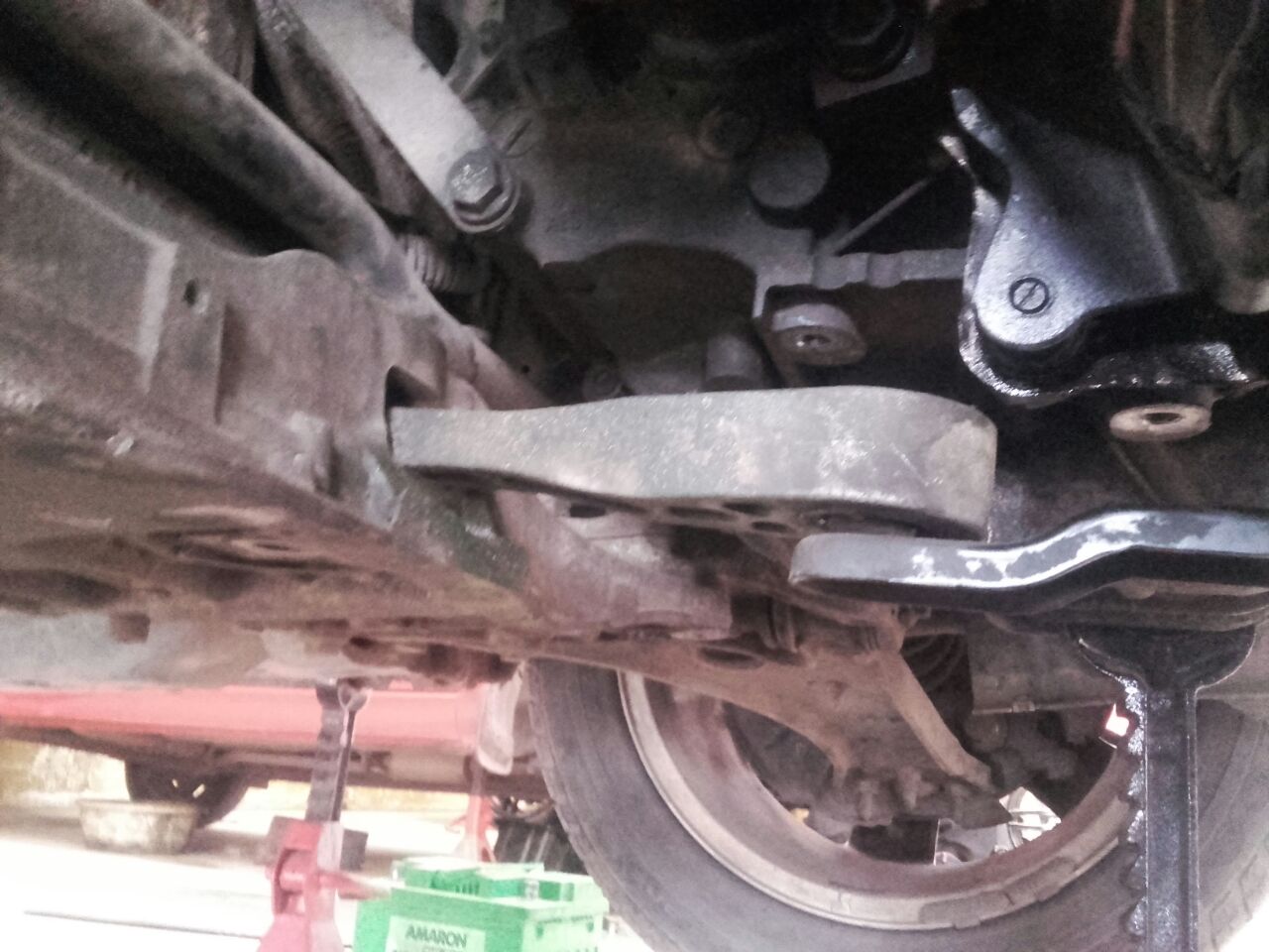

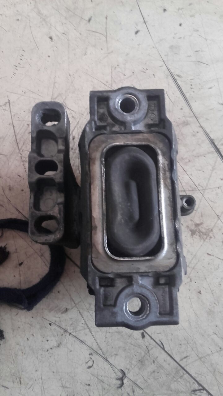

Got the photos of engine mounts from mechanic, are they bad mounts? Tagging @TheClient @KenONeill @HarleQuinn @Jaco2k and all users.
Heard from mechanic, the car is still making jerks.
So, mechanic called me up and told that car is having issue with Gearbox only. I am really going nuts as this may lead to huge repairs.
@pavan_h - The rubber doesn't look obviously rotted or torn, but the only real way to test engine and transmission mounts is by loading them manually in the car.
@KenONeill Mechanic called me up and said that he feels problem is from Gearbox. The car is out of warranty. I don't have that much money to put in for new gearbox - not sure what to do now.
Those are the top mounts - only way to tell if good or bad is to check for play.
The one that usually has more play on it is the lower engine mount, underneath at the center of the engine, AKA dogbone mount
@Jaco2k I will be going physically tomorrow to inspect the vehicle and check which mounts were replaced. Can a faulty dog bone mount cause the vehicle to jerk and hesitate in low RPMs?
Yes it can, but so can a lot of other things - usually you try the cheap fixes first and if that doesn't do it, move to the more expensive ones.
