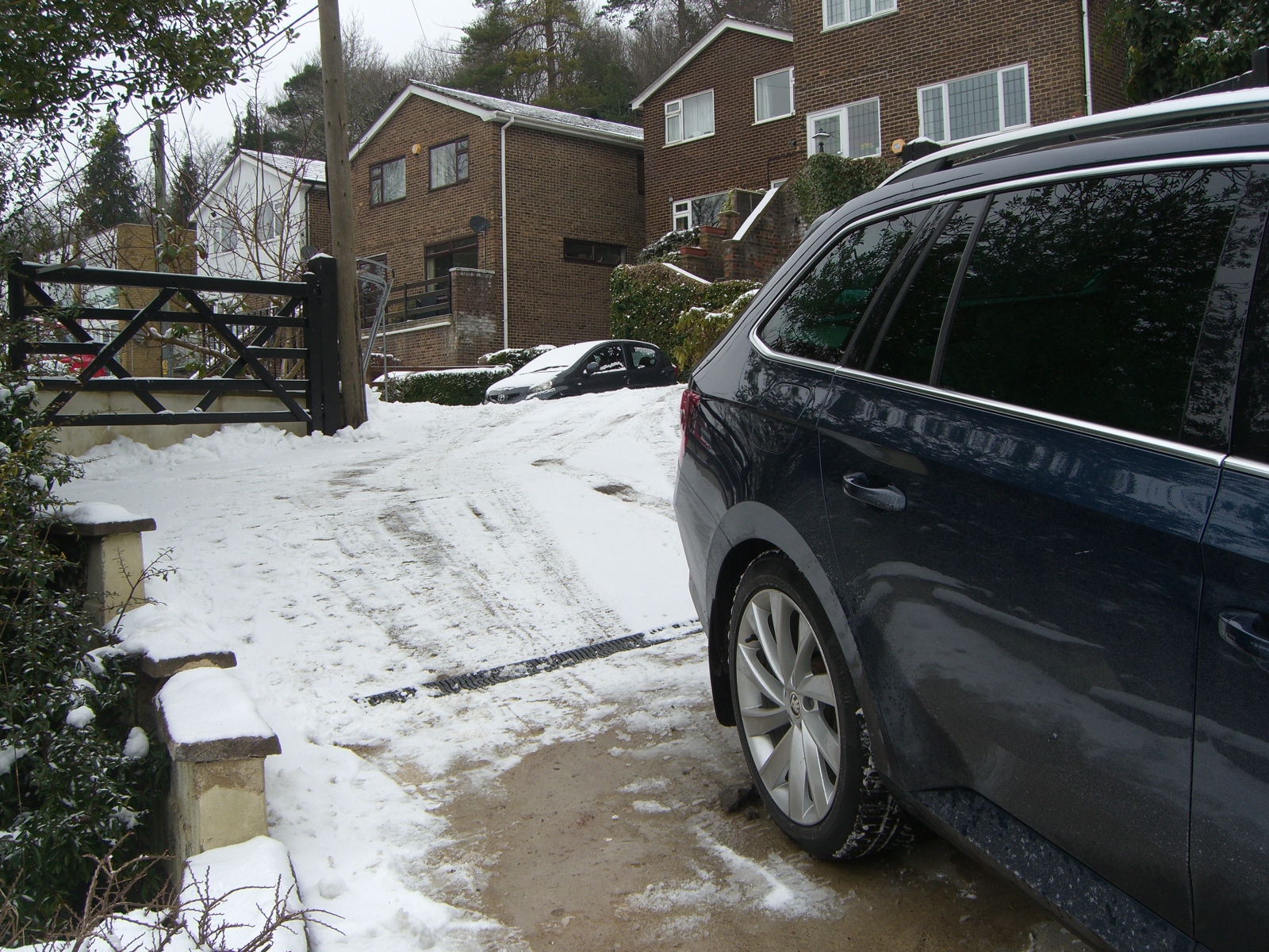

Living in Biggin Hill means having a really steep drive, previously when it has snowed I have either parked the car on the road or had to clear the drive of every last snowflake before I could get the car out.
Now with 4x4 and winter tyres I just drive in and out like the snow is not there, not a single bit of wheel spin even if I cut it sharp and take the steepest way!
No need to clear it at all as you can see from the picture.
Edited by philsmith
