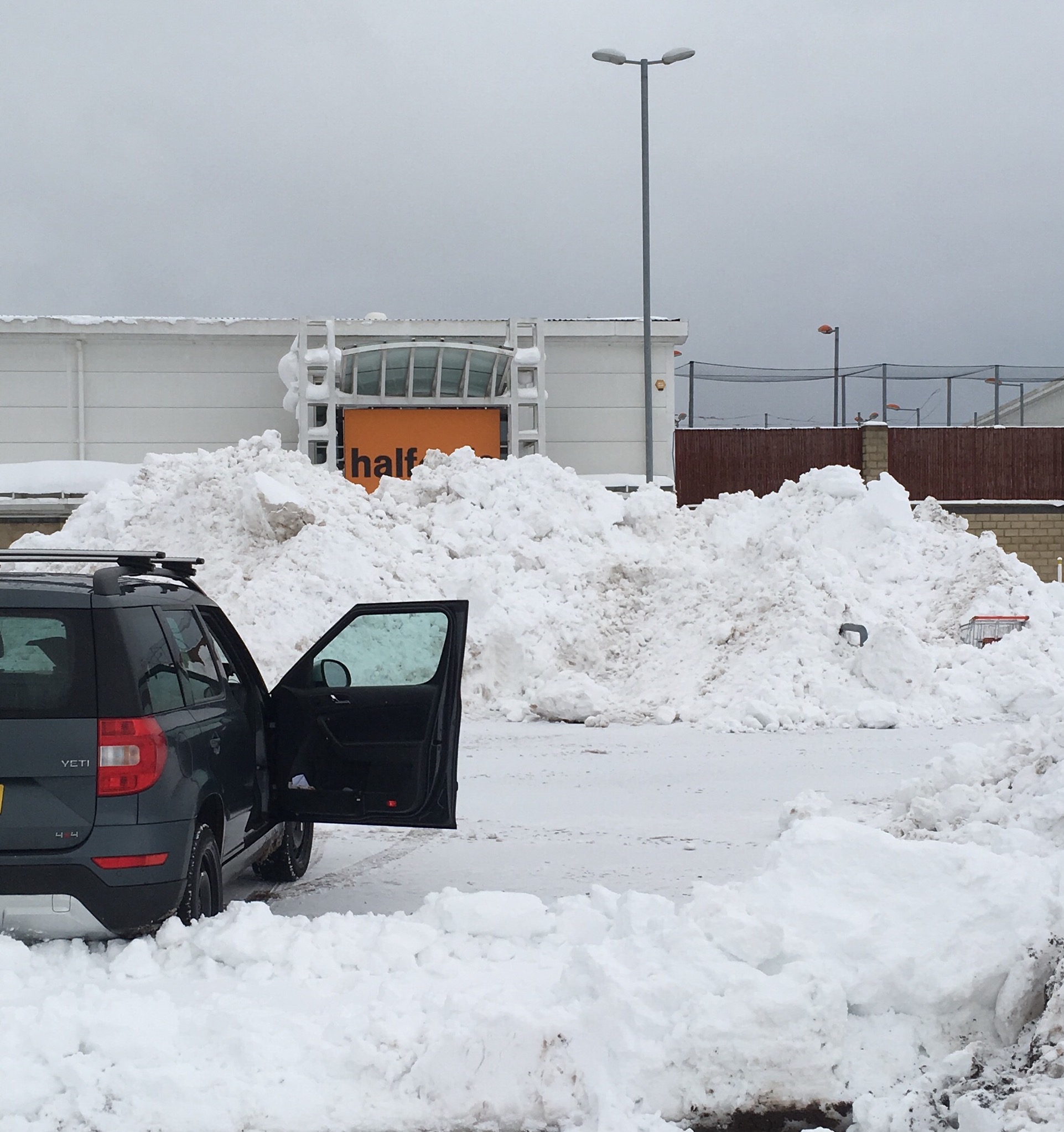

Mine has been faultless in the testing conditions we’ve had up here over the last few days. I had to take the road less travelled home from Cumbernauld to avoid getting stuck on the M80 on Wednesday and there were no dramas.
