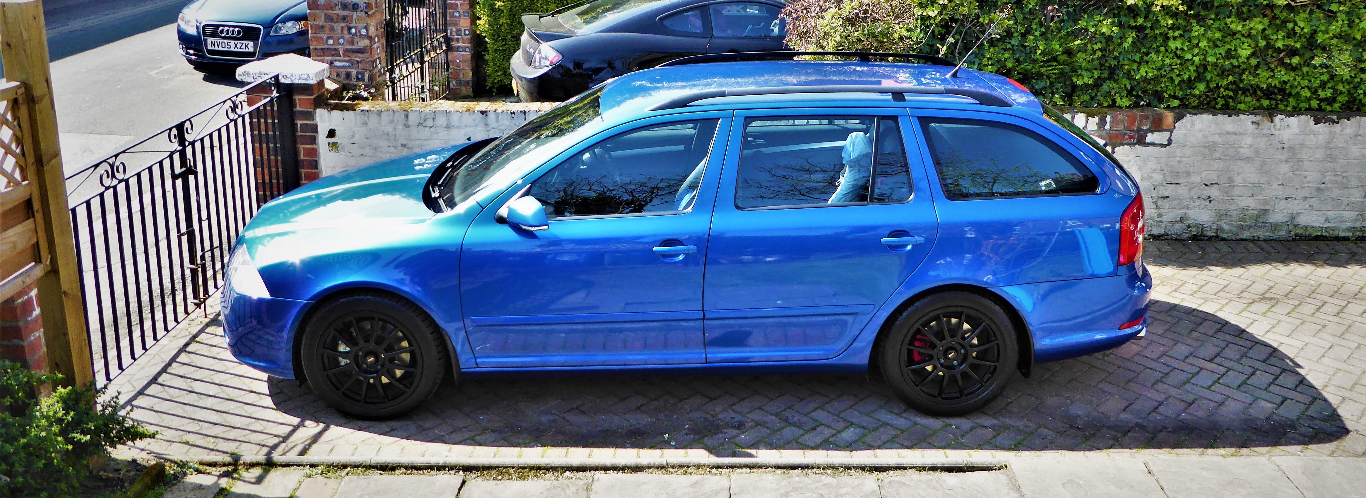

What did happen over your case in the end? Did you ever consult a dealer or an indie workshop? It would be fascinating to know the answers to some of my questions if you ever get back to this! I included a picture of my work car and you will see it is sitting quite low but not so much you would notice it and feel it was too much.
